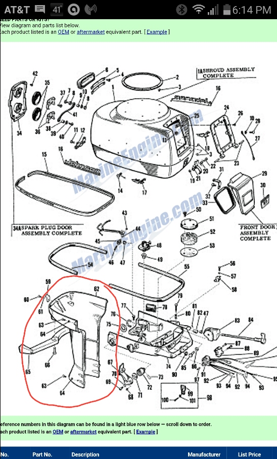

Is this lower shroud just decorative? Is it attached to anything internally? The engine housing is full of mouse debris and would be easier to clean out if I just take this shroud off.
Re:Lower shroud 35hp 10 years 10 months ago #118741
as long as the screws come out.. just pull it off and clean it out.. its just a cover..
Re:Lower shroud 35hp 10 years 10 months ago #118746
Thanks! Just wanted to make sure I wasn't overlooking something.

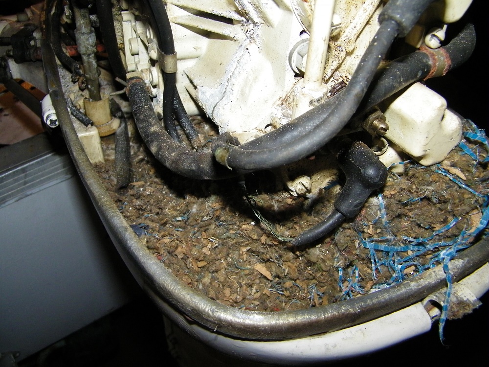

Re:Lower shroud 35hp 10 years 9 months ago #118928
Ya, those critters can be a problem...My old RDS-20. Had to remove the entire lower shroud, wire brush, prime and repaint. The stuff actually seems to stain the metal.
Re:Lower shroud 35hp 10 years 9 months ago #118964
The air intake in the underside of the pan is where the little bastards usually get in. I have found that jamming a tennis ball between the motor clamp and the bottom pan opening helps to keep them out.
