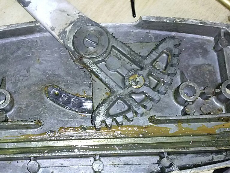

It's a hard plastic button with fairly stiff spring action behind it. Gear lever works fine, but the trottle lever works smoothly fir a few movements, the catches and requires a little extra force before it starts moving smoothly again. It also makes a dragging sound and I found a small piece of the plastic button in the housing. I'm wondering if it really needs a detent, the cable has some drag in the sheathing.
Here's a pic of the good lever, with detent in good order.
Re:Shipmaster control unit - detent ball 11 years 2 weeks ago #116367
Throttle lever and housing with detent notches.
Re:Shipmaster control unit - detent ball 11 years 2 weeks ago #116368
