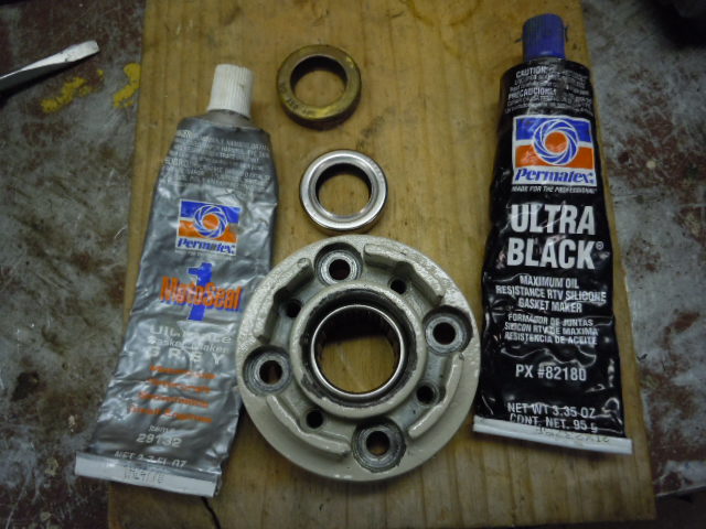

When I got back from the coast this summer, pulled the prop and discovered fishing line around my prop shaft.Checked the LU oil and sure enough was slightly milky. Got a new seal in from eBay today and need to know which sealant is right.

Jim, assuming this is on your old JohnRude V4, I usually use Permatex No. 3 aviation-type gasket dressing on the outside of the seal. Haven't had any fall out yet!
You should be able to pick up a small can with the brush-in-cap at your local NAPA.
If you happen to have some OMC "Sealer 1000" or its replacement "Type M" - (aka 3M #847) kicking around, that'll work fine as well.
As will Merc "Perfect Seal".
I would only use RTV as a last resort.
HTH..........ed

Ed,I was leaning more towards the moto seal, but I'll check on the no.3 . Heck,I still have a little 5200 left. I could rub a tiny bit around the outside of the seal just enough to seal it up.

Jim, I hadn't noticed the Motoseal label, I thought it was just another type of RTV.
I'm sure it would do a great job on the seal as well. Looks like this stuff is similar to Kawasaki-bond or Yama-bond.

Ed,thanks for your help.That motoseal is good stuff. I used it on my fuel tank fittings on my Aristocraft Nineteen. Works great in a gasoline enviroment.
