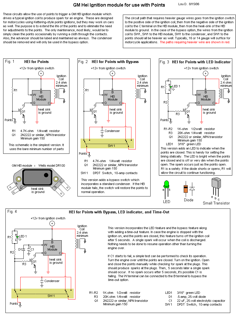

I use GM modules for all my small engine conversions. I just
did a six cylinder 90 hp mercury using two
loudgpz/GPZweb/Ignition/GPZheiModForPoints.html
