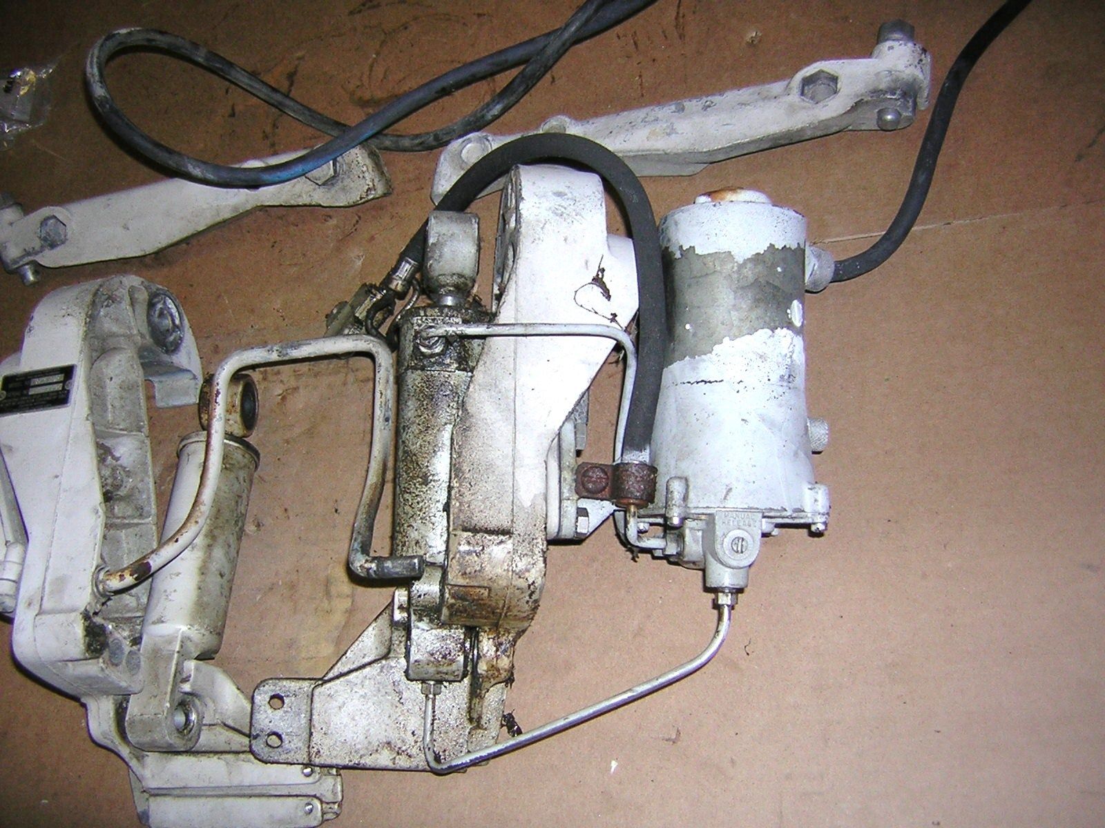

Cal, the power tilt on my 75hp v-4 originally came off a 71-72 120-135 hp ?? johnson( It's been a very longgg time ago). The only mod I had to do was where the lift cylinder at the bottom ,I had to trim where the cylinder base straddles the tilt adjustment pin bracket. I'm assuming your 100 has the same mounting bracket my 63 johnson does.The reason ,I later found out why I had to trim it was the later model lift cylinders had slightly beefier base mounts than the early model cylinders which is a good thing,I guess. Here's a pic of what the complete set up looks like for the 62-68 v-4s Oh yeah,I did away with the automatic lock release that came with the lift stuff cause the hydraulic hose was bad and I don't ever lock the motor down anyway.

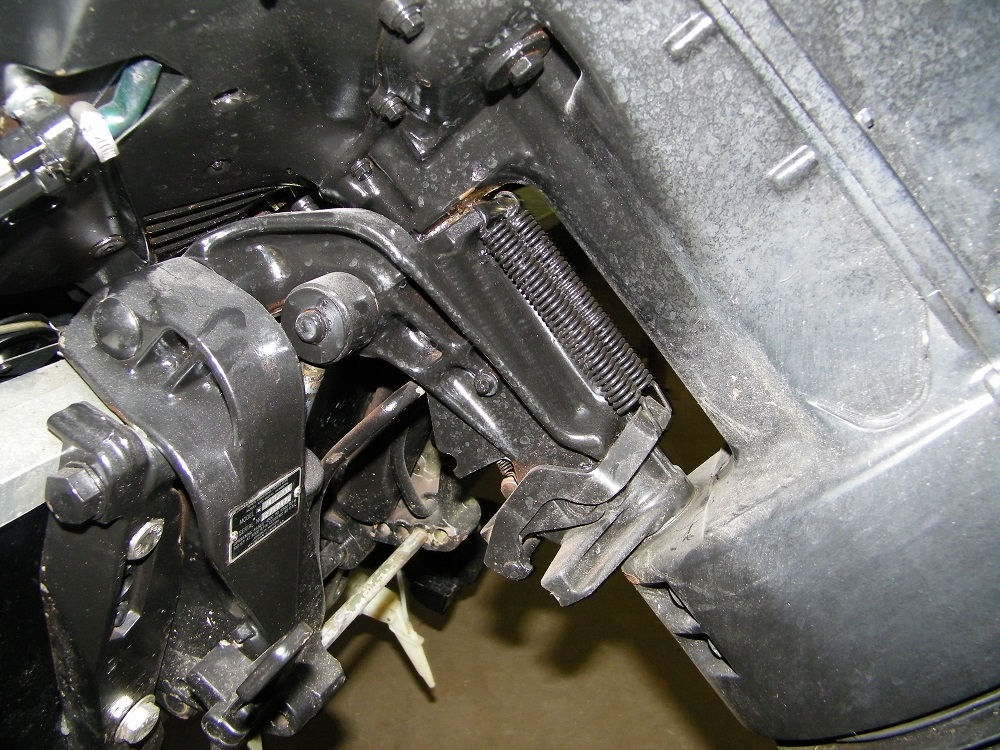

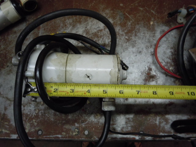

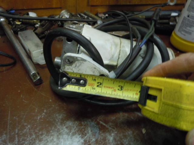

OK, I'm a newbie to the tilt thing, never had one before. Here's what I have. Came off a '73 rude 135 and I want to reconfigure it for the 100hp Johnson. By looking at the pics can anyone tell me what model it is so I can look up schematics etc. The motor runs when I make a direct connection to the blue wire, nothing from the red wire. Probably have to rebuild the whole shebang. Since the entire motor mounting system is completely different it's going to take some field engineering to make it work. First things first. Need to get the unit in working condition. PO said it worked, I guess he meant the motor ran :laugh:

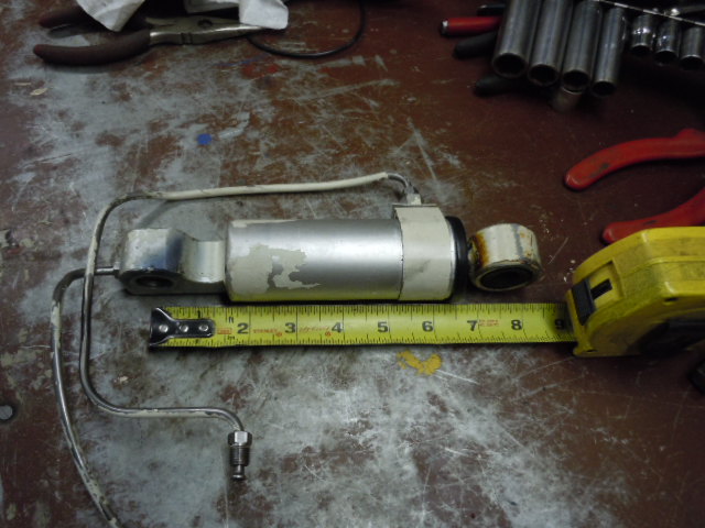

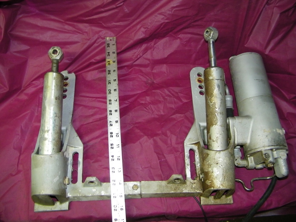

Cal, this is just my opinion, but that looks like A LOT of re-engineering. The lift cylinder is way longer than what will fit on your current motor mount. Here's some pics with measurements of a parts unit I have.

Cal, this will fit your motor although the seller must be smokin' crack or somethin' :laugh: . You might make a reasonable offer and he may take you up on it. Huh,as a side note I learned something new. This lift cylinder is slightly different with the return oil line entering on the back side instead of on the inside allowing the manual tilt lock to be used with the power tilt. Got schooled on that :)

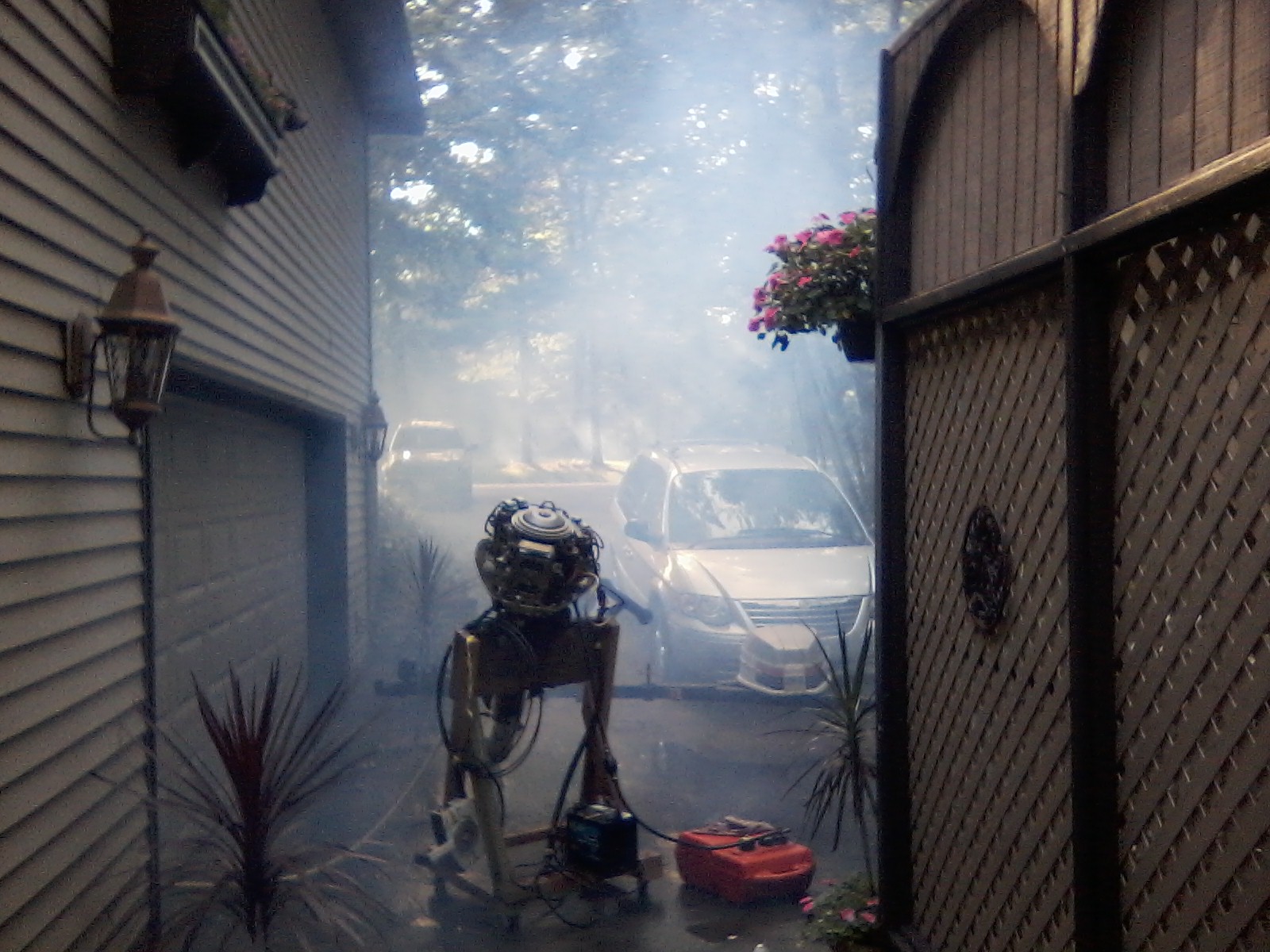

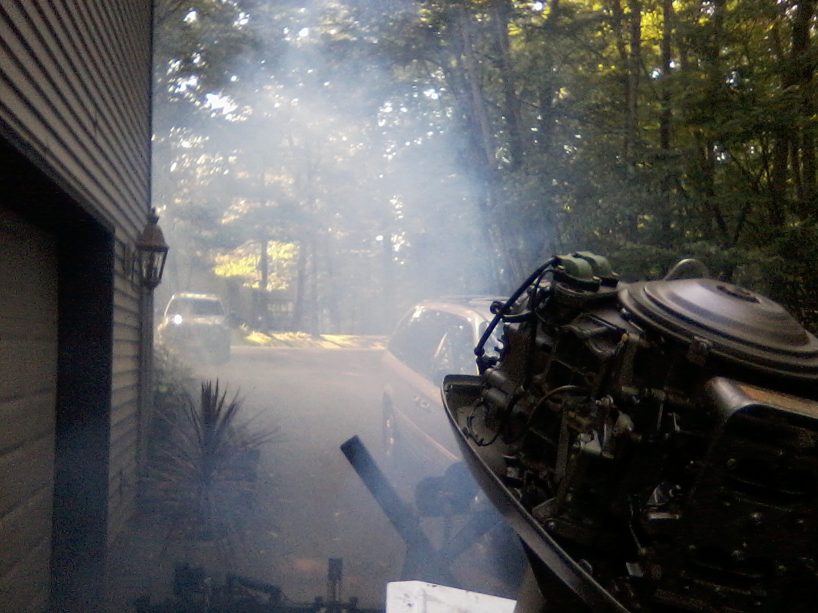

I know it would but now there's a conundrum. When I bought the junker boat for the tilt the old geezer said the motor didn't run but the tilt worked. Me thinks he had it somewhat backwards. Just for drill I hooked up the '73 135hp, pumped some gas in it and it fired right up!! "Smagin that!" Clean lower unit oil, good cooling and what looks like newer mag coils. Now the conundrum...do I swap the 135 for the older Johnson 100ho Meteor? The Johnnie runs perfect no problems, the 135 is 10 years newer and has the tilt (which doesn't work). I'm leaning towards the swap if I can get the tilt running. An extra 35hp never hurt either :laugh:
Pictures are when I blasted some seafoam into the carbs, had to turn the idling down a few notches as it worked in. Not a mosquito to be found and the neighbors did not call the local volunteer fire dept.

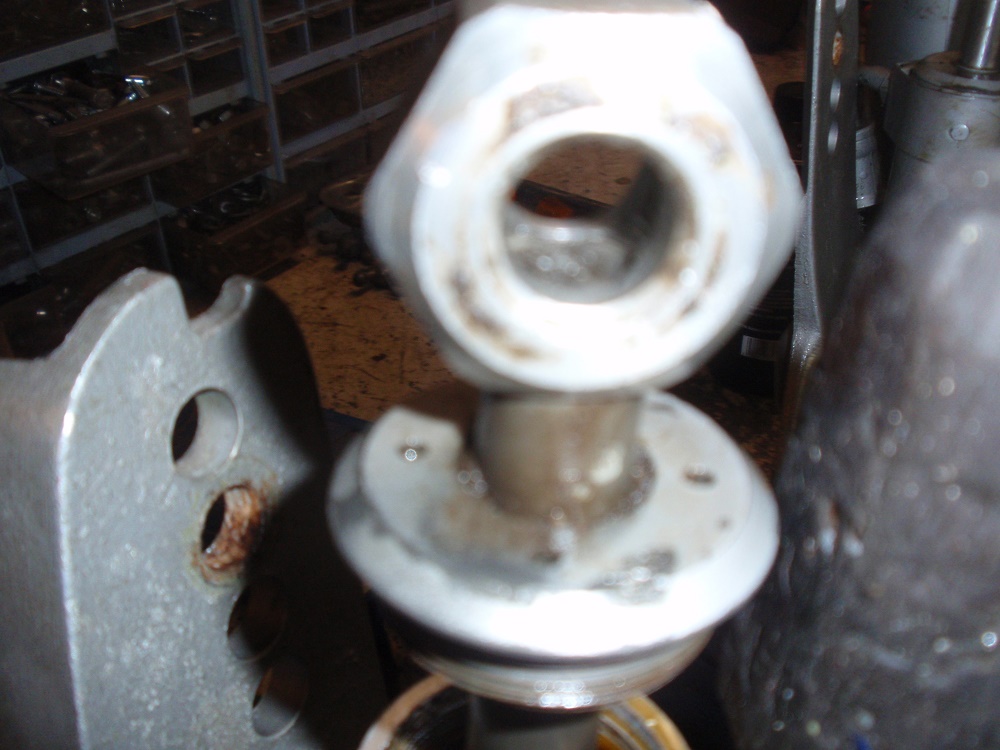

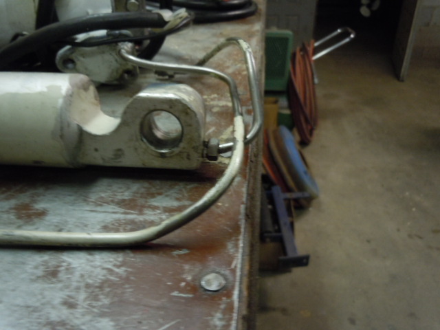

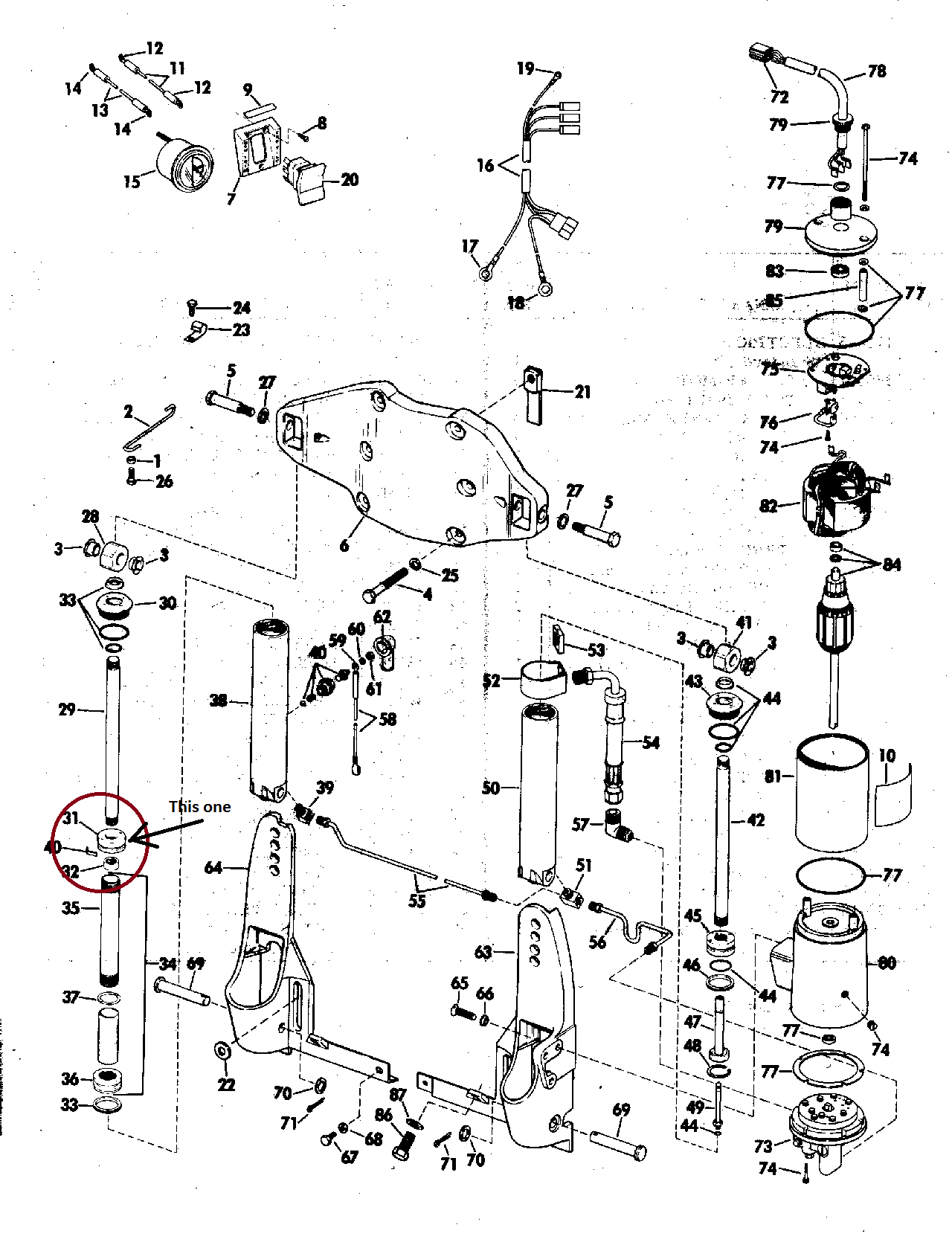

Good news, bad news today. Rained all day so I decided to work on the tilt mech. Good news is I got the motor rebuilt and running got all new hyd oil in it and one cylinder works perfect. Bad news is the other cylinder needs a rebuild. Here's where you guys come in. What is the name of the type of wrench I need to open this puppy up. I was able to get the first cover off using a clip spreader but the inner seal retainer takes a longer reach. If I knew what the wrench was called I could get one.
