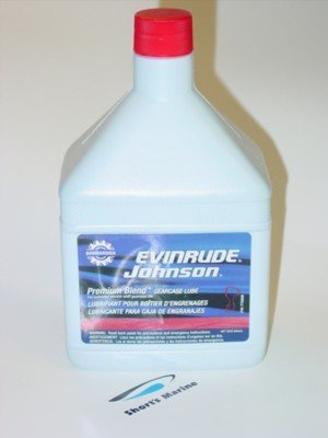

Johnson Evinrude Premium Blend Gear Lubricant
"Premium Blend Gearcase Lube. Quality lubricant recommended for all Evinrude and Johnson outboards, 1972 or prior with electric shift and OMC stern drives 1977 or prior with electric shift."
