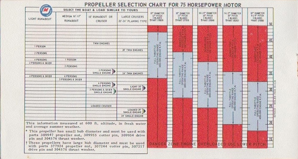

This is an OMC propeller booklet from 1965 with boat size recommendations relative to pitch / diameter for the 75 HP:
www.fiberglassics.com/library/OMC
And some tips for selecting the right prop:
Re:Speed prop on a 75 hp? 11 years 2 months ago #113997

Thanks Andy,the first chart tells me the 10x12 should do alright with just me in the boat which is kinda what I was thinking. I know that would be too much prop with my boat loaded with 3 or 4 extra people. I just figured I'd try the 10 x12 and if it don't pan out , I'll sell it.
