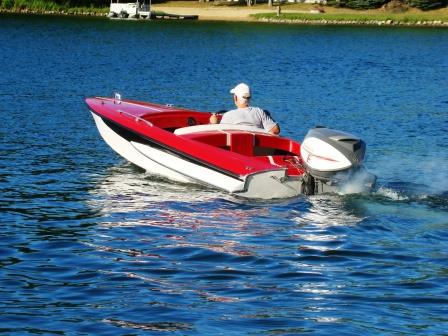

My Starflite runs like a top and pushes my '61 Centerdeck G3 to about 38 MPH. My problem is play in the gear shift. There is about 1/4 inch that I can't adjust out of the Simplex 2 lever shift cable. Consequently, if I can get it into reverse, I cannot get it into forward and vice versa. I would appreciate any help/suggestions/new curse words anyone has that can help me solve this problem.

Sorry,can't help you on your manual shift as I'm an electric shift guy,but just have to say the Starflite looks really neat on your g3. Was wondering what pitch prop you were running on your motor?

I have the same year and model of Evinrude pleased to hear how fast it moves your boat along.
