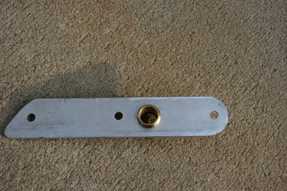

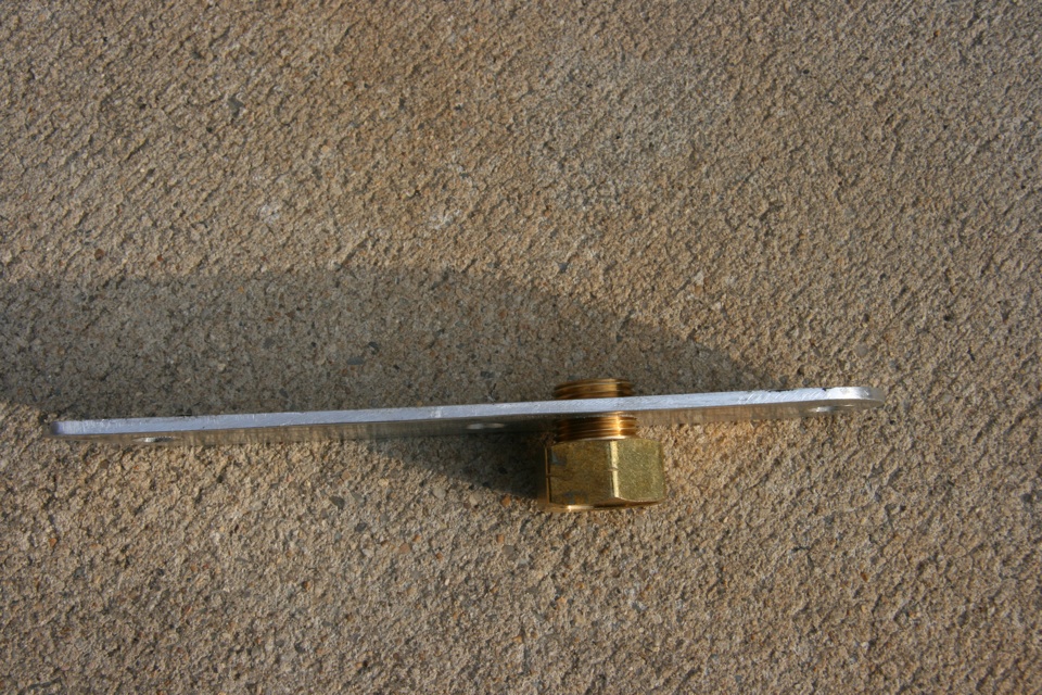

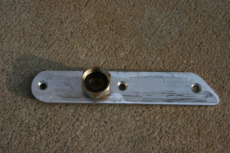

I've used a large plastic garbage can before with some success. if your lower unit is too long front to back, like my 80hp then I made a cover out of aluminum and a garden hose female receptical and threaded it through a hole I drilled in it.
Just spin it on the hose and screw it to the lower unit. Been using it for 2 years now and it works great.

Bob's method is the best way to flush or run an OMC with the old style water pickup. This is the way the original OMC tool was used for the purpose.
