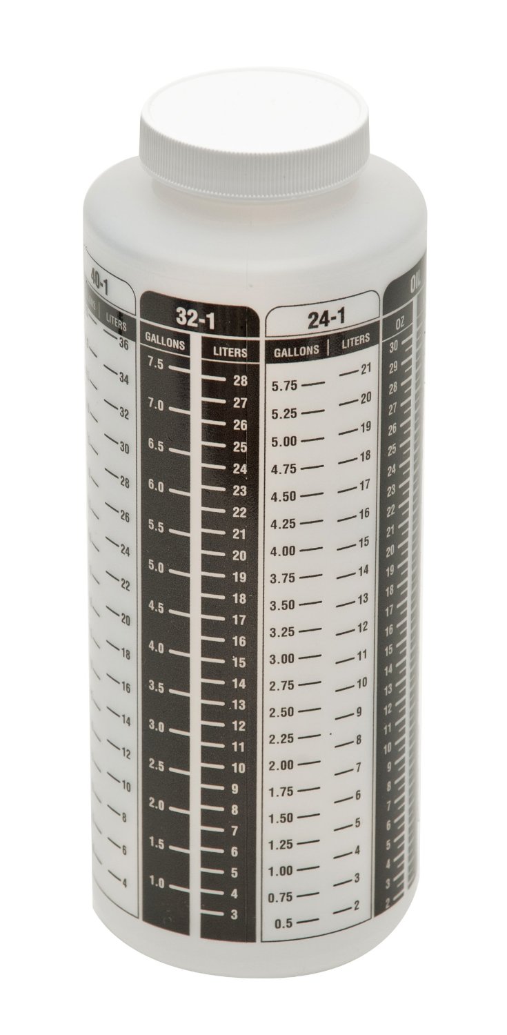

Everyone that runs a 2 cycle that burns pre-mix should own at least one 2 cycle Oil Mix bottle. I think I have about 5 of them. It is a good idea to have one with the boat at all times it is in use, or in transit. This way, if you need to pick up fuel - the bottle is handy. The bottles have tables printed on them that correspond to mix ratios for a given amount of fuel. The bottles usually have tables for 24:1 up through 100:1 Just fill the bottle with oil up to the mark that shows the number of gallons of fuel it is to be mixed into. Dump the measured oil into the tank and add the fuel. It is almost a no brainer. Also, if you have a partial tank, and want to top it off - just wait until you have added the gas to add the oil. For example: I top off a tank that needed 2 gallons to bring it up to full. I then take the mix bottle and pour in oil to the mark at 2 gallons on the 50:1 scale. Doing this will keep an accurate mix in the tank, even if you decide to top it off after using some from the last outing. Please be advised that you should NEVER TOP OFF A TANK WITH STRAIGHT FUEL. Enough capacity must be remaining in the tank to hold the oil that you need to dump in. This is easy to forget. Some tanks will hold a full 6 gallons of straight fuel and still have enough room to put oil in with the gas. But some tanks don't have the necessary room. Become familiar with the routine and it will become pretty easy for you.
Also - always remove the portable tank from your vehicle or boat when filling it up. Set the tank on concrete, asphalt, dirt, etc. A tank that is not sitting on the ground can build up static electricity and cause an explosion and or fire.
The bottles are cheap - buy a couple of them. You can get them at Wally, and lots of other places.
