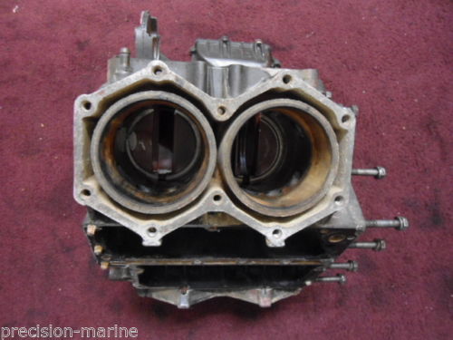

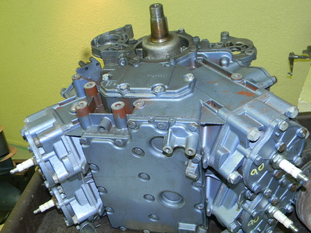

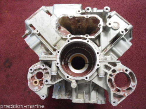

OK, have had some time to cogitate on the matter!
2 different thoughts:
(1) There is a cover on the top of the block that looks like it's for the common water chamber that would feed the exhaust manifold. So I'd think that if you can tap a fitting into that cover, it should be a nice point to sense water pressure. I'd imagine the cover is a bit on the thin side, so you'd have to see if it'd hold threads OK. Otherwise you could drill a thru-hole and use some sort of compression fitting. See attached pics.
(2) Lots of meat at the top of the block, forward of the head gaskets. You could easily drill into there and tap for a fitting. The one thought that did occur to me about doing it that way is that, with 2 thermostats, the Port and Starboard cyl head water passages would act like 2 separate cooling systems, in a way. So maybe both sides would need a fitting, which you'd attach with a tee to the single line for the water pressure gage. The pressure readings should balance out each other, so that if there was a drastic pressure drop in one side and not the other, you'd see it.
Or maybe the common water chamber tends to equalize water pressure in the system, I dunno! Never studied water flow thru a V4 to that degree!! :S
HTH.......ed

Note that in the last pic of the 75hp block, there's a fitting sticking out of the side of the Stbd-bank, aft of the intake port covers. Is that a water tap for the automatic choke function?
If so, that might be a good place to add a tee & pressure gage line, if it doesn't matter if you take pressure input from one-side only.

Yeah Ed, I think that goes to the water choke. I haven't noticed it in a while. I did install a loud buzzer last year in addition to the factory HOT light.I ground the wire going to the sender on the head frequently to "be sure" that it's working properly. Thanks for your insight on this. karma
