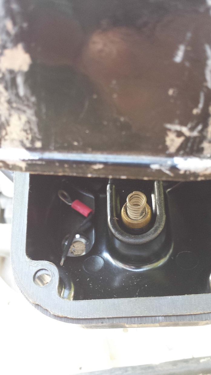

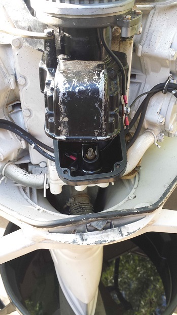

AH HAA
I dropped the distributor to check the spark with a screw driver and this is what I found. A broken wire just laying in the cap. It broke off of the coil.

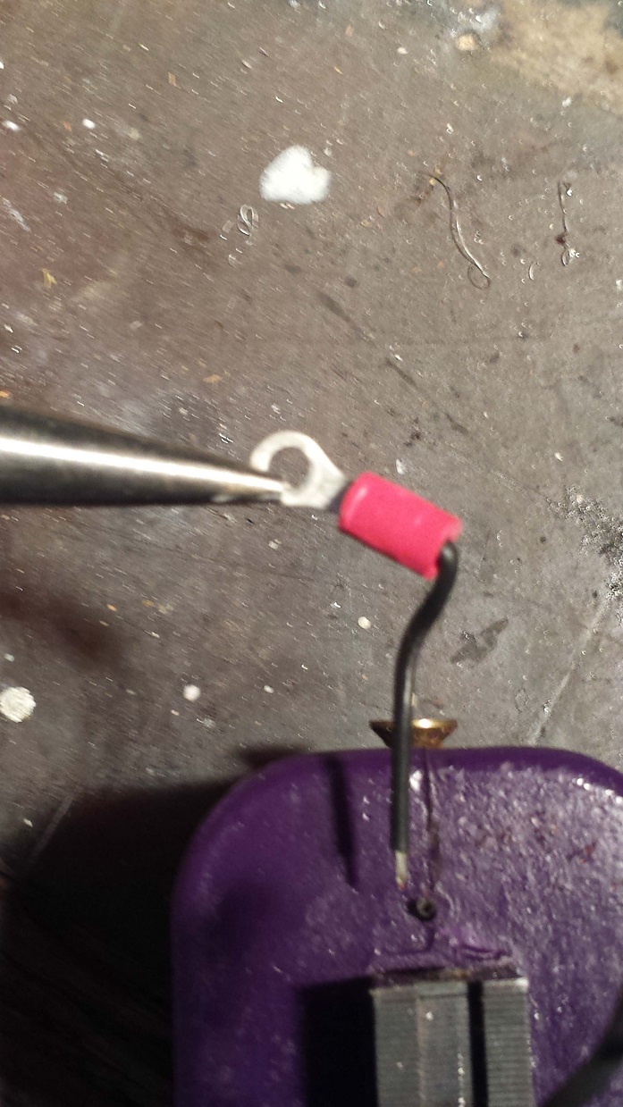

AH HAAA!
Dropped the distributor and I found this broken wire in the cap just floating around.
It was just laying in there. It had a terminal end and it was broken off at the other end. Un-connected to anything.
I think it broke off of the coil. There was a wire nub the same size on the coil. I think it connected here.
The wire obviously was connected to this spot on the coil. There is nothing left to connect it to. This makes sense as in the diagrams in the manual they show two wires coming from the coil and I only had one wire connected to ground at the housing. Where did this other broken wire connect to? And where was it hiding while I was working on the distributor?
I'm going to order a used coil off ebay that one of you nice guys found for me. But where does the wire connect?
HELP!
Thanks,
Mike

Re: 1960 Johnson 75 HP Super Seahorse Won't Start 10 years 10 months ago #112992
Not necessary to repost, we know you're here :)
I took some pictures from the magneto I have from a '60 Rude 75hp starflite that's parted out.
Might be helpfull - or not.
Looks like you're little wire connects to the outer insulated terminal.
Re: 1960 Johnson 75 HP Super Seahorse Won't Start 10 years 10 months ago #112994
  • Mike H.
  • Mike H.'s Avatar Topic Author
  • Junior Boarder
  • Junior Boarder
  • Posts: 81
  • Karma: 1
Thanks! That makes sense as I had no wire to connect to that make up.
