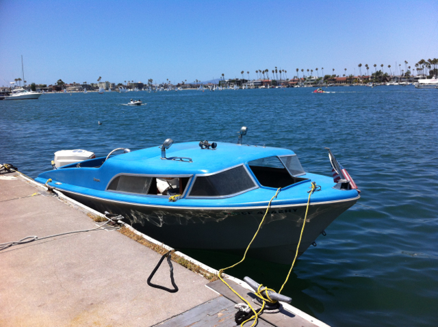

Here's a pic:

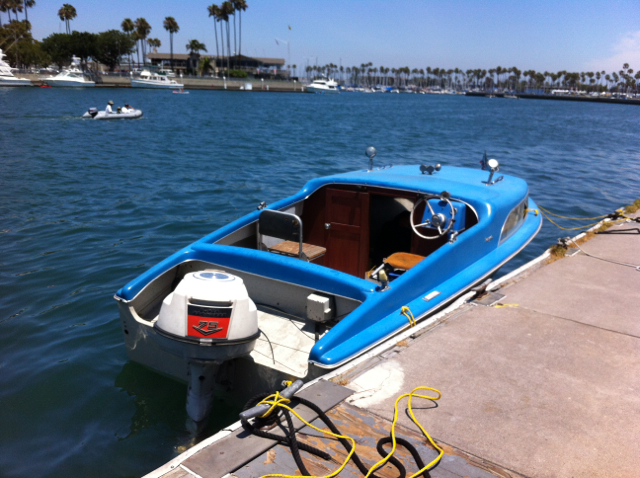

Here's the Johnson:

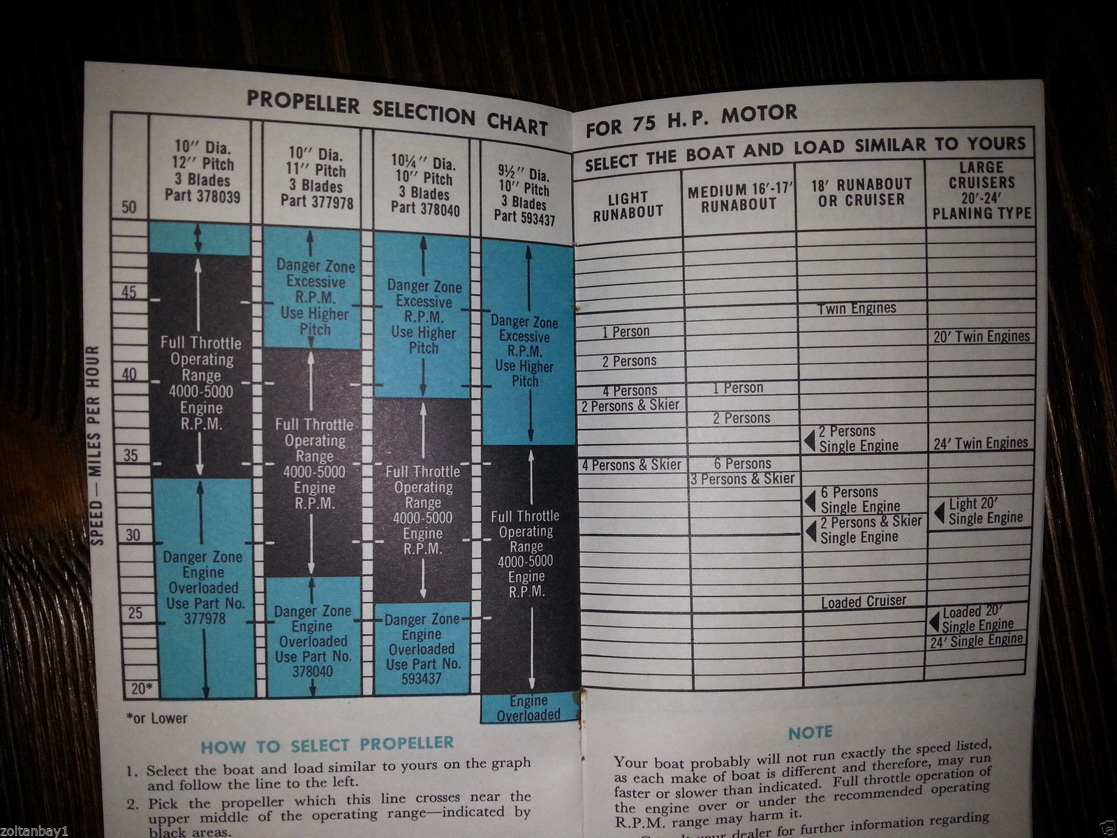

What prop do you have now? I'm thinking your boat would need a 10 1/4 x 10 pitch. That pitch was pretty common on those 75s. A Michigan prop number for that pitch is PJ-75.

Paul,there should be a number stamped on the prop hub. OMC props will have those numbers that are on the diagram I posted. Michigan props will have a number like the PJ-75 or something to that effect. Post your number and me or someone else might can "decipher" it for you. jim
