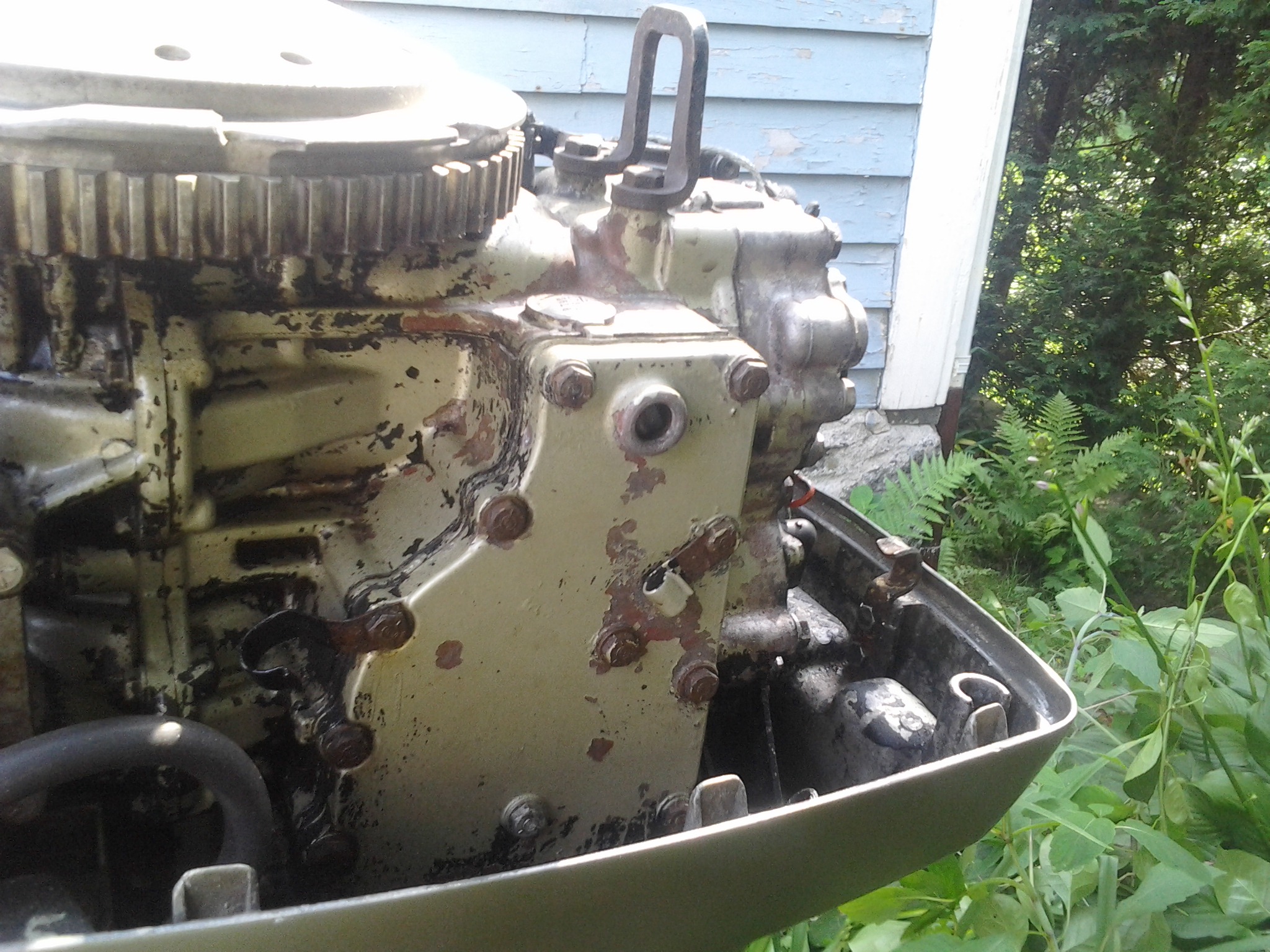

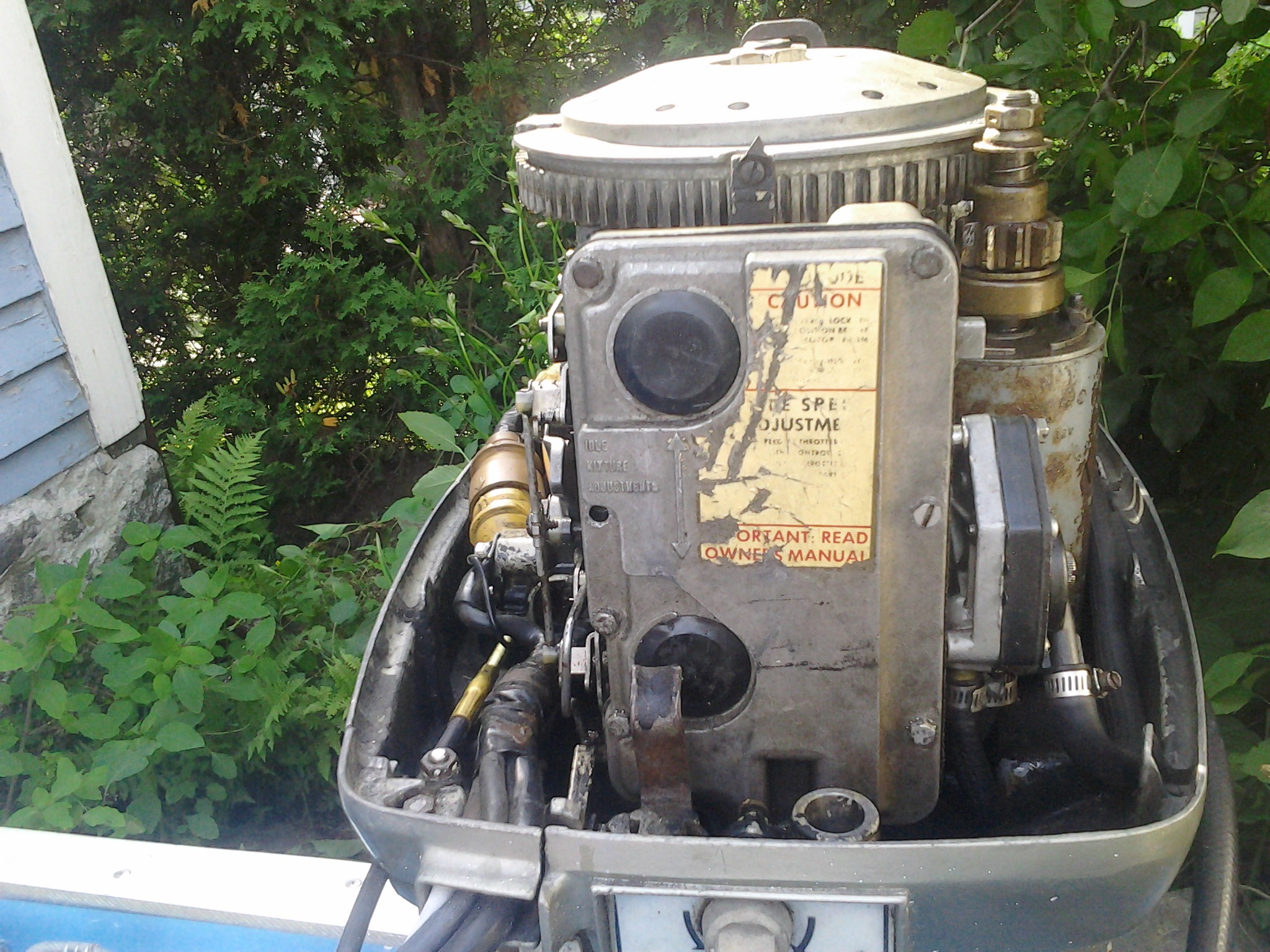

Re: New to me 1971 Evinrude Lark 50hp... 11 years 4 months ago #112403
Thanks Guys!

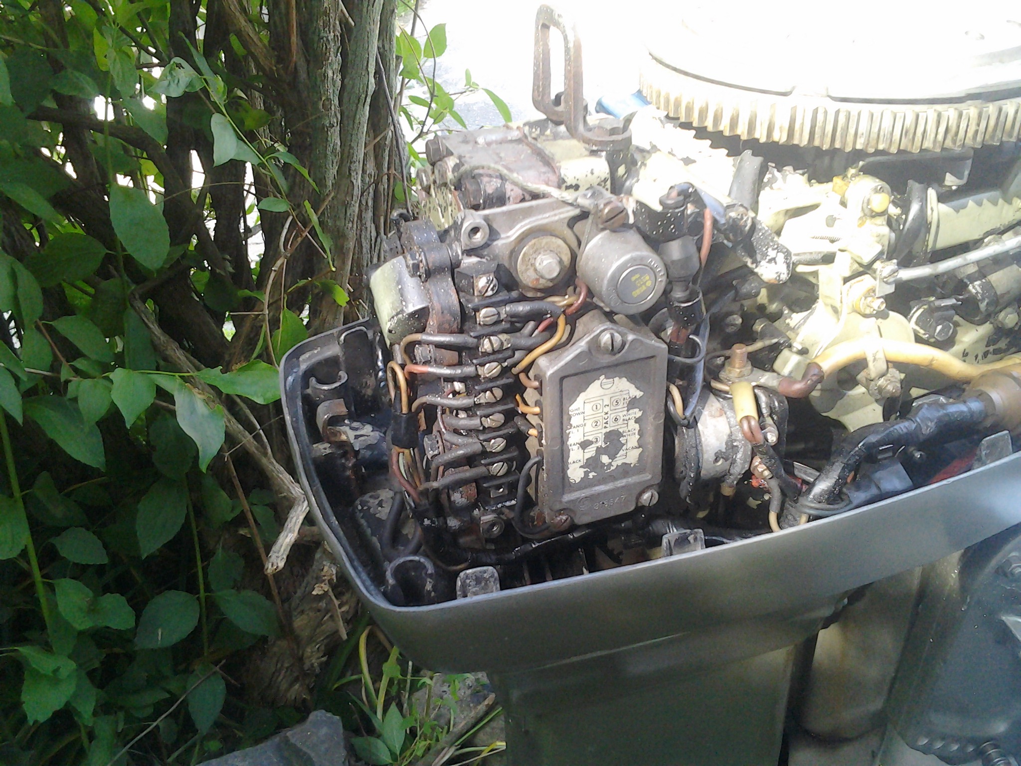

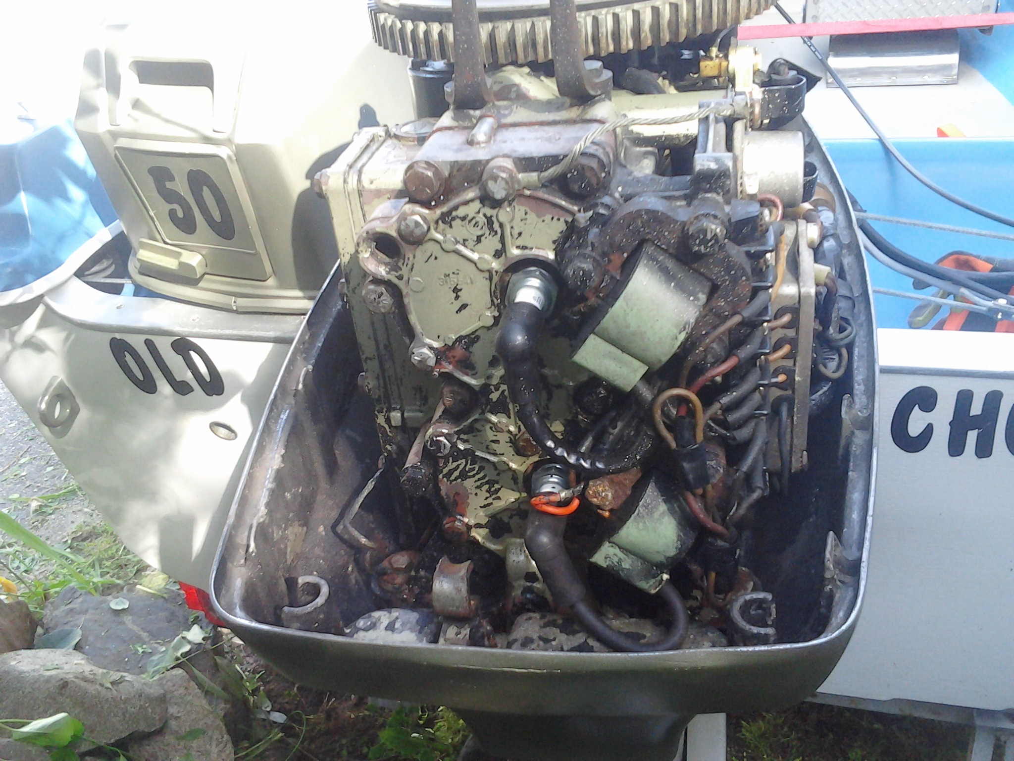

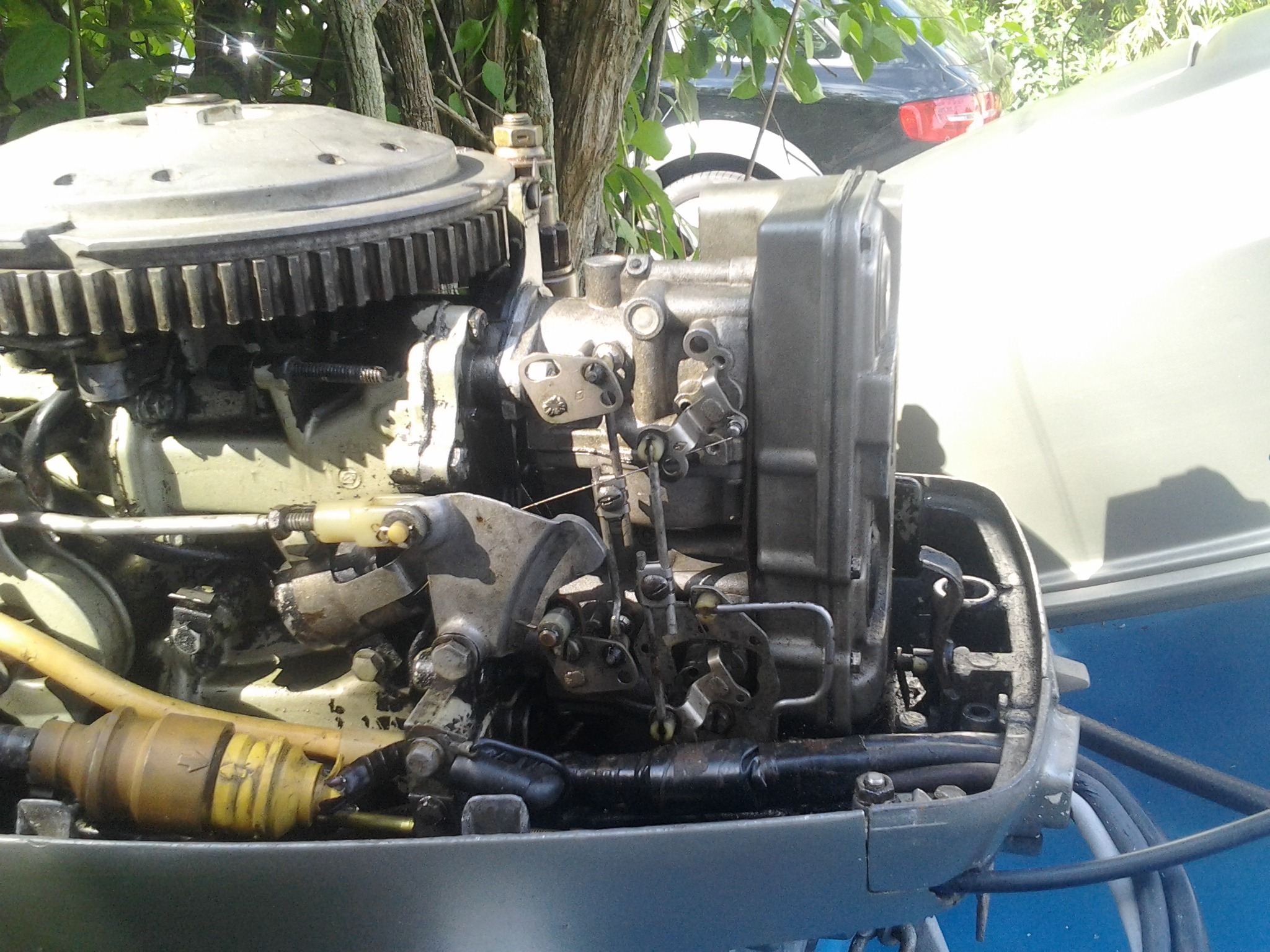

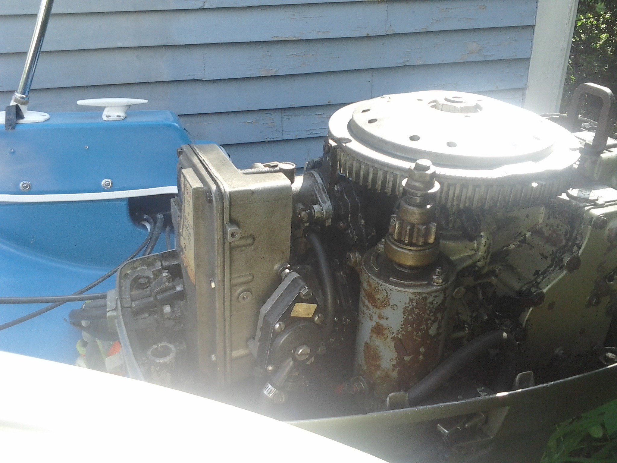

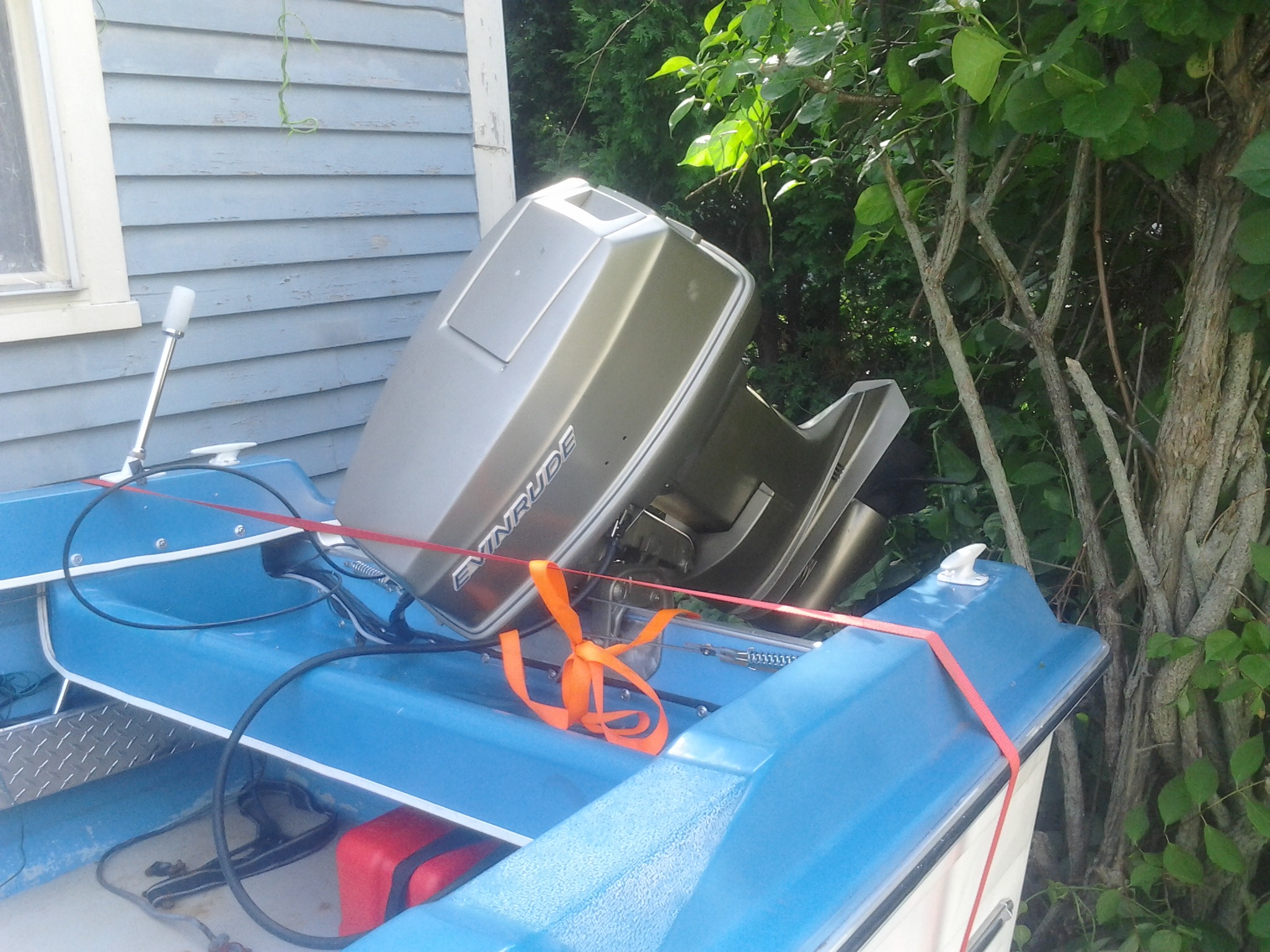

Here we go with pictures....
Re: New to me 1971 Evinrude Lark 50hp... 11 years 4 months ago #112415

Looks clean, have you tried it in the water yet??
