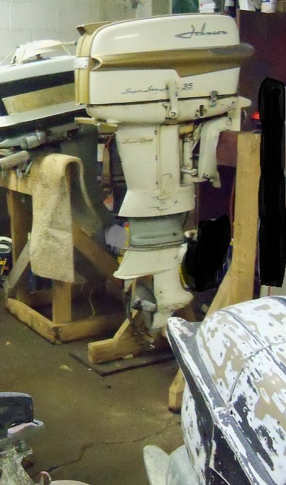

Well, I pulled the '57 Lark off the boat and replaced it with my '58 Johnson Golden Super SeaHorse, which I have never run. I ran a file through the points, replaced the fuel lines, coils look new... It fired right up. Ran in the barrel for 10-15 minutes, pumping water, then started getting rough. One of the plugs was fouling. Spark looked weak on that wire. So I pulled the boot, trimmed the wire back, no difference. So I ended up pulling the flywheel, stripping and removing the stator plate. one of the coils was leaking spark at the boot, so I replaced the plug wires, put it all back together with a new coil for the one that was slightly burnt. Seems to run OK now, good enough to take out for a run.
