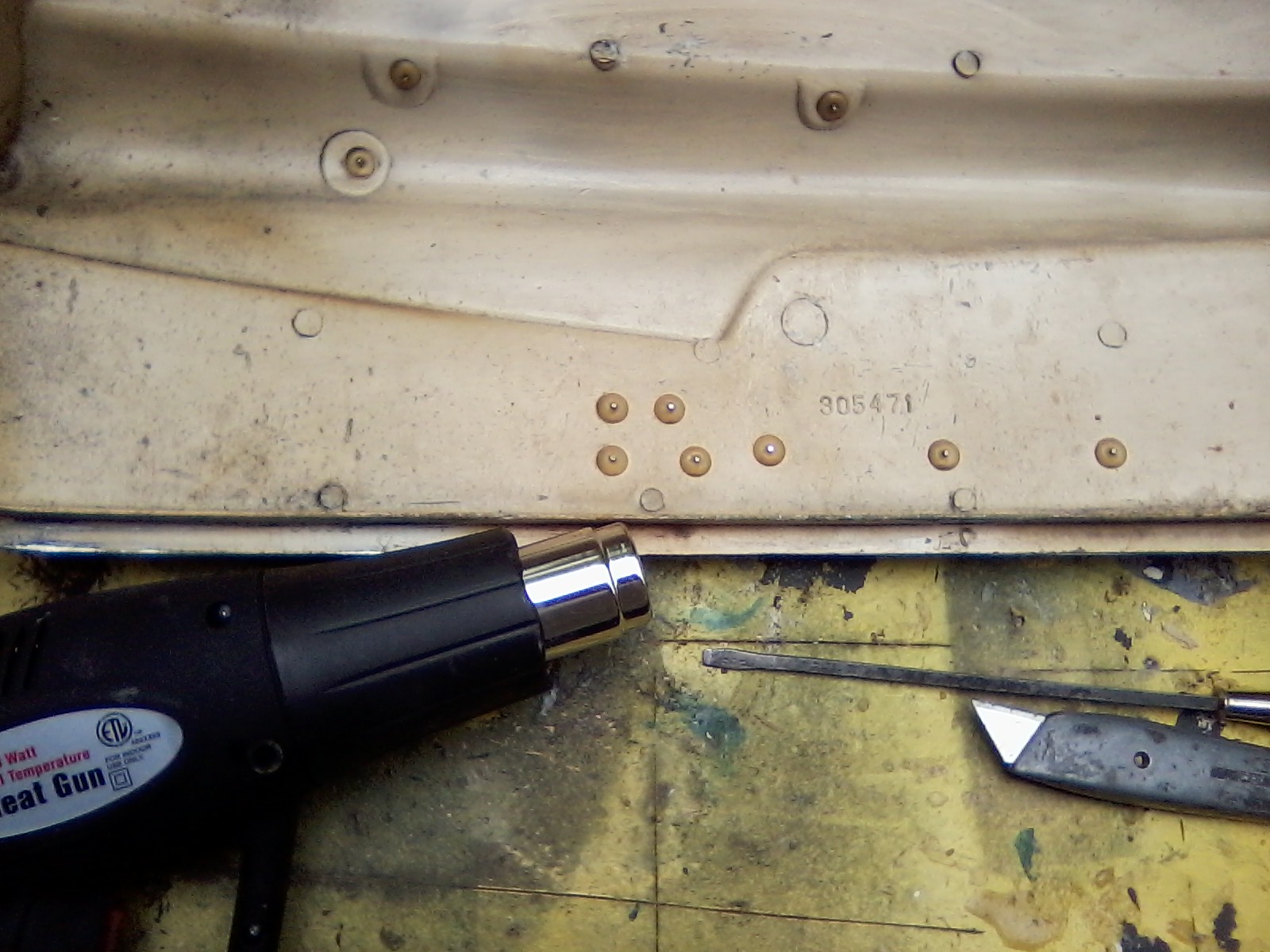

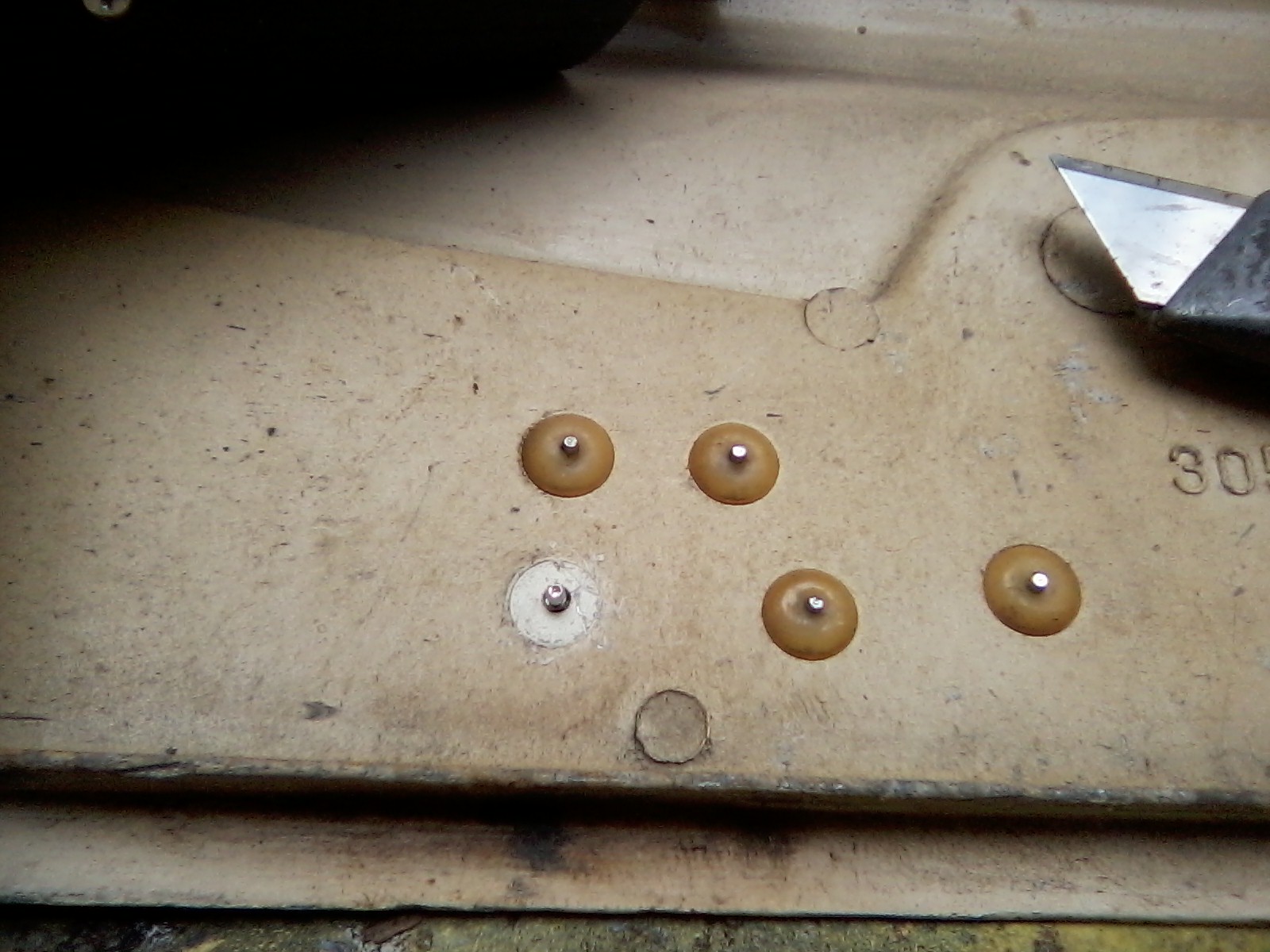

Started stripping the Johnson RDS-20 today for paint. Most of you probably know this but for those who might do this at a future date. The emblems and badges are held on by little rubber thingies(?)that are usually pretty brittle after 50+ years. I did this to this motor and also my '60 75hp Rude.

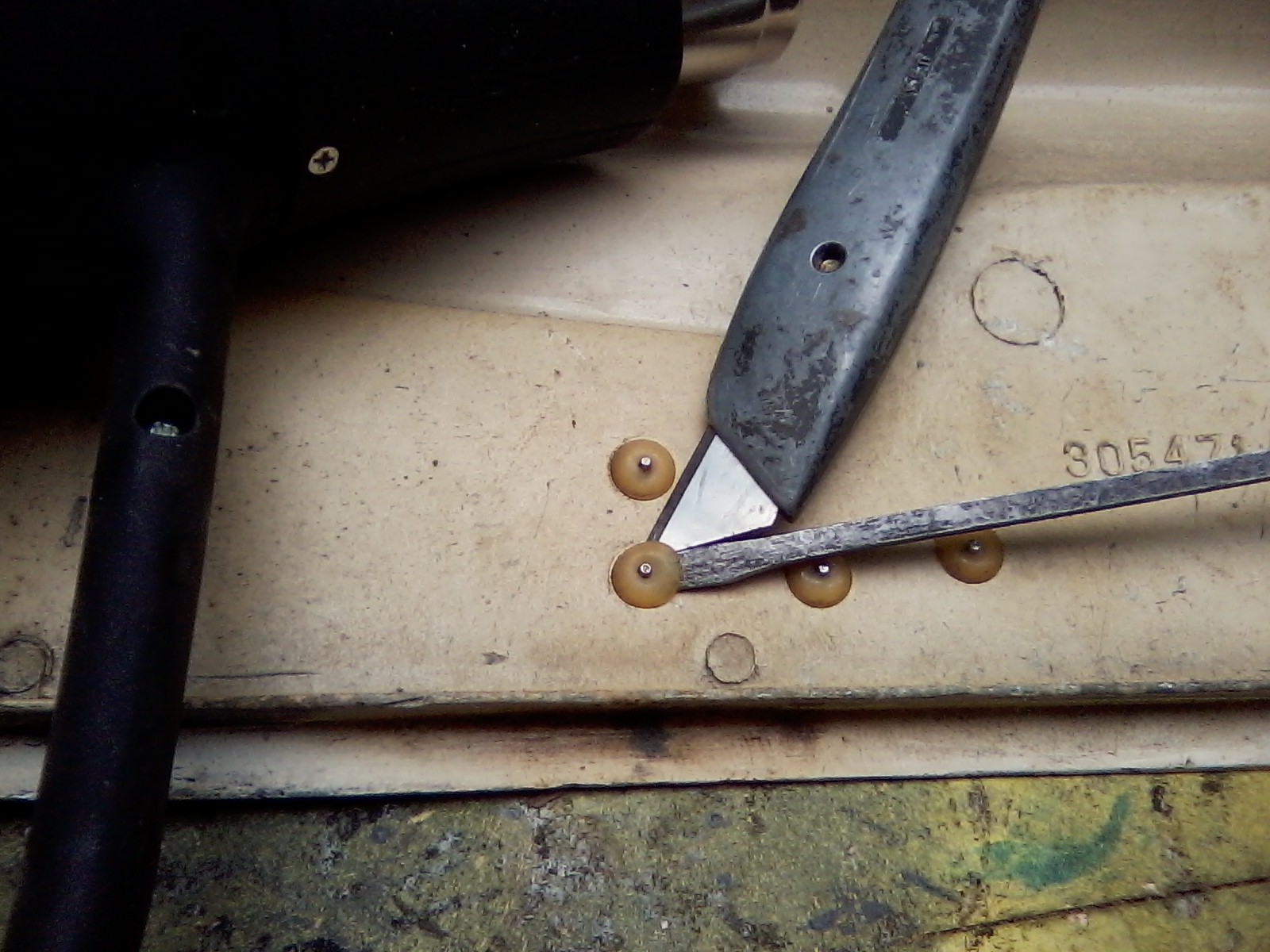

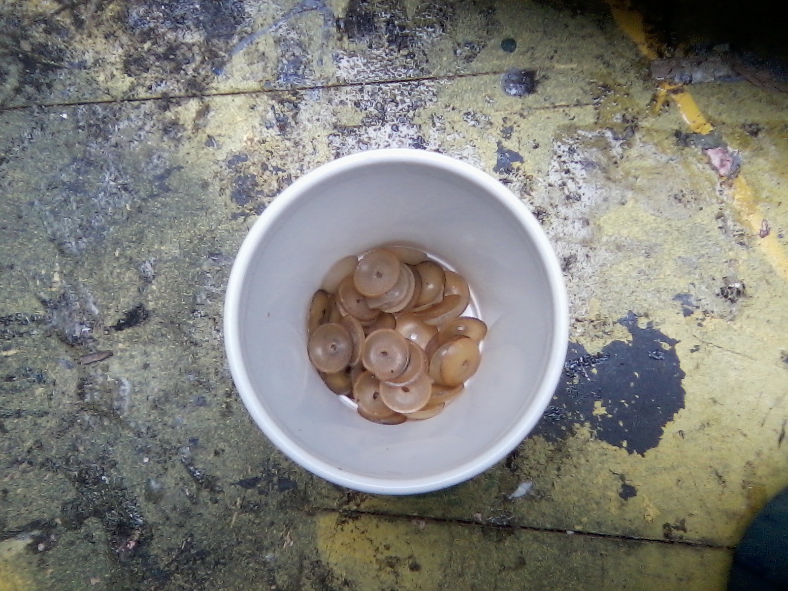

Take a heat gun to soften up the rubber washers slightly just to make them pliable, slide a sharp knife or something else under the soft rubber, insert a small screwdriver and just give it a gentle twist. You can save them all to reuse and not damage the stub on back of the emblems.
