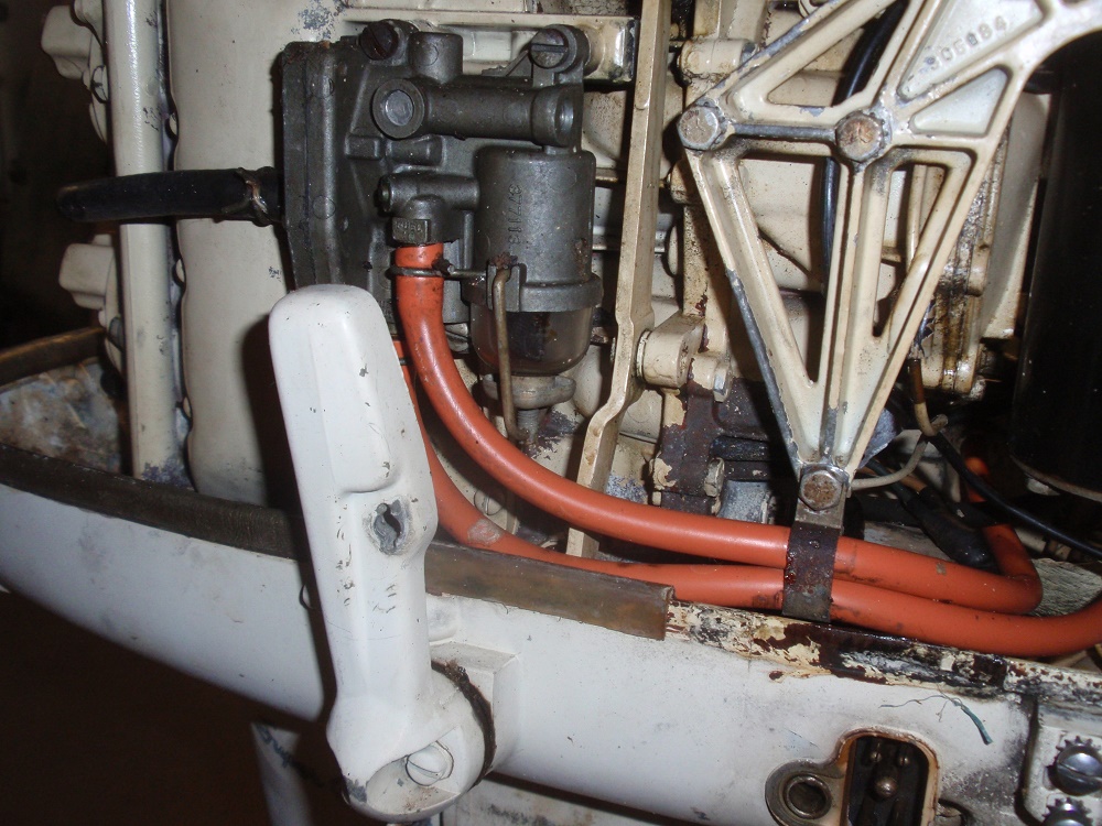

Last week I finished putting the '58 Johnson RDS-20 together and got her running fairly well, needs tweaking when it gets in real water.
Question is it seems like the fuel pump cannot keep up with the flow needed. the filter bowl will fill up and the motor runs for a minute and then the glass shows that fuel is not pumping fast enough. I have two pumps that I can switch out but both diaphragms seem like they are stretched out. No holes or cracks but just sorta rubbery. Would this be the problem? Looks like a result of ethanol.
Marineengine.com has them $7.99.
While running on the stand I put the fuel line in a one gallon container about 2' below the motor. Thought this might be the problem but when I moved the fuel level with the motor is still did the same thing.
This is an old photo before the rebuild.
Cal
