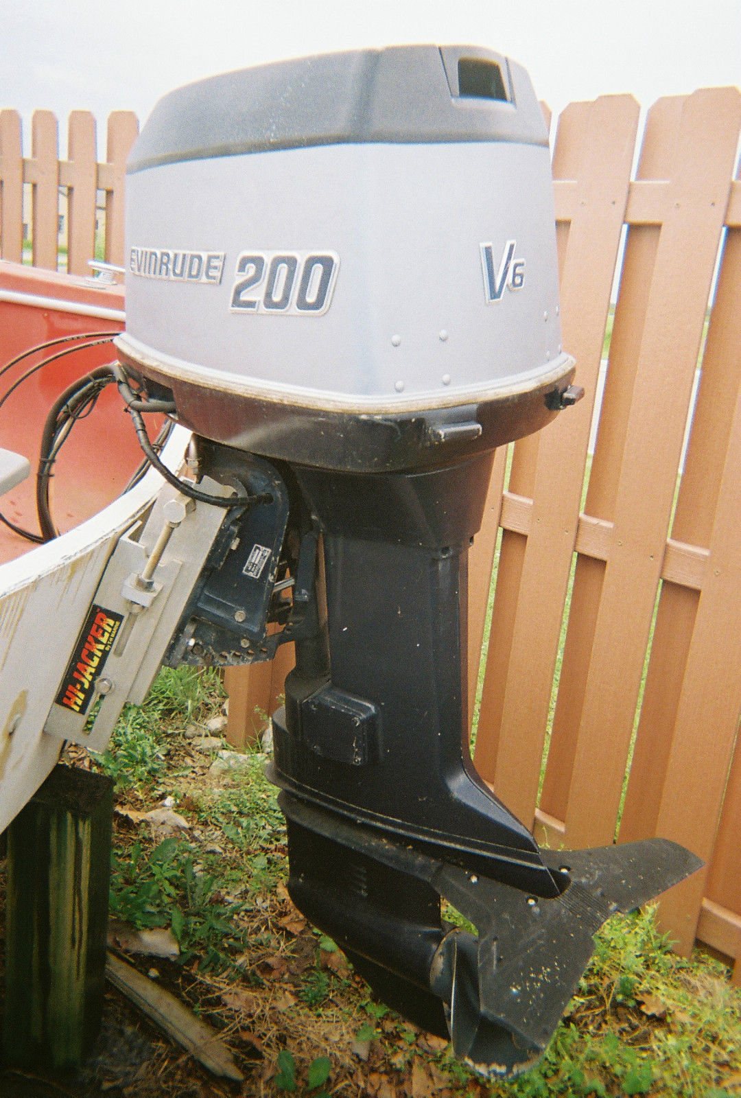

I'm thinking about buying this but if you know me, you know that I know next to nothing about outboards. Do these engines have a reputation good or bad? Any idea of fuel usage? Any advice would be appreciated.

Buy the motor if it comes with the hijacker then dump the motor and keep the lift. IMHO :laugh:

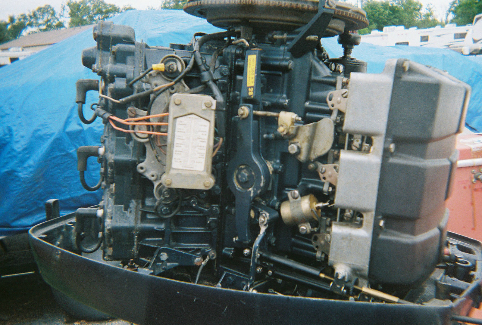

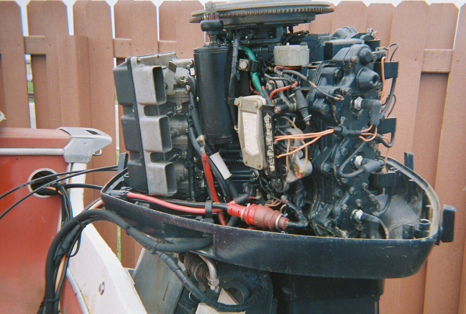

I have no idea how old the motor is but I'd guess 1970's. Here are two photos with the cowl off. Maybe somebody can tell me what I'm looking at. I also need to know how I tell the year of manufacture. There must be a tag somewhere with a date or a code. Where will I find it? I'm thinking of buying the boat, motor and trailer but if the motor is a clunker, I'll probably pass.

Go up to the first post and look at the pic. On the motor's transom bracket the I.D. tag is clearly visible. Post the model and serial numbers if you need help looking the year up.

by looking at that ignition system.. i'd be thinking 76 - 78
76 was the first year for the 200.. and by 79 the ignition system changed..
