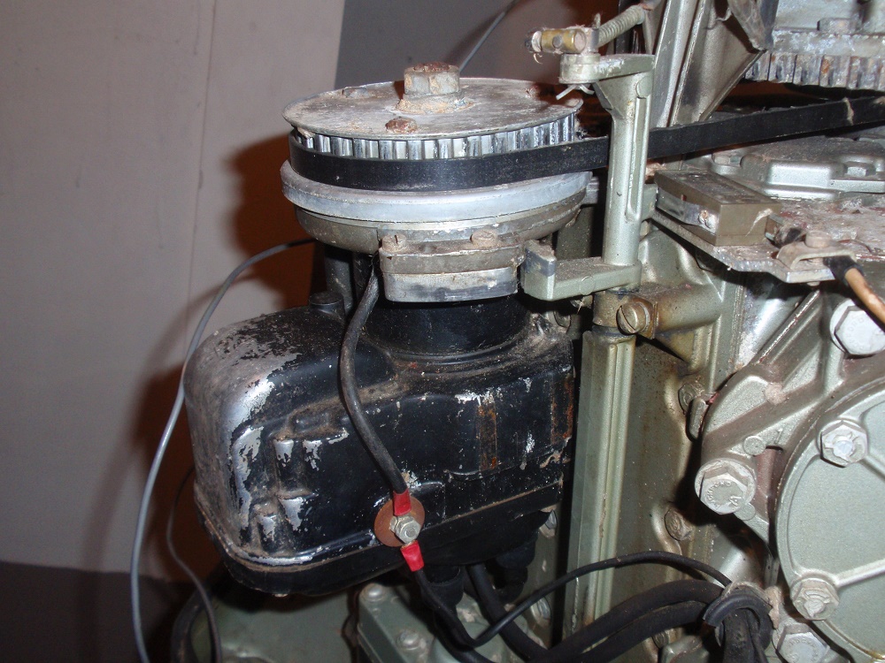

Starting to part out the '60 Rude 75hp Starflite. Want to put the magneto on the web but need to make sure it's in working condition. Anyway to bench test or check it out??

Pull the mag, remove distributor cap & rotor; lay the mag on the bench, ground the shaft of a screwdriver to the mag case and hold the screwdriver tip about 3/8" away from the copper strip coming off the mag coil.
Give the mag pulley a stout spin in the clockwise direction and watch for sparks! Be sure you don't come in contact with the copper strip or you'll be the voltage tester!!!
A "hot" mag will pull more than 3/8" gap, and it should be crackling, purplish spark. Common issues for none-or-weak spark are dirty points but if not that, the mag coil is either weak or is arcing to the case. If you pull the coil and see burn marks, it's shot.
HTH......ed

Leave the mag on the motor
Buy a 1/4 (or 3/8) drive adapter for your drill to drive a socket with..and in turn spin the Mag. Take the belt loose
Buy a spark tester and hook between the spark plug and wire (I have 2)
Disconnected all wires from the mag
Spin the mag with the drill and see if you have spark
www.harborfreight.com/hex-drill-socket-driver-set-3-pc-68513.html
www.harborfreight.com/catalogsearch/result?q=spark+tester
