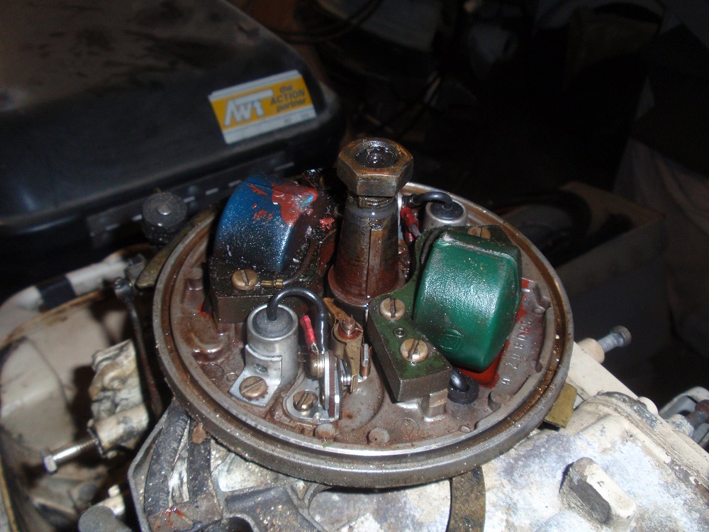

Starting to clean up this 57 year old RDS-20. Having a heck of a time getting the top to "ping". Right now I've got lots of tension on it and sprayed it completely with PB Blaster to let it soak. Seems I've done hundreds of these things but this one is a b--ch.
While waiting for magic to happen I managed to strip the entire, almost motor apart but so far nothing broke loose. I'll let it sit over night and see what happens in the morning. In the meantime anyone have a special secret? I've given it the hard raps on the puller, gently tapped all around the flywheel to vibrate. Hate to use heat. :angry:

Try flipping your pulling tool over. You want the bolt heads and washers resting on the flat side of it. A couple of your bolts look like they aren't in the flywheel straight. You can also stick a bar, of some sort, through the bolts to keep the flywheel from turning as you tighten up your puller. And make sure the flywheel nut is still on there so the flywheel doesn't shoot across the garage when it finally pops.
Re: Poppin' the cap 11 years 5 months ago #109708
Yup, I used my puller the the wrong way for a long time, until, totally by accident, I realized my mistake. Allows for shorter bolt use also and seemed to work better. I had one on a '69 johnson 40 that took about 4-5 days to get off. Every day I'd go in, make sure puller was tight, and give it a couple of raps. The day it was loose, I thought at first the puller broke...lol :-

That's exactly what I am doing. Going to reverse the puller. Now that it's mentioned it seems pretty obvious but then again it takes longer to get something into a thick head...says the admiral.
I'm sorta hoping when I look at it today it will be loose but at least now I have a few more options.

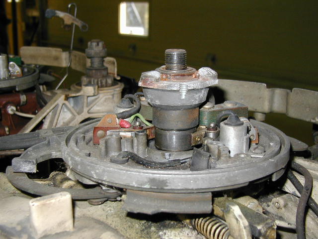

Here's the results of a previous owners attempt.
Cheers
Bill
Re: Poppin' the cap 11 years 5 months ago #109757
WOW now thats a bad attempt at removing a flywheel right there...
Re: Poppin' the cap 11 years 5 months ago #109758
Yowza!! That's a whole lot of bad!

Bill, Gee, someone's ears had to be ringing when that happened :laugh:
I'm going to print that picture and tape it on the wheel so I can see it every time temptation rolls around.
