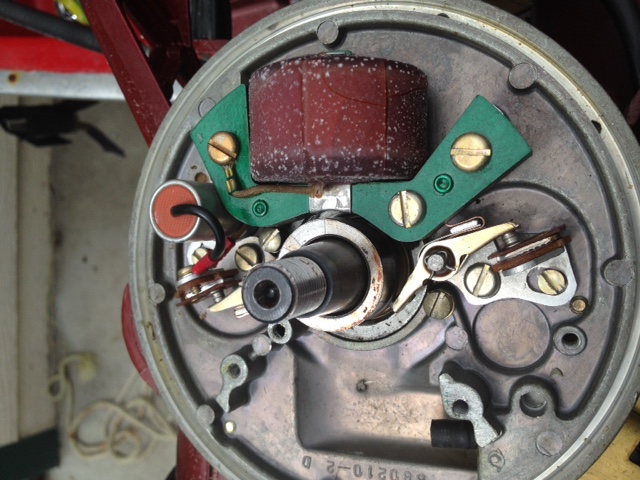

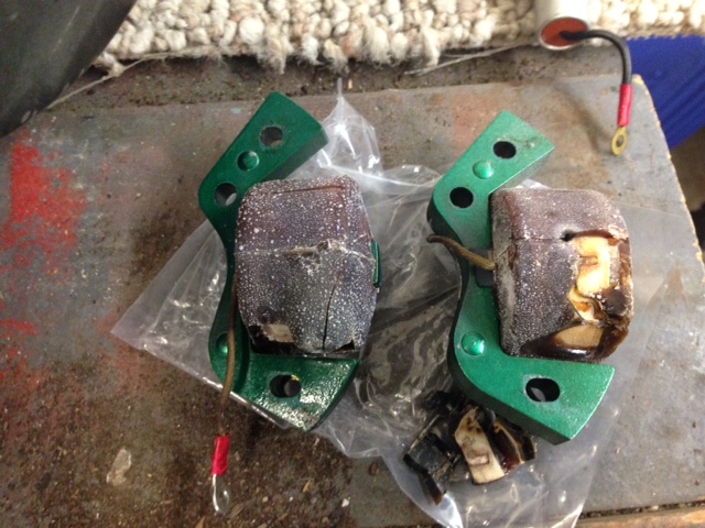

Re:'57 Johnson QD 18 H help 11 years 5 months ago #110348
Finally got around to replacing the coils, points and condensers. I think it's safe to say I found the source what was causing my spark issue.
