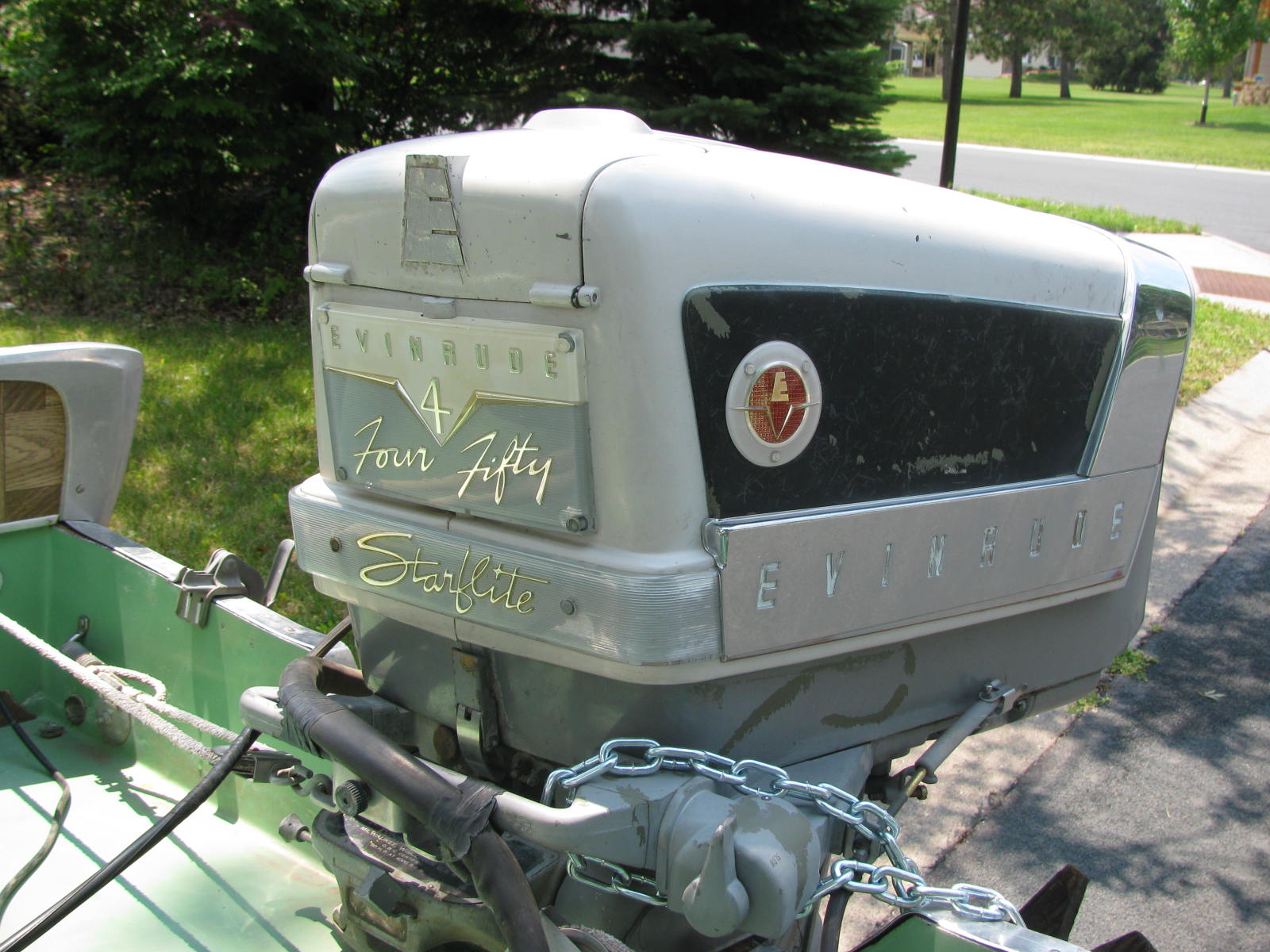

Re:Coil for 58 fat fifty 11 years 6 months ago #109531
Nice looking '58 Fifty. Yours is the first I've seen with the Evinrude 'E' still on the front cover! Now I know what it's supposed to look like.
Larry

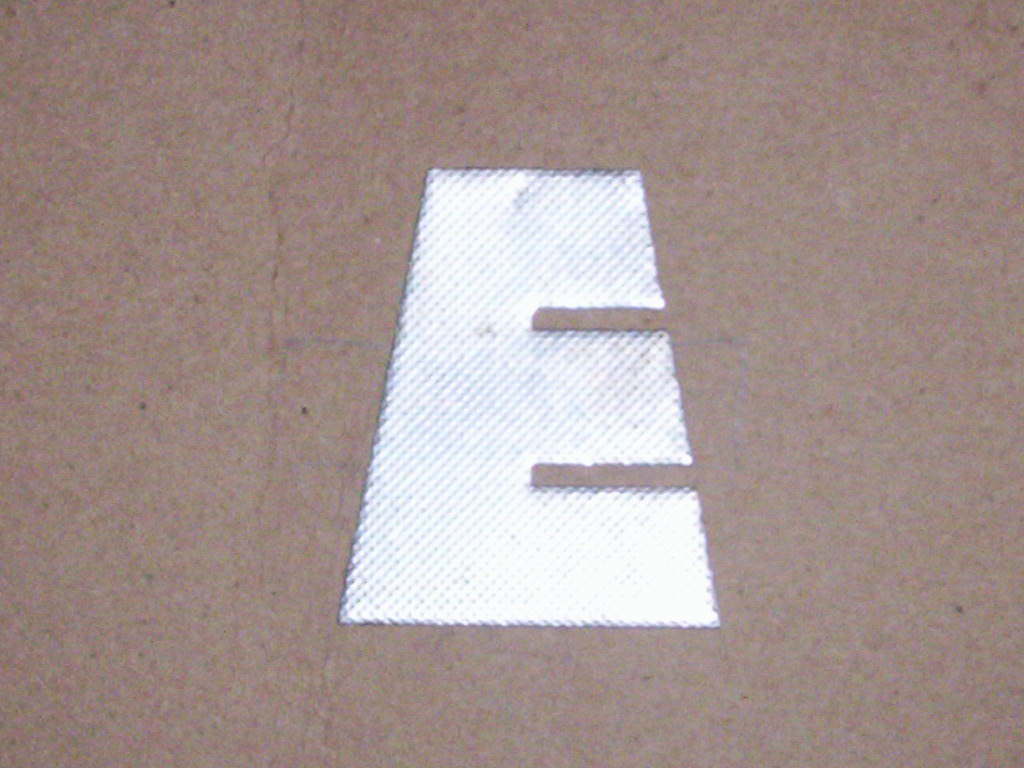

Re:Coil for 58 fat fifty 11 years 6 months ago #109533
That's not the real "E" so you still haven't seen one. The previous owner faked it with tape. It is the shape of the original "E" though. Now to get it running.
Re:Coil for 58 fat fifty 11 years 6 months ago #109586
  • w guy
  • w guy's Avatar
  • Posts: 49
  • Karma: 5
I've been looking for one of those "E"s too for my '58 Four Fifty. They're so simple. One would think making one would be a piece of cake IF the right material could be found.
