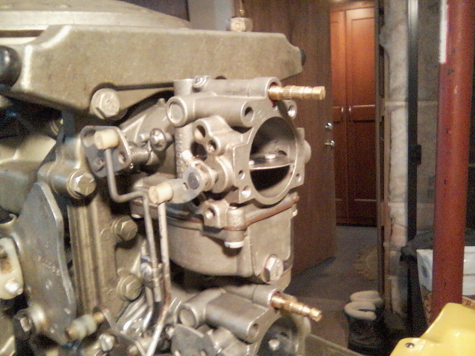

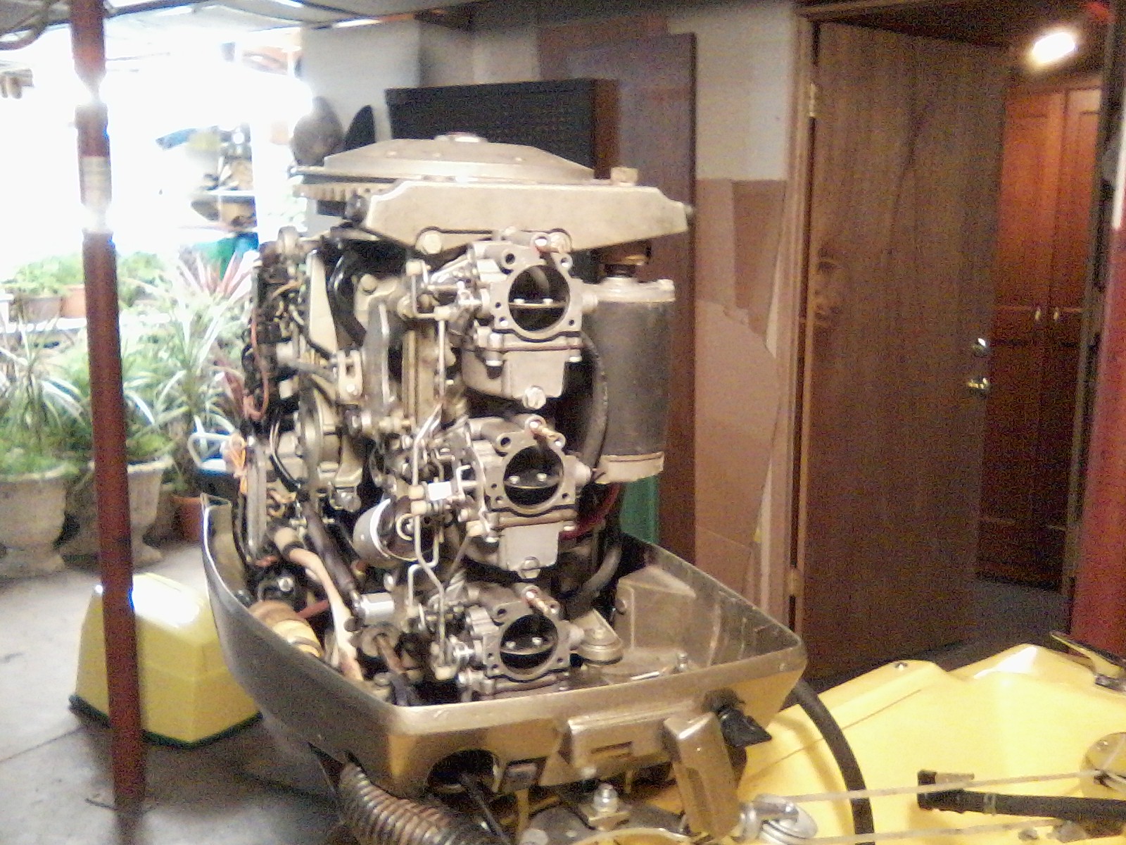

I'm finishing a rebuild of another classic and have a '72 65hp Rude hanging. I fired it up for the first time this season in the driveway and two of the three cylinders were firing. Top one not going. If I gave it a small spritz of starting fluid it would fire up so I'm figuring a carb problem. I pulled the carb and there was some gook in the bottom by the drain plug but nothing serious. I shot all the passages with cleaner and blew them out, put everything back together and now it sits, I haven't had a chance to try it out again. When I took the carb apart it appeared that the PO had done a complete rebuild, all new gaskets, seats, float etc.
Do you think it just needed a cleaning?? Like I said I haven't had a chance to fire it back up since reinstalling. Hoping this was an easy fix.

Could have been the dirty carb Cal, they don't like gunk. Mine was acting funny until I cleaned it out from sitting the winter last year, even used stabil but needed cleaning.
Re:Opinions please 11 years 7 months ago #107688
Bob, I'm going to give it a try today. What else could it be really. Fires the upper cyl with a little help from the ether so I'm hoping there was just some sticky stuff somewhere. Bad thing about running it in the driveway is the noise with muffs so I'll shove a garbage can under her. Good way to check out the new water impeller anyway.
