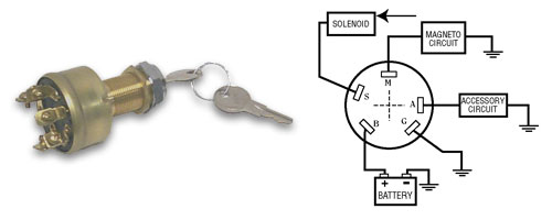

Re:RDS 20 wiring question 11 years 3 months ago #112512
Went to install the new switches yesterday, and I still think they're wrong. Has only one mag terminal. Can the other mag wire go to ground, or do I need a switch with two mag terminals?
Thanks
Bill

Re:RDS 20 wiring question 11 years 3 months ago #112536
Hi Bill,
Yes, the second magneto wire will go to "ground".
Hi Mark,
I do not think much of the plastic bodied switches, but the brass cased one Bill pictures is nice.
Regards,
Joe
Profile Picture:

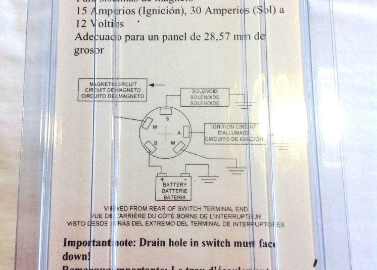

Re:RDS 20 wiring question 11 years 3 months ago #112542
Thanks Joe, I was hoping that was the case. The only switch I could find with two mag terminals was the plastic one, which I really didn't want to use.
Cheers
Bill
