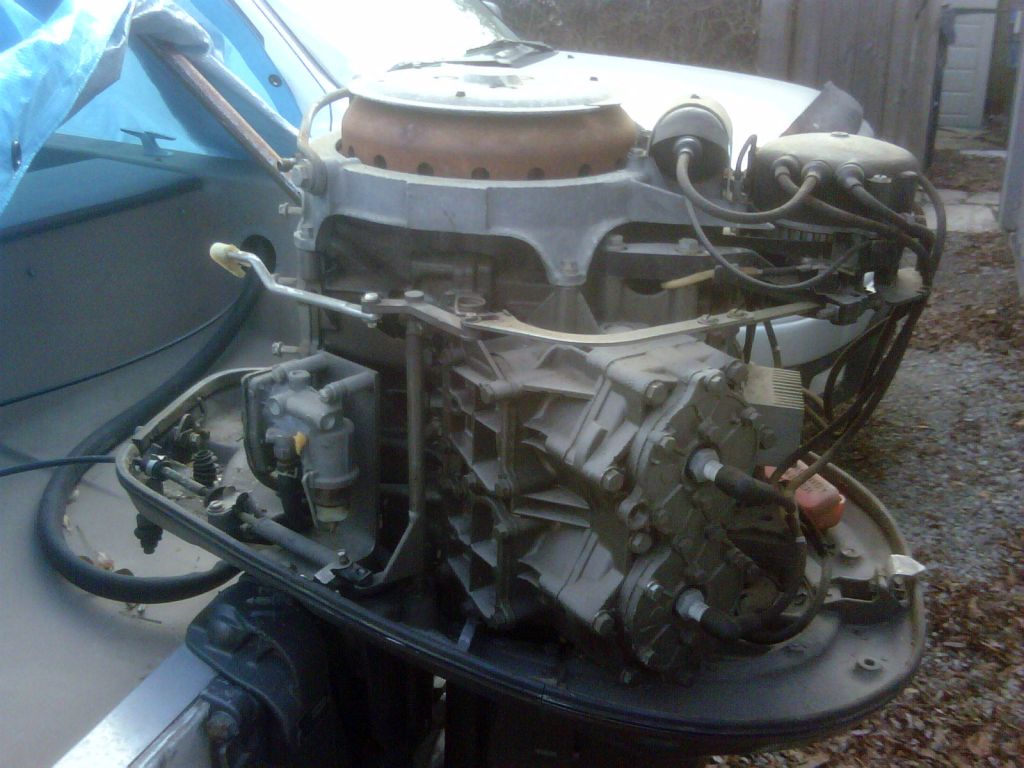

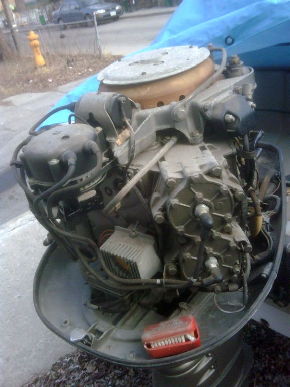

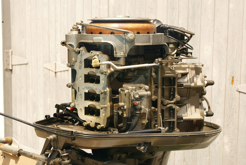

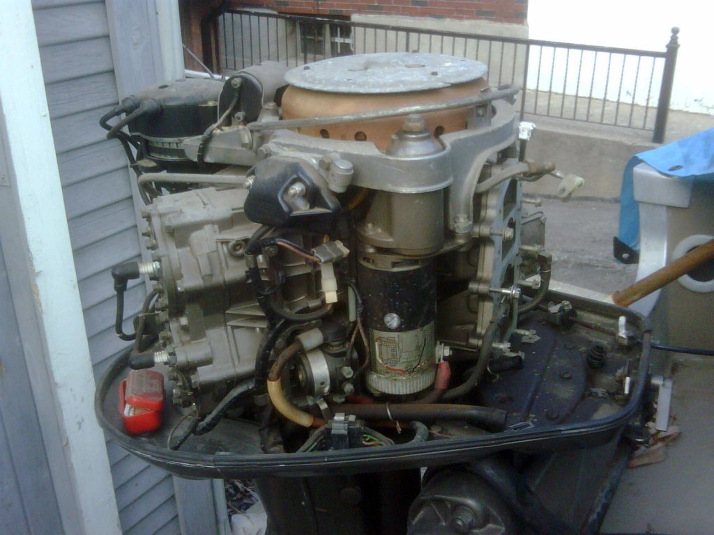

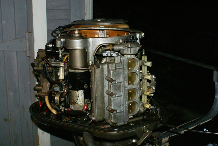

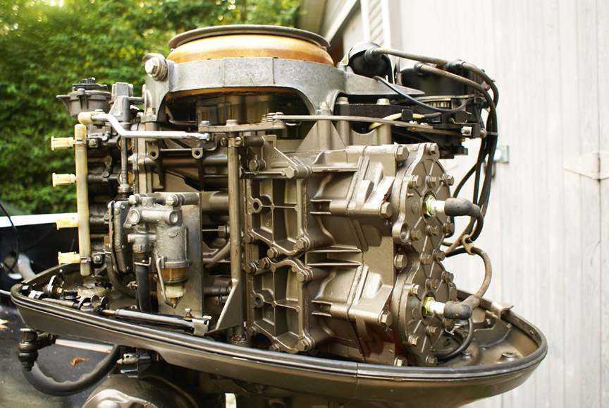

Well, thanks to all of you for the outstanding advice... I actually reassembled, remounted the carb's, found all orignal parts thanks to this forum, completed a rebuild of the fuel pump, new plugs, cleaned points, changed lower gear oil, and, after likely 40 yrs, started her up :-)
The only part I can not find is the automatic choke retaining ring which restricts the choke spring from rotating so while she started (and actually idled!), there is still the issue of correcting the choke settings - and some fine tuning.
I have attached some before and after shots -and one of the motor on the newly restored 1962 Crestliner Del Rio Imperial.
Cheers, Matthew

OK, so here is the latest. Changed the plugs to NGK B7S which are the replacements for the Champion J4J – set gaps at 0.030 (Thanks Andy!)
Reduced the low idle settings to a leaner mixture.
Clamped down the auto choke housing while I wait for the correct retaining clamp so it held the flaps lightly closed.
Turned the key and, she sprang into life. Now, the idle and high RPM ranges are still rough, but not as much. Dropped it into forward gear - nicely engaged, ditto reverse so at least the ElectricShift is functioning.
Turned it off, waited, restarted, sprang to life immediately. Still rough however.
Choke seems to be functioning properly, however I still need to fine tune the low idle settings to try to smooth things out.
Now... here are some of my concerns which I would appreciate comments and advice – please :-):
A) on touch, cylinder 3 seems much cooler than the others. Should I check spark to all four cylinders – perhaps one is missing causing the rough idle?
B) Still too much smoke for my liking, but as she ran it got better
C) hesitation on rapid throttle advance (too lean?)
D) once she was to operating temp, I noticed, disturbingly, that the carb fuel overflow was dribbling fuel out (not pissing, but not dripping – enough to smell obviously) which suggests the carbs are getting too much fuel?
E) the engine has moments of smoothness and then moments of roughness at the same RPM
F) low idle not so much smoke – increase RPM (lightly revving) and much more smoke… but on revving, engine smoothes out and becomes quieter…
Anyway, there has been a great deal of success of late on this thanks to all the support and I would like to keep improving the performance so comments are WELCOME :-)
I have a video which would allow those familiar with this engine (or any OB for that matter – which I am not) to listen to what she sounds like idling but I’m not sure how to upload…. So final piece of advice is… how might I do that :-)
:unsure:
Many thaks to those who can respond, Matthew

Re:1966 Evinrude Starflite 100-S OB Update 16 years 4 months ago #10780
Matthew, if you can post your video on you tube, then just copy and paste the address from the bar on your browser here it makes it much easier. That's how I do it, the FG forum automatically displays as you saw it in my post.
Now let me give you my two cents on your issues:
Definitely do a spark check. From what you're describing about your idle going rough then smooth, this would be a symptom as well as one cyl running cooler.
That's not uncommon when reviving one, once you get all the little issues sorted out and run it a little, I think you'll find it will diminish even more. They're gonna smoke a little, that's a good thing. Mine had some idling "hickups" that stalled the motor occasionally, that eventually went away after running her a while.
Probably, back the idle mix screws out 1/4 turn and see if that doesn't cure that issue. (You mentioned that you leaned out the idle mix earlier, I would put that back for now.)
Sounds like your float level(s) may be set a little high. Either that or there may be a small piece of trash or something in the needle and seat. Proper float level and meticulously clean fuel are a must, raw fuel dripping out when running is dangerous. I'd pull that carb back down and check it out for sure.
You're getting close buddy, hang in there.
Re:1966 Evinrude Starflite 100-S OB Update 16 years 4 months ago #10821
That's a nice looking Starflite.
Here are some answers to your questions;
Are you sure on the year of the engine and sure it is not a 90? If memory serves me at all, all of the 100 HP engines had solid state ignition. I don't believe any 100 hp engines had points. It is common to find an earlier disto mounted to one of these to get "around" having a blown up pulse pack. The packs cost hundreds of $, while the old disto is cheap. Performance will suffer some.
Be sure the reach (threaded area) of the cylinder head spark plug hole is indeed 3/8 inch deep if you are using 3/8" recah plugs. The J4J, B7S, etc. have the short (3/8") reach. The plugs in the late 100s had a longer 5/8" reach. The surface gap plugs are for Solid State ignition only - they won't fire correctly with a coil & points system.
Your engine WILL smoke. It is a crossflow of vintage design & that is just the way they are. The more you idle it, the more it will smoke.
Dont not rev it up in neutral (at least not much) Take it to the the lake or river to load test it. Leave it strapped to the trailer and just be sure the cavitation plate is a few inches below the surface. If you can find a test wheel, this is the corerect way to load test it & tune it. These do show up on Ebay once in a while.
If your engine no longer has a pulse pack and uses a regular coil, just go to kragen or some palce & buy a tachometer for an 8 cylinder car. an 8 cylinder 4 cycle car engine has the same number of firing impulses per crankshaft revolution that your 2 cycle V4 has.
Regarding the automatic choke - putting an auto choke on a 2 cycle outboard was one of the most stupid things OMC ever came up with. They finally dumped the idea in '68. Solve the problem with an electric choke from either a '67 or '68 carburator. your WILL save gas by doing this & it will run better.
Remove the sparkplug wire from the "cold" cylinder and ground it to the engine block. The best way to do this is to shove a 1/4 inch bolt into the boot, then clamp this to ground with a vise grip. Start the engine. If it does not run any better, that cylinder is dead. It could have a bad sparkplug, bad wire, cracked or shorted disto cap, reeds stuck closed with varnish, or a bad piston. Have you done a compression check?

Dear Mark, Bruce,
Thanks very much for the advice - all good.
Bruce, definitely a 1966 100-S – serial numbers confirm. I’ve attached some earlier before resto 360 pictures so you might be able to verify it’s construction and electronics. Also, yes to compression check – 120 PSI on all four. I’ll check the spark as you have suggested next but proceeded with the carb issue as when I bought it, it had been removed so I suspected that most of the issues I’m looking at stem from it’s rebuild – after all I’m a novice at this and tackling a four barrel carb is a stretch for me – but I’m getting to understand it’s nuances a little better thanks to this Forum :-) Also, if there is a part number for the electric choke that would be really useful as it sounds as if I still have some choke issues as outlined below.
Mark - Bingo - I took the float chamber off, disassembled and found a small piece of rubber in one needle screw and seat - just enough to mess with fuel flow. Also, discovered that all floats were wildly out of level - while measured upright and inverted - as I did not have the OMC "Special Tool" fabricated one and aligned the floats to spec. Also cleaned high speed channels but did not have replacement orifice plugs - or the special tool to get them out - so had to leave them in however carb cleaner and tedious patience later, all were free flowing and clear.
Reattached the now cleaned float chamber yesterday and fired her up…. Started and ran much better but still rough – much smoother than before however - and after tweaking low idle settings a little richer, 80% of the smoke started to disappear which is terrific. Also, fuel overflow has been eliminated - which is a relief...
Then… as she warmed up, she started to get less rough and smoothed out further however with the increase in operating temp, the rev’s started to fluctuate and finally, she sputtered to a stop.
She would restart, run smooth, then quit in the same “I’m running out of fuel” kind of way. I’m perhaps suspecting that the Choke is the culprit but could be wrong. It reminds me of pulling the manual choke on a smaller OB out slowly to turn it off. So, while I think the choke installation is correct, I suspect that the setting is not. Any idea of how quickly the choke flaps should open – all things being equal – as the motor starts to warm up – when the engine dies, the flaps are almost wide open. Also discovered (while limiting this to light rapid acceleration) that the engine hesitates and in some instances then rev’s up smoothly and in others, sputters and dies.
If I pump the fuel bulb once, she will turn over for a little while and then come back to life (again virtually all the smoke has been reduced). Runs for a while, starts to falter, stalls. Pump bulb once, back to life - then repeat…
I think I’m almost there but there are obviously some tinkering that needs to be done by someone who actually knows the “tinkering that should be done” so I once again kindly ask for any suggestions and or advice so I can get over this next hurdle in the restoration of this now very pleasing motor which will I suspect be terrifically pleasing once I sort this out.
