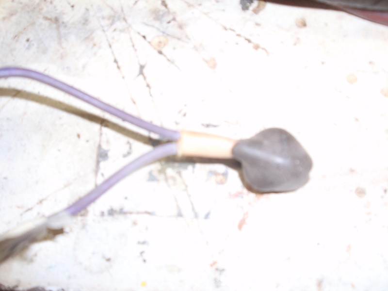

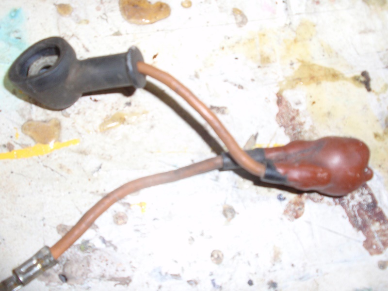

I have two older diodes from previous projects that I'm going to use on my next setup. I'm moving all electric(s), key, choke, etc. to the dash vs the shift lever control box which is broken and missing the pusher buttons and then install a single lever Morse for speed. It's a '70 65hp hydro. I'm setting up a push/pull nav light switch for my shifter and it is working fine. I need to install a diode in the circuit so the engine won't leap forward on shutdown. I know where the diode needs to go but how do I test these things for current flow direction. Can I use an ohm meter?

If you have a decent multimeter, you can check the front-to-back ratio of the diode; it should have a very high resistance in one direction, and a much lower resistance when measuring with the polarity of the test leads swapped.
Here's a website with a much better explanation than I can make:
www.learnabout-electronics.org/diodes_05.php
Some meters even have a "diode test" position, which I imagine might use a bit higher voltage than the "ohms" scale.
My Sears digital VOM has both the "omega" symbol and a symbol for a diode on the same setting, so I presume it's got enough "pep" on that setting to do either.
HTH...........ed
