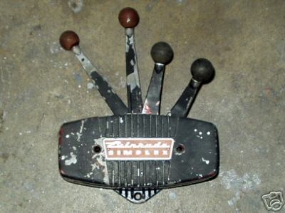

Hello all,
I am looking to rebuild a twin motor controller for a pair of Big Twin 35 Evinrudes.
It is a Evinrude Simplex unit.
I have the housing but I need the correct levers, someone must have lost the original levers and tried to make the three unique to this controller levers.
Any ideas or help would be greatly appreciated !
Thanks,
John

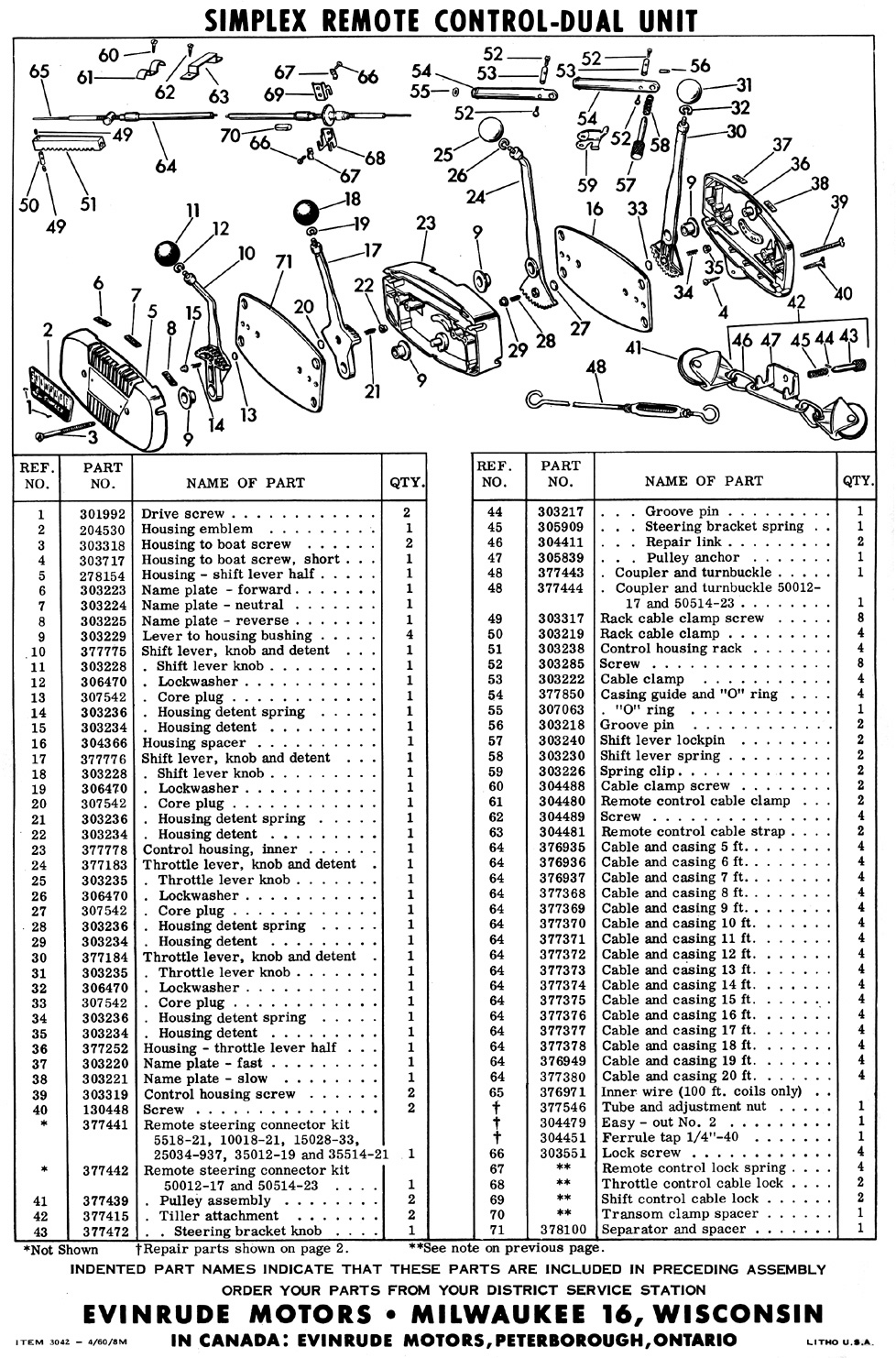

Re:1950's Simplex Twin Motor Controller 11 years 8 months ago #106547
The levers you are after would look like this.
Cheers
Bill
Re:1950's Simplex Twin Motor Controller 11 years 7 months ago #106692
Actually,
As seen in Andy's diagram above, three of the four levers are unique to the twin controller.
Bill's far right lever is not the correct lever for his box.
The only lever shared between the dual and single boxes, is the one closest to your hip.

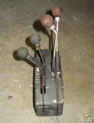

Re:1950's Simplex Twin Motor Controller 11 years 7 months ago #106721
Thanks for pointing that out John, it appears I installed the levers backwards. No problem though, has to come apart soon for the cables. Here's another set I have

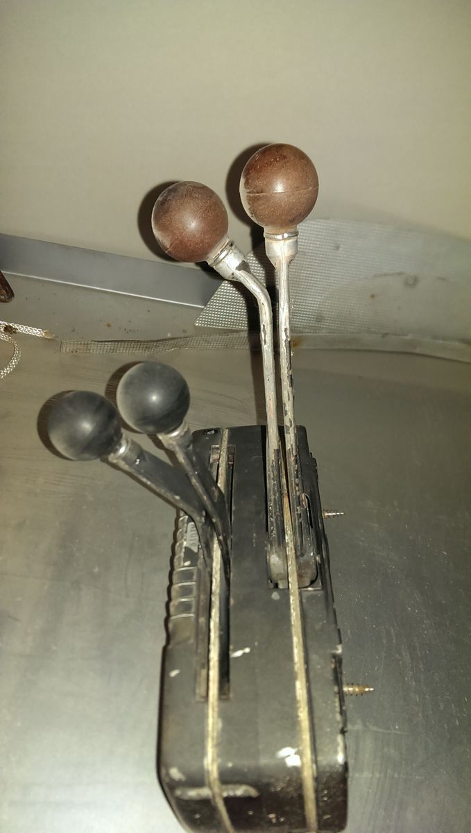

Re:1950's Simplex Twin Motor Controller 10 years 7 months ago #120650
Here's a set I cobbled up from two "single" units.
It's workable for sure, but would LOVE to have an original box......anybody ????
I had to tweak one shifter and one throttle lever so they would pass by each other.
Bill.
