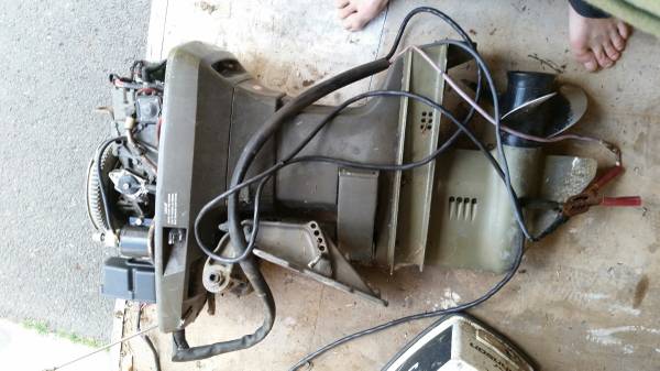

Hi, Scott, I've attached a pic of a 55hp Shortie Johnson Twin for reference. You'll note the short distance from the "horse collar" lower wraparound cowl, to the lower unit. A Shortie Three will be very similar in appearance.

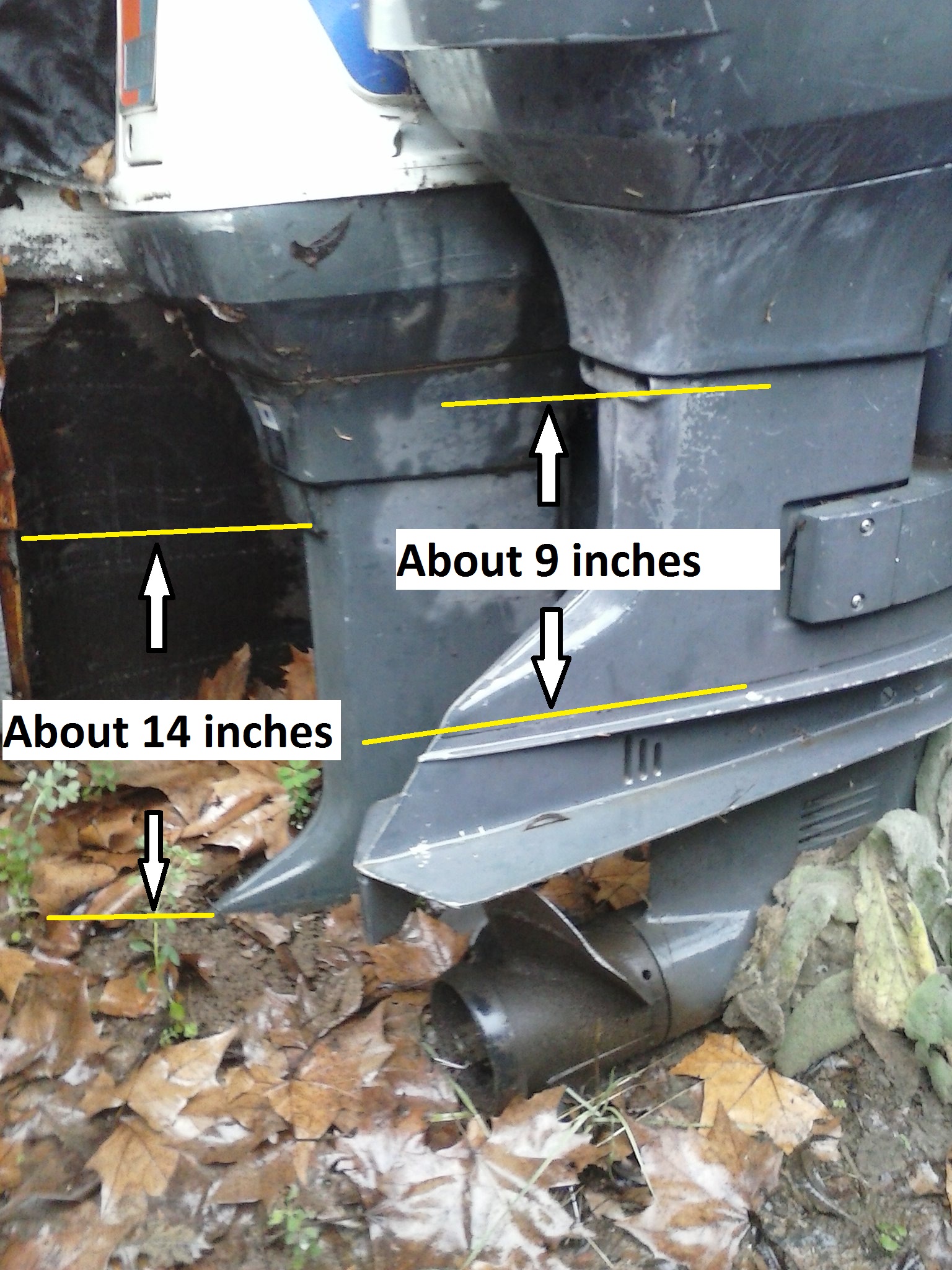

I clicked a photo in the boneyard for you today. Notice the long shaft in the background and the shorty in the foreground. Look at the distance from the exhaust relief ports to the lower unit flange. Also, note that the lower motor mount on the shortie is WAY up on the exhaust tower as compared to the 20" model.

Thanks for all the info. The pictures really help me to visualize short vs long.
