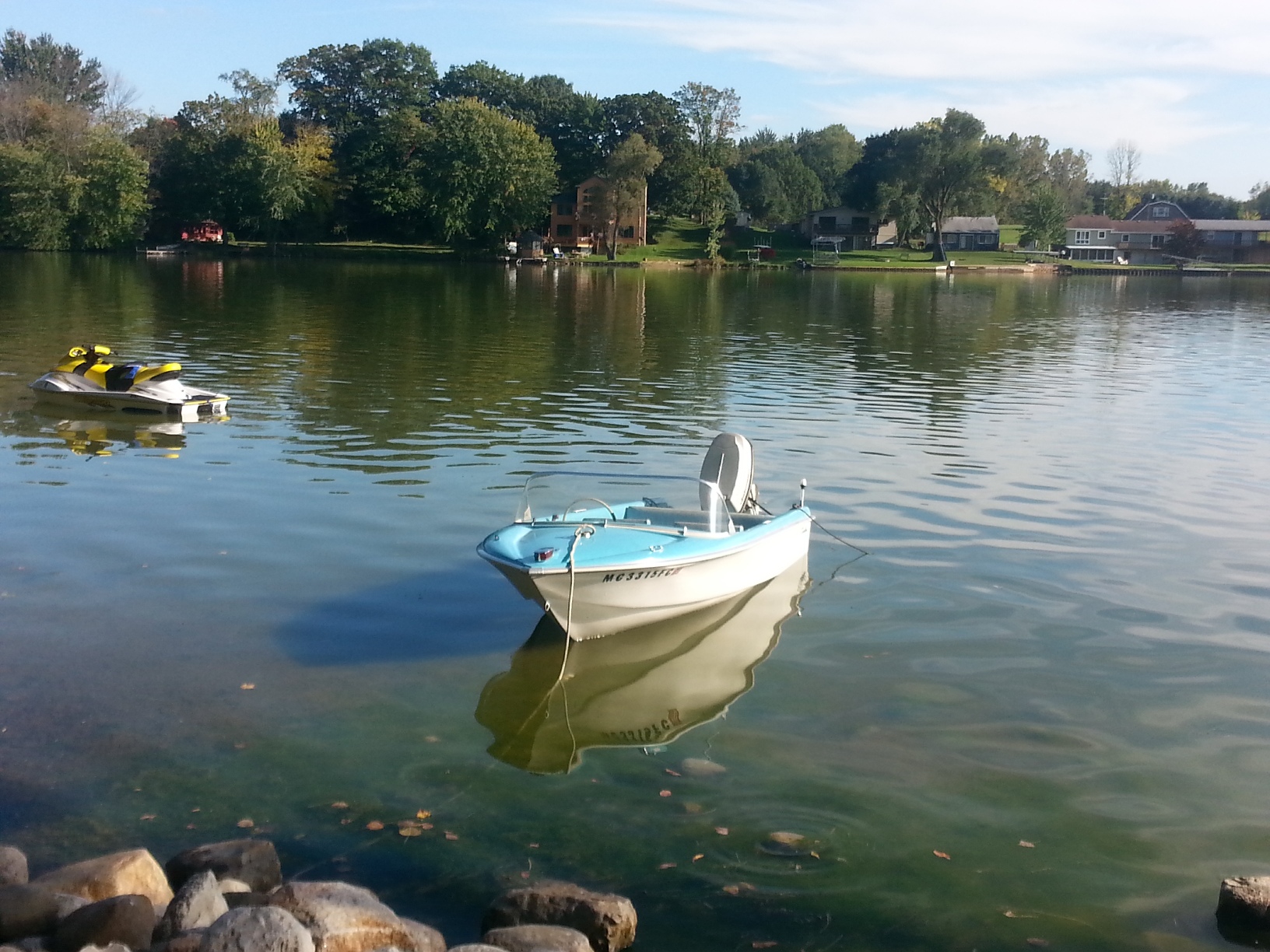

Hi all,
Now that winter has fully set in here I've had some time to think about whether or not I should re-power my boat. The main reason for the re-power is that I would like a bit more performance.
The boat is a 1962 14' crownline, and it is currently powered by a 1962 Johnson 40hp. Currently the boat cruises comfortably with 3 people at about 22-25 mph. With just me and no passengers in the boat I can get up to around 30mph. I would like to gain 5mph or so in both scenarios.
2 seasons ago I completely rebuilt the transom and it is probably stronger than when it left the factory. I am not worried about whether or not it can take a larger motor.
I've been doing some research and I'm kind of undecided what I should do? Currently there is a 1970 60hp evinrude 3cyl. looper for sale that is reasonably priced. Do you guys think that a 60hp would even gain the 5mph or so? I realize that there will be extra weight, it will use more gas, and it will no longer be an original boat motor match.
I would like to hear what you guys think about all of this.
Thanks!
Scott
