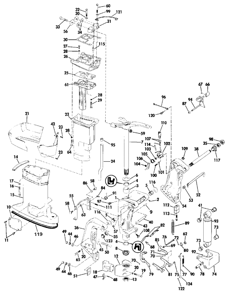

I'm getting ready to swap my Evinrude onto another hull and when disconnecting the wiring and controls first thing I did was drop a small nut down into the front exhaust housing cover. The housing is part #42 in the diagram. The nut was a small stainless steel nylock that secured the shift cable to the linkage. I couldn't duplicate this move if I tried a thousand times. I thought I could just remove the cover and fish out the nut, but...
The cover has 4 horizontal bolts holding it to the rear housing, no problem, but it has two more that go in vertically and the left side one looks almost inaccessible with the powerhead in place. Jeez!
I'm going to replace the impeller before I do the swap, and I'm wondering if it's likely that the nut will just drop down on top of the impeller housing area and be retrievable when I drop the lower unit? Otherwise it's major work to get the cover off. Any ideas? Also, if I just leave that nut loose in there, is it likely to do any damage?

I'd just drop the LU and it should be there somewhere, and don't think be a problem anyway. Done similar too and now I stuff a rag "diaper" under any nut work that can easy fall down that cavity!

Thanks guys. The nut is stainless and a magnet won't pick it up (I tried it on the matching throttle cable nut) and the place where it dropped down in that front cover is so tiny you wouldn't think even the nut would have fit through there. I'll look for it when I drop the L.U.

Norm, been there done that. The last motor I dropped a screw down there I already sold and CRS set in. But I don't recall it being too difficult to get the housing off. You might have to loosen up the lower pan, those are just screws without nuts. When you do get the thing off you will be surprised at what you'll find. Fishing line, snap swivels, an assortment of nuts, bolts, screws washers, clamps and lots of greasy dirt but never the part you are looking for because it probably didn't fall there anyway :laugh:
I think OMC had a chapter in tech training on how to dispose of unwanted sundry items and this is the final resting place for even new unused hardware.

Can't see it at all. The little gap it fell through was exactly big enough to let the nut drop through. At first my biggest concern was that in removing the port side vertical bolt that might also drop down into the lower housing. But the more I think about it, if that happens I'll retrieve both the bolt and the nut when I drop the L.U. That port bolt will need a universal joint socket to remove, and I'll need to get the fuel hose connector out of the way too. One step up and two steps back. :laugh:

No, you will not find the nut when you drop the lower unit. There's no way for it to get into the exhaust housing from up top.
Just remove the lower cover. With a 3/8 socket on a u joint and extension it won't be an use reaching the partially hidden bolt.
