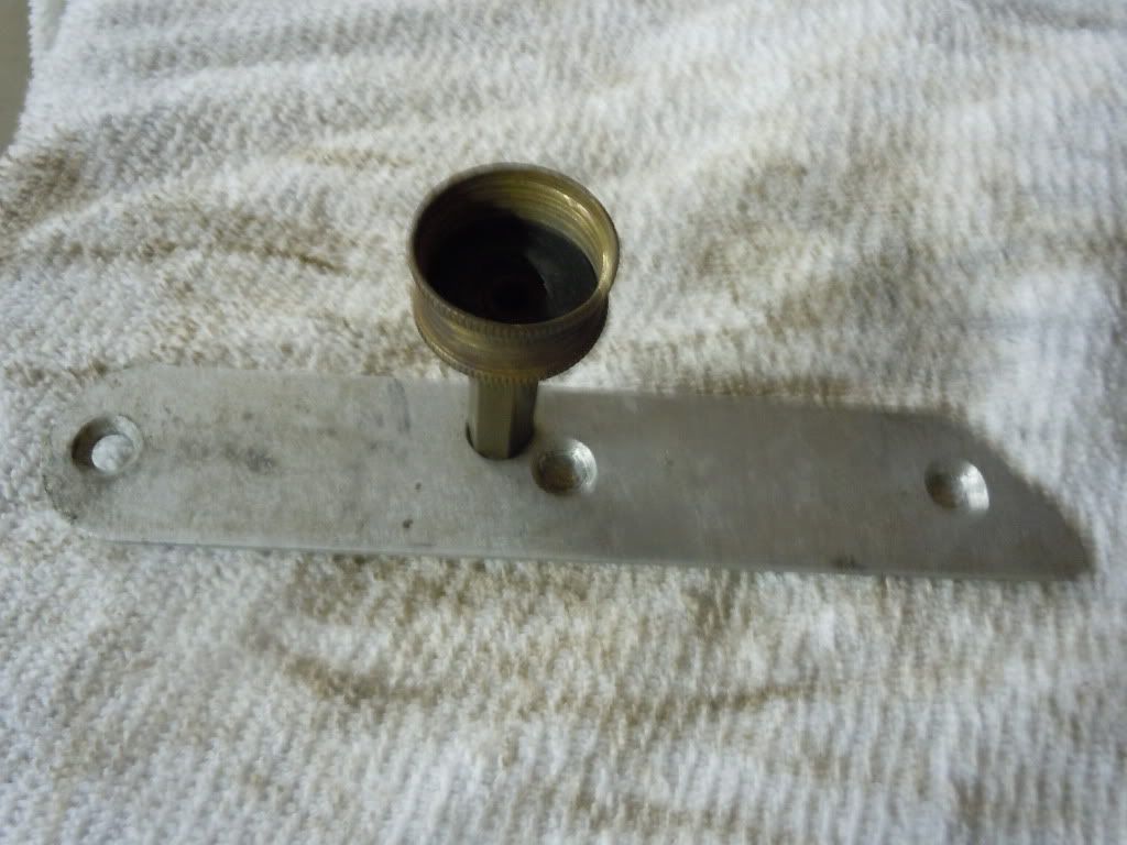

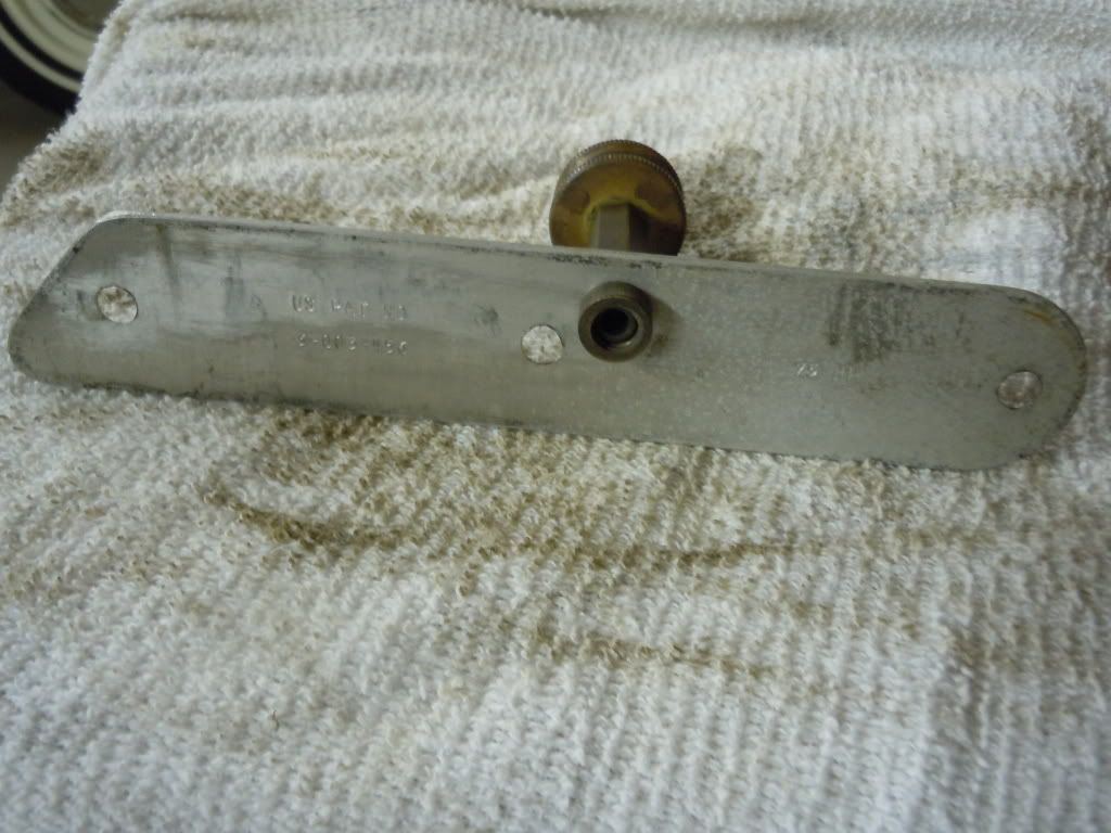

If your motor has the removable side cover with the screen, you can prolly make a flush attachment. Bob(Waterwings) made one for his v-4. Here's a pic of an original one.

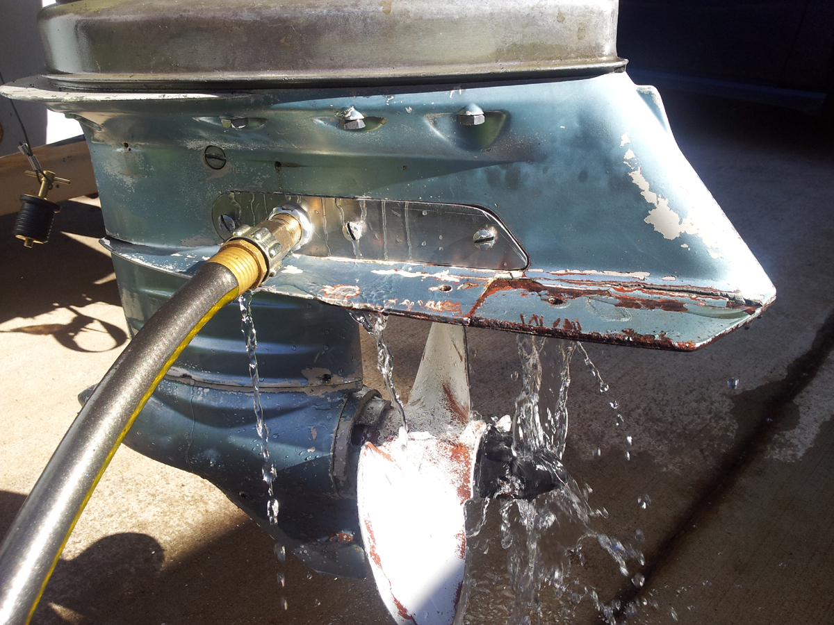

Here is an action shot of the one I made after seeing the one that Bob made.

Re:59 Johnson wtae intake 11 years 11 months ago #102254
Proud member of the \\\\\\\"Raiders of the Schlitz Box\\\\\\\"
Re:59 Johnson wtae intake 11 years 11 months ago #102257
yep....we have one that norm griffin made and gave us a long time ago....works great...john
