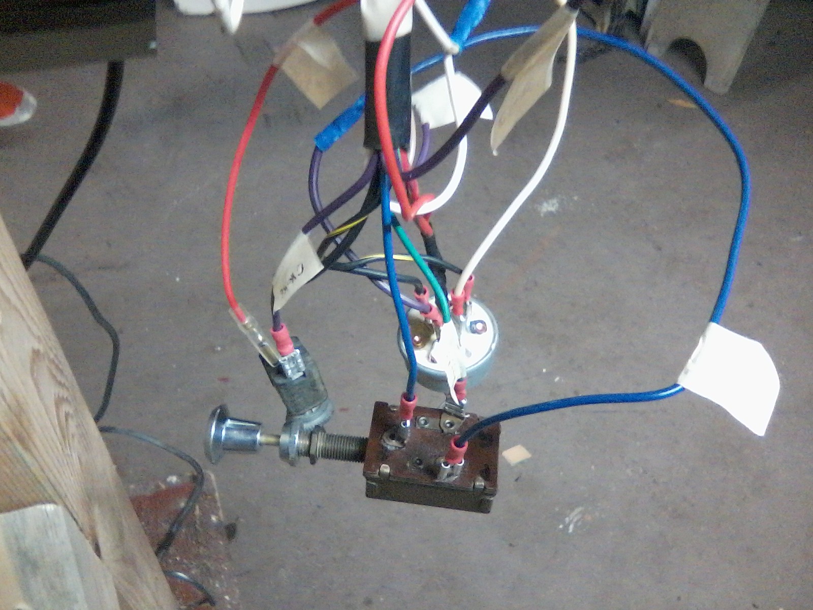

I wired a three way light switch for the shifter. The same switch that is used with navigation lights. The normal "off" position is set as forward (no power), the anchor light position is wired as the neutral (power to green lead) the bow/stern position is wired as reverse (blue/green powered)
Power to the shifter is now supplied by the accessory terminal on the key switch so it cuts out during the start process and this also leads to the sudden forward lurch when shutting down.
The engine block wiring has a diode in the circuit and it's working but I don't know how to wire it into the shift circuit to prevent the forward kick when shutting down. I have two other monkey balls that I can use if necessary.

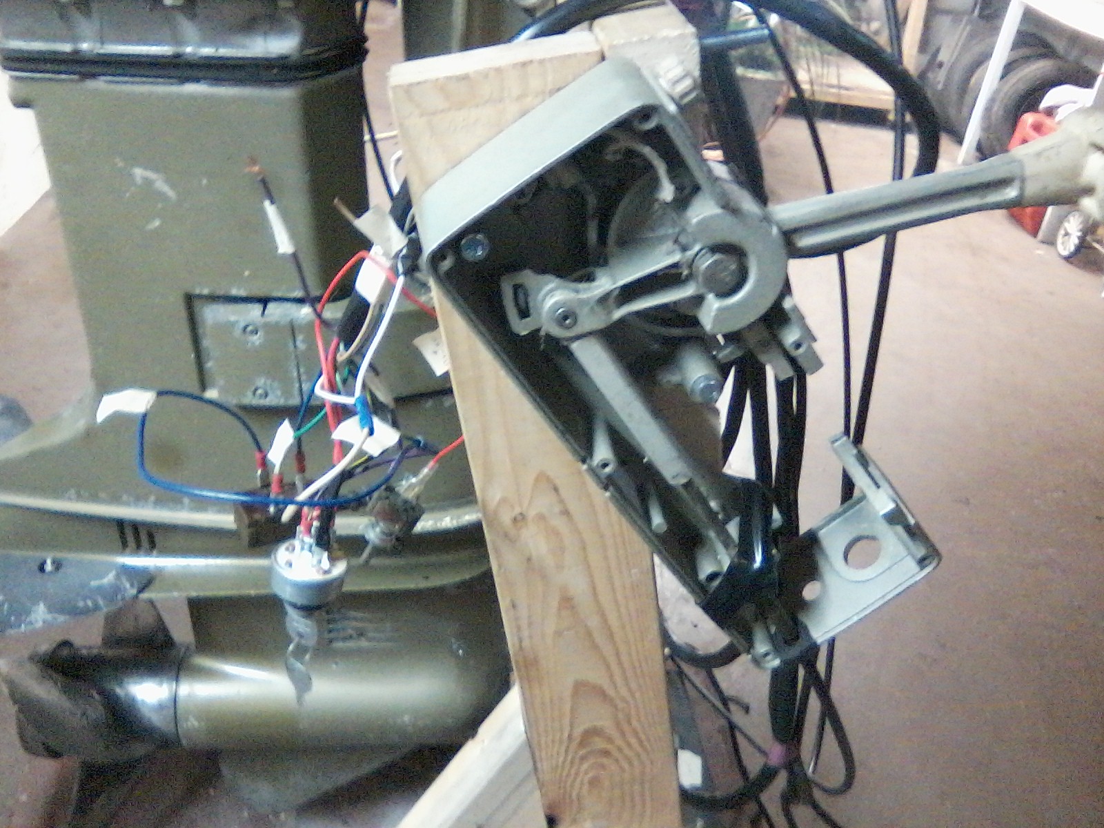

Another eureka moment. Got the timing advance linkage in the mail today and hooked it up. Finished the wiring for shift and ignition, all but the overheat circuit. Pumped in some gas and she fired right up. Only ran it for a few seconds 'cuz I didn't hook up any water, have to install a new impeller anyway. Shifter worked perfect using the navigation light switch.
Temporary wire setup for shift, ignition and choke.
An old remote setup that I will convert to the "new" shift switch and key.
