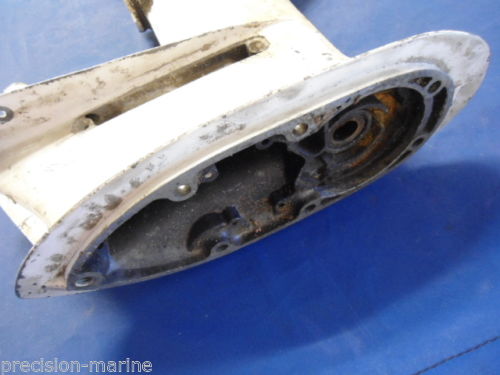

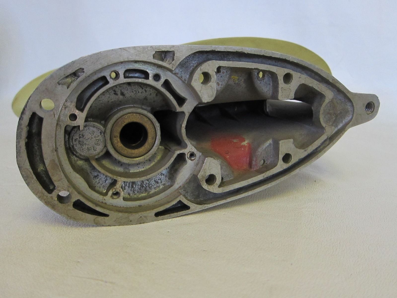

I have a question for the JEGO experts out there... I am looking for a replacement gearcase for my 1958 super seahorse.. and in looking I see two 'internal designs' for the casting around the water impeller... my internals look like the white lower unit picture... but I see a lot of the 'yellow' lower unit pictured advertised as for a 1958 super seahorse, but the casting is different, with the 'channel' running around the edge. Will both work? Or should I stick to my guns and look for one that is shaped like the white photo?

The 'yellow' one.
Re:1958 Super Seahorse lower unit 12 years 2 weeks ago #101673
The early 25 HP motors did not use a water tube for cooling water.
The water went back in those channels to go up into the motor.----You may find that the bolt pattern is different.

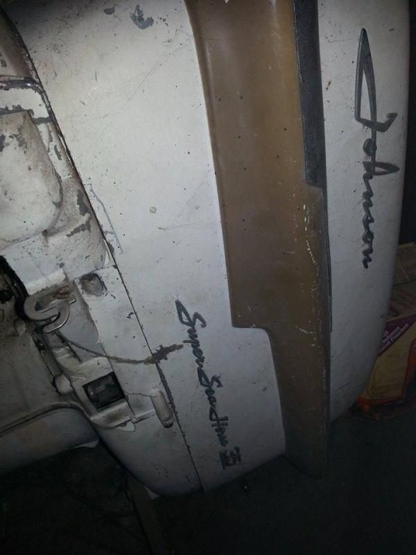

where are you located and how soon are you needing a lower unit.. i have a 58 super seahorse 35hp up in my parents basement that i'll be parting out when i get up to pick it up..motor was rebuilt in 85 and never started.. last time i checked it had locked up from sitting.. so im not messing with it again..

Professor... then I should be holding out for the water tube one like mine... right? Thanks for the info!

did Johnson make a 25 in 58??? the white upper looks like a 35 super quiet...have some of those on the shelf would talk if interested john
