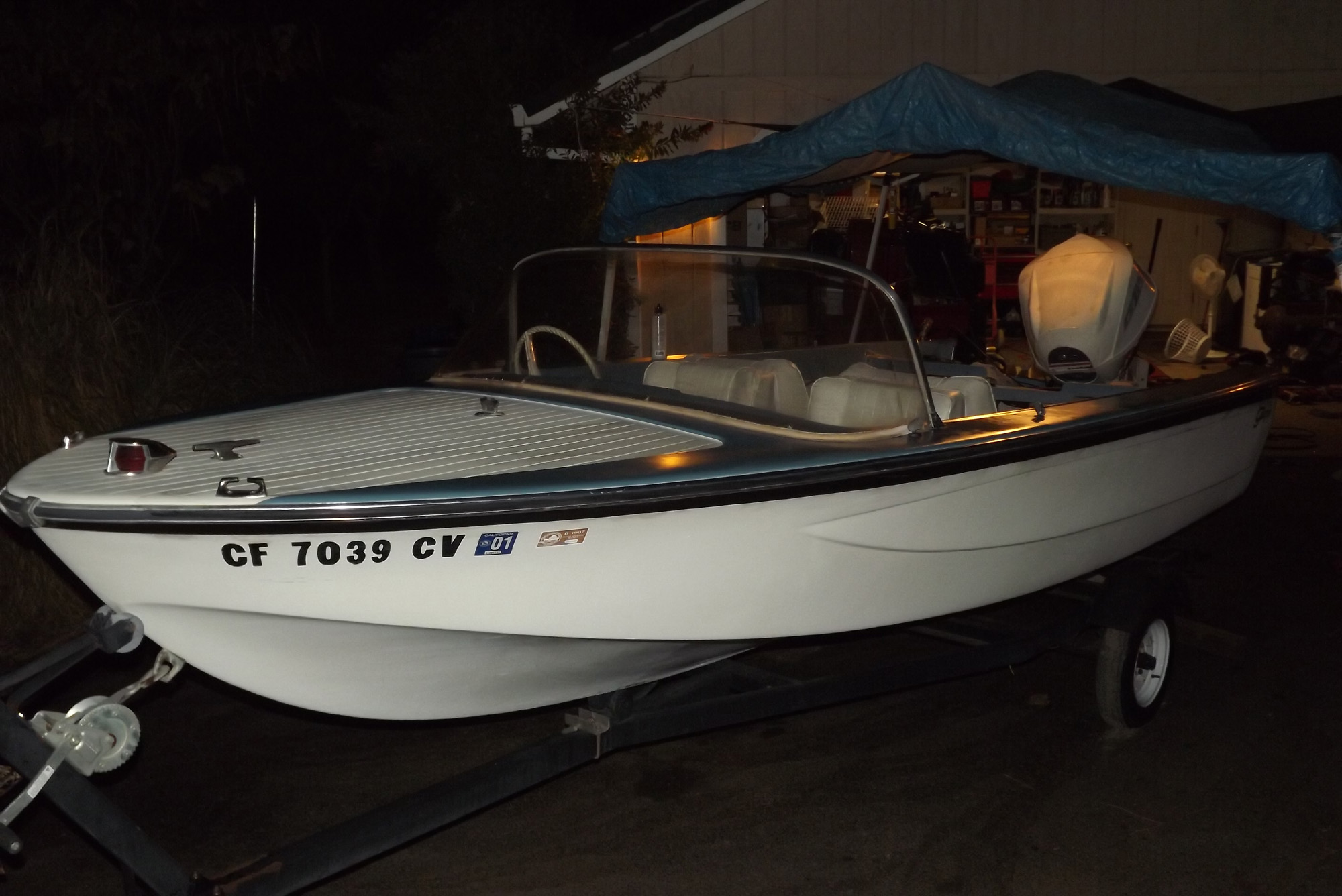

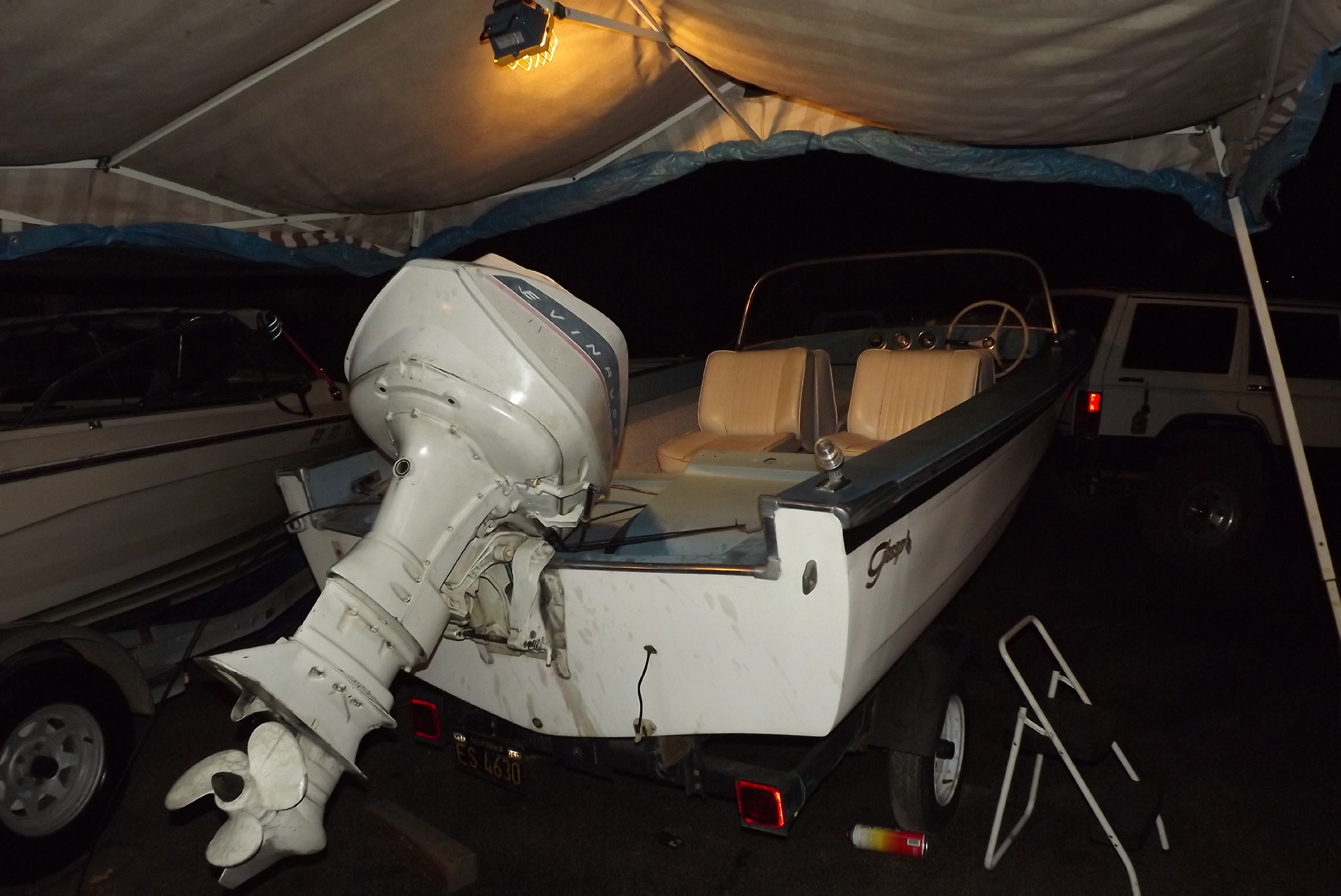

Decided to go a different route with projects so I sold all my boats but I still have the glasspar. Letting the boat go for free or 400 firm with trailer and a 115 hp merc that needs repair. Here is a link to my craigslist ad. stockton.craigslist.org/boa/4903340791.html
Picked this up a few months ago for 100 bucks with no paperwork, boat is out of dmv system and just had to do a lein sale on the trailer, got all that out of the way before finally digging into it.

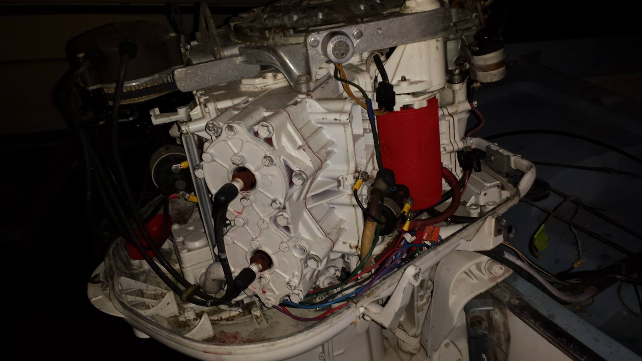

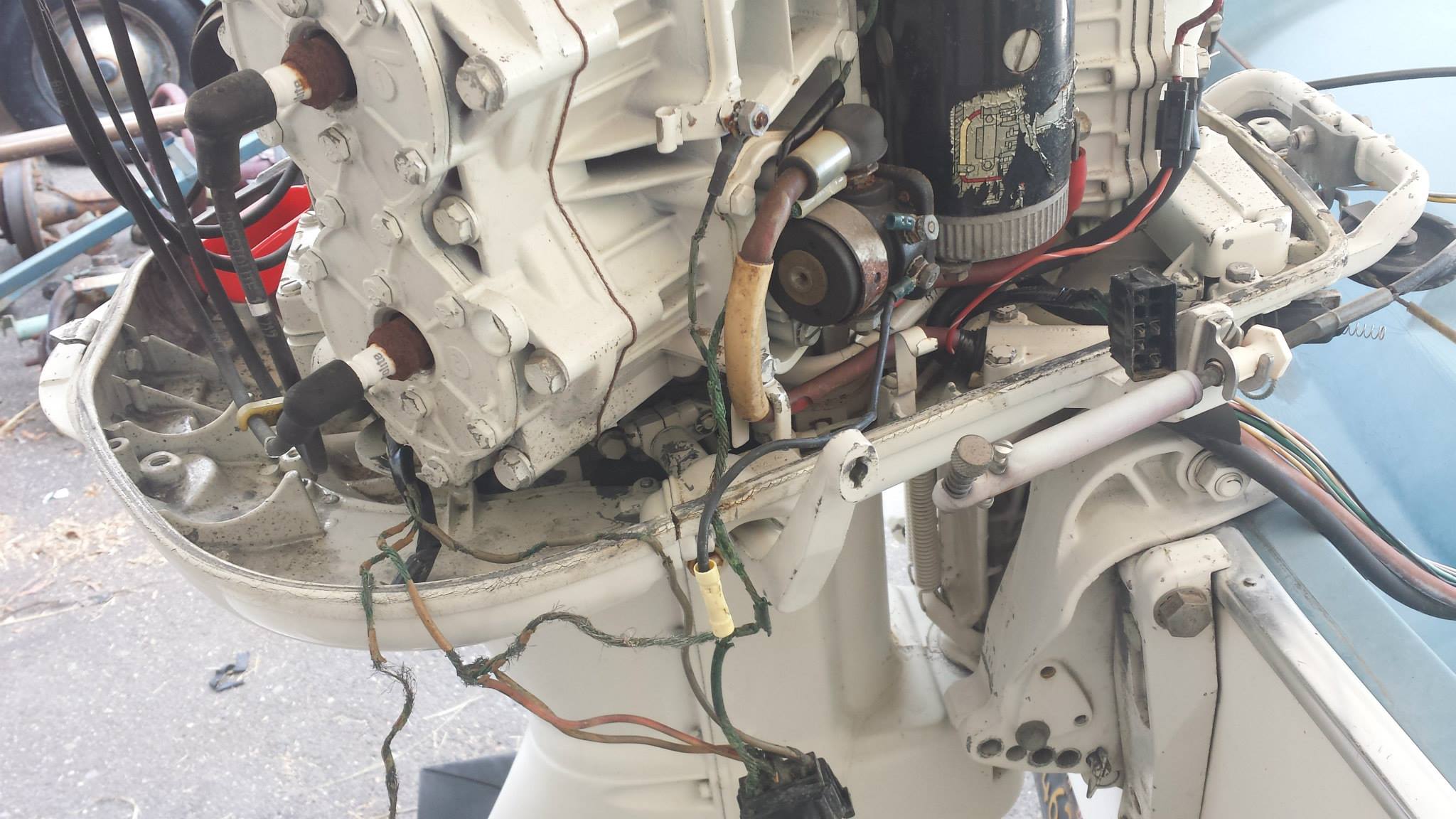

Started with the motor, needed some rewiring,

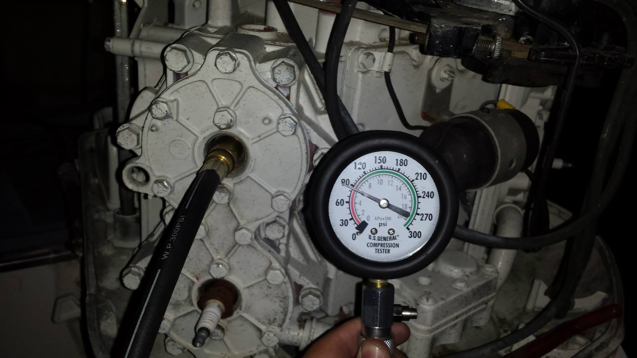

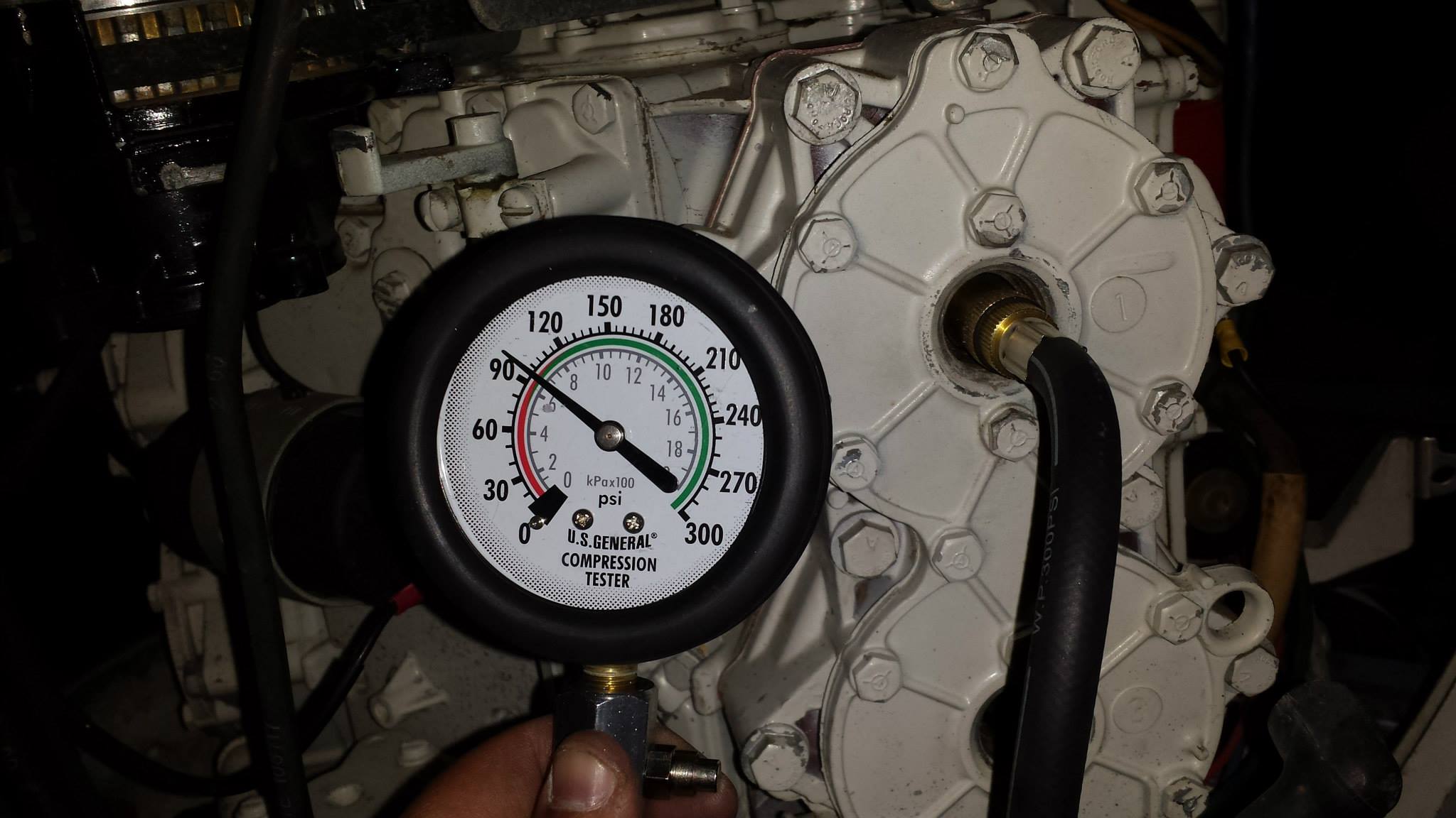

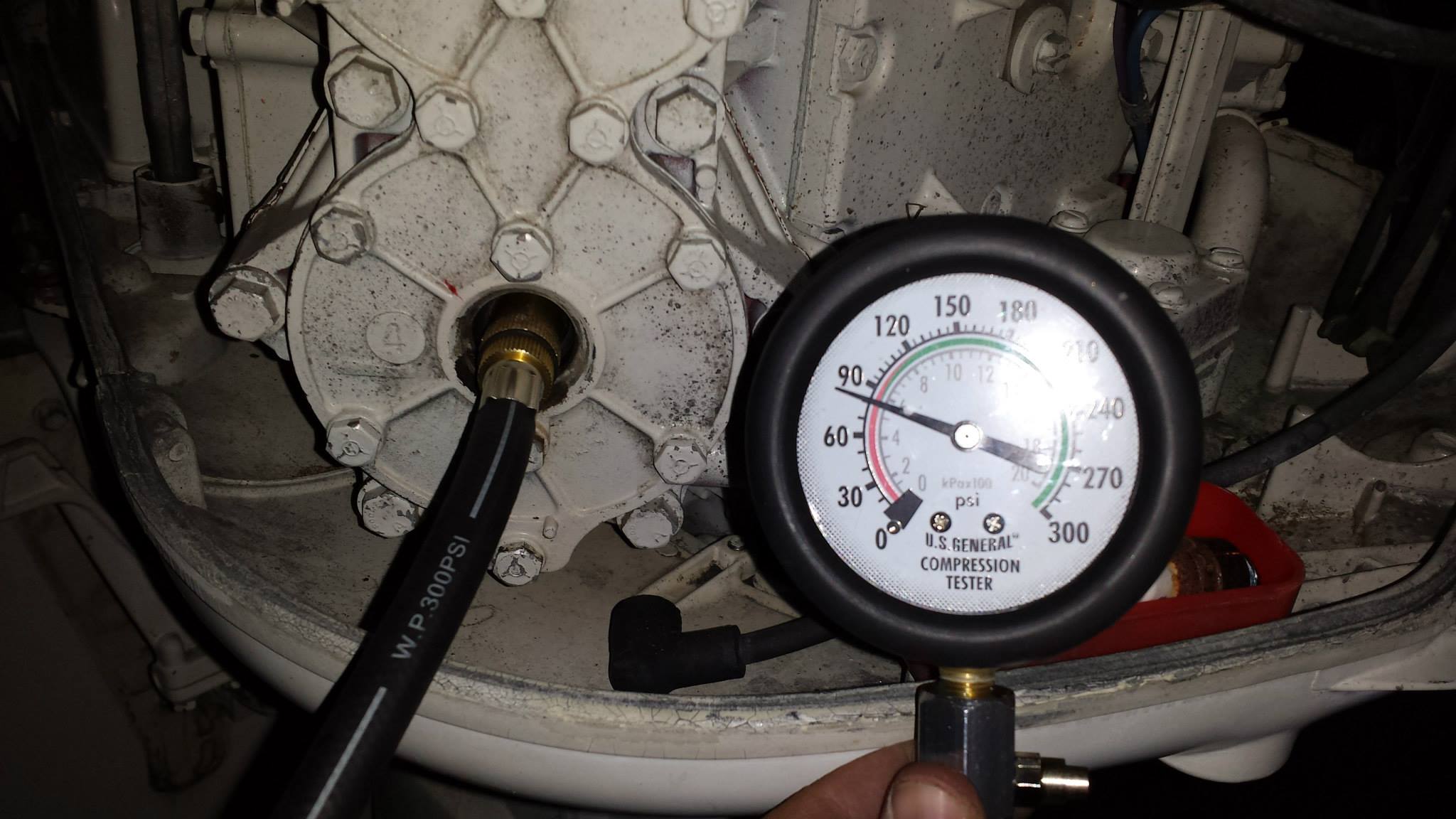

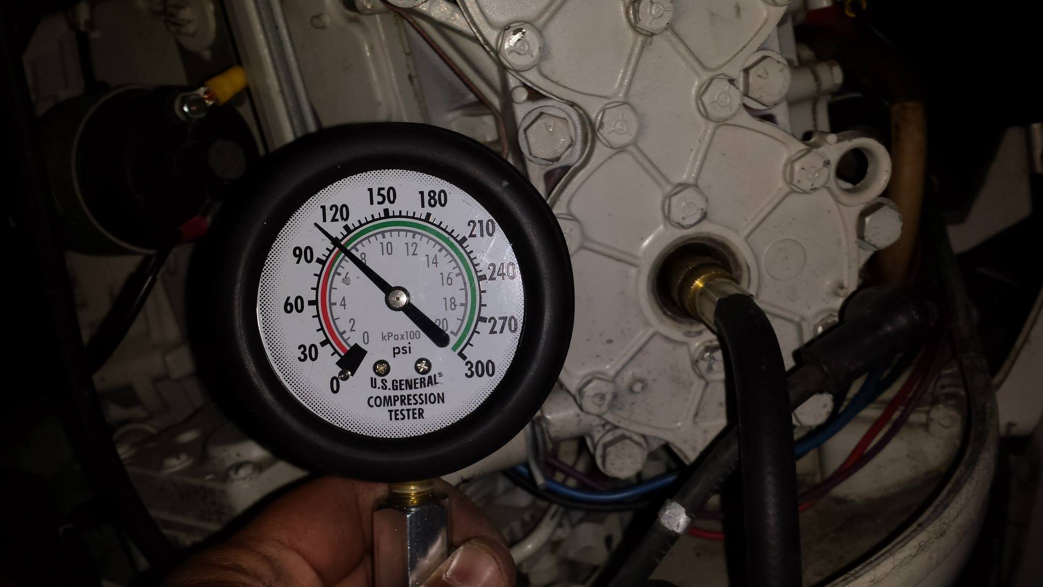

new ignition cylinder, turns over no problem. Dumped a little gas down the carbs to see if it would fire up or have spark, got it running for a couple seconds, so it seemed promising. Then went to check the compression and it was a little scattered, 2 and 4 were a little on the low side, but 1 and 3 were pretty decent, not to bad I guess for a them being dry.
More to come as I make more progress.

Congrats Brandon. Yeah she'll run just fine for now. Once she's running run a few tanks of gas with Seafoam in them and you'll be surprised at the outcome. My Fat Fifty was at 75 and 80 but after a few tanks of gas/seafoam it was at 90 across the board.

Thank you bob! I got a chance to put the engine in a garbage can of water for some testing. Starts up and runs so smooth but won't stay running and I have no throttle response. I have a feeling it has a bad fuel pump diaphragm. It kinda runs the same way as my 64 starflite 90hp when the diaphragm was bad, lol. Good thing I have an extra, haha.

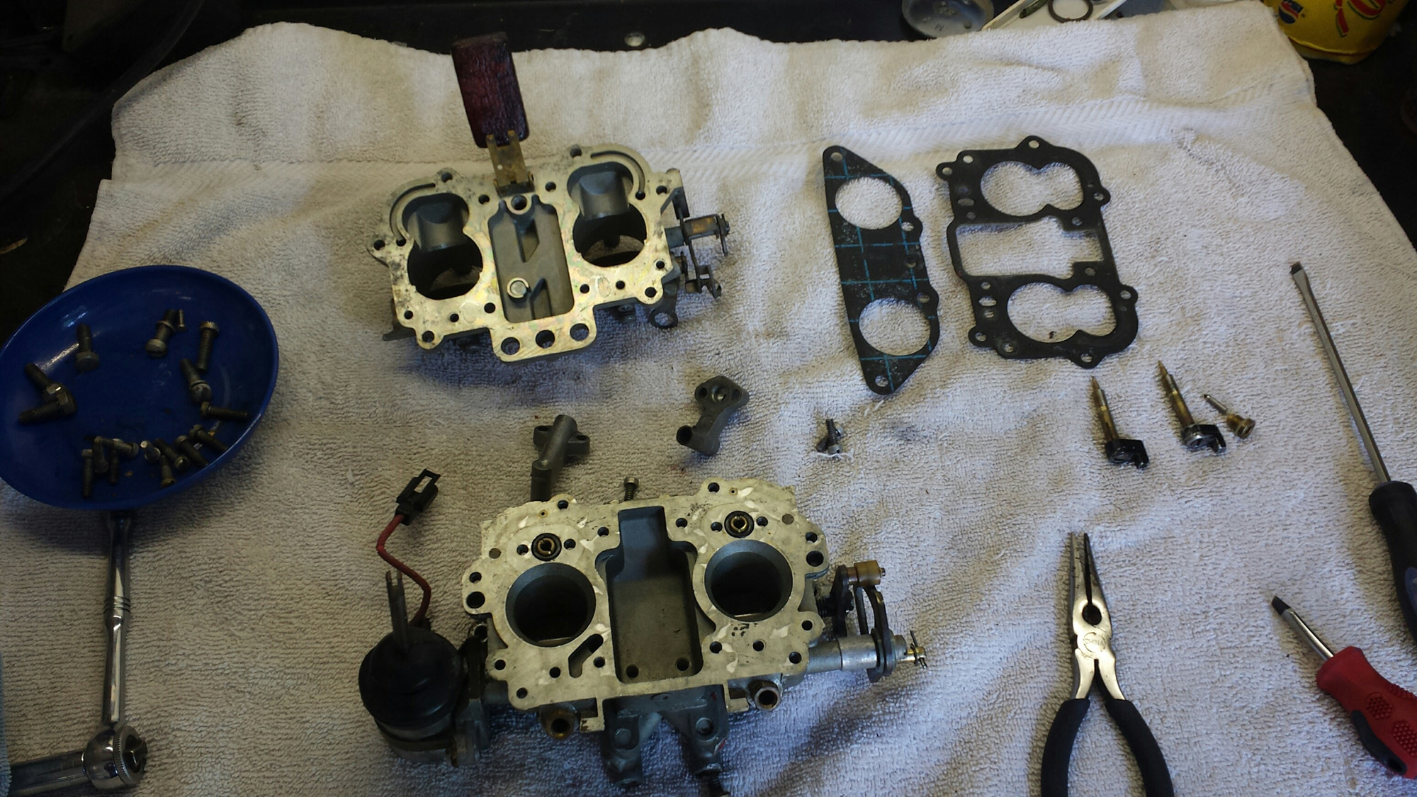

Ok, so I pulled the carb and dismantled it to find out that it must have been resealed before, the gaskets weren't even stuck and peeled off easily and the rubber seals were in good shape too so I just flipped them over. There where a few clogged ports so sprayed carb clean shot it with the air compressor through all the ports. Cleaned it all up and put it back together. Put new hoses on also. Fired it up and seems to have throttle response now and much better idling. But there is one concern I have, it went through 2 gallons of gas way to fast. And even though I do have throttle response it seems like it bogs down, I have to slowly give it throttle for it rev.
Does anyone know how to adjust this or lean it out? It has adjustment for idle and that's all I see. lol.

It only has low speed adjustable jets, the high speed are preset. Turn the needle valves all the way, until they bottom out but don't force them. Turn the 1 1/2 turns out and start from there. The barrel will get you close but the real final tweak is on the water. You'll need someone to drive her while you tweak the carb.

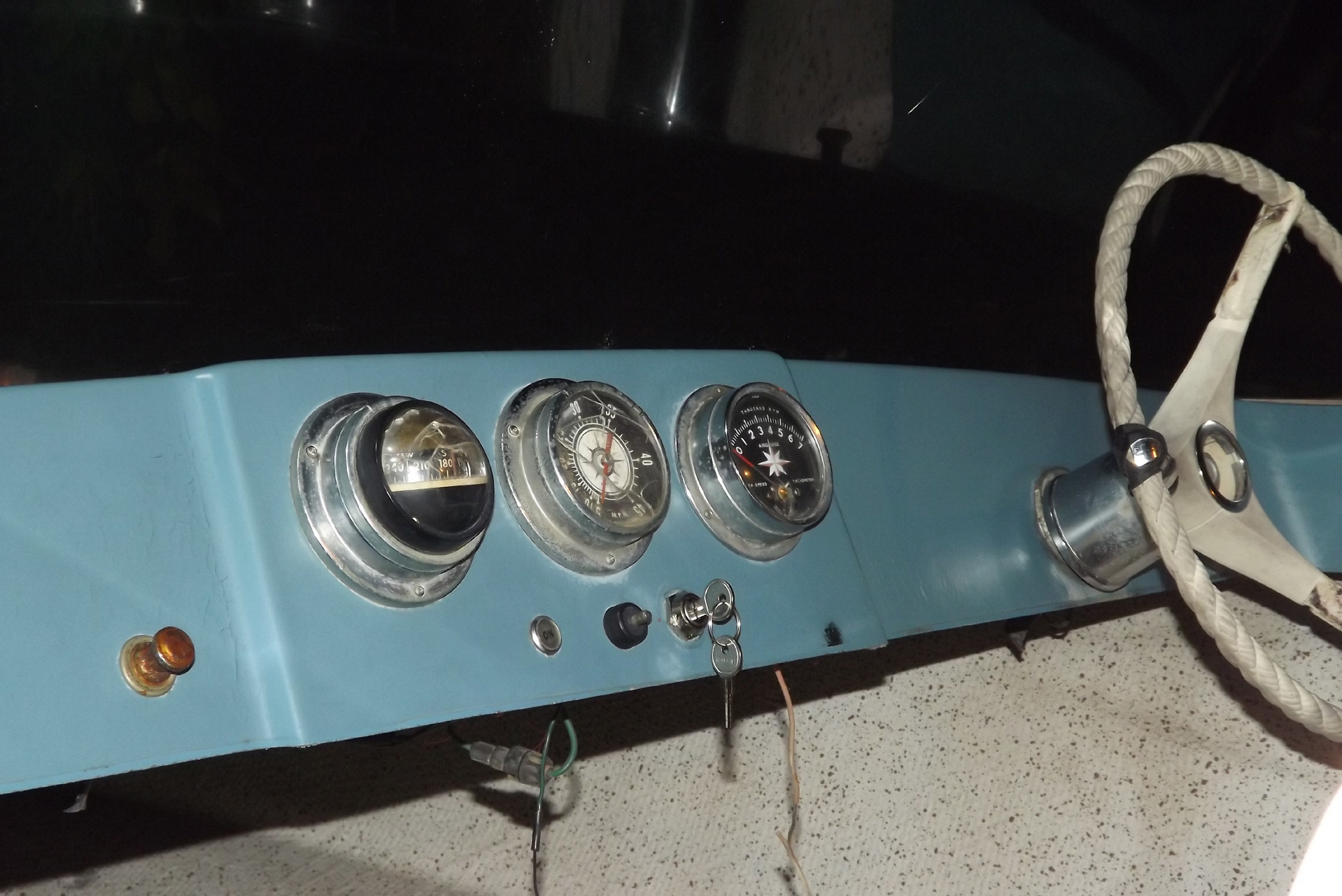

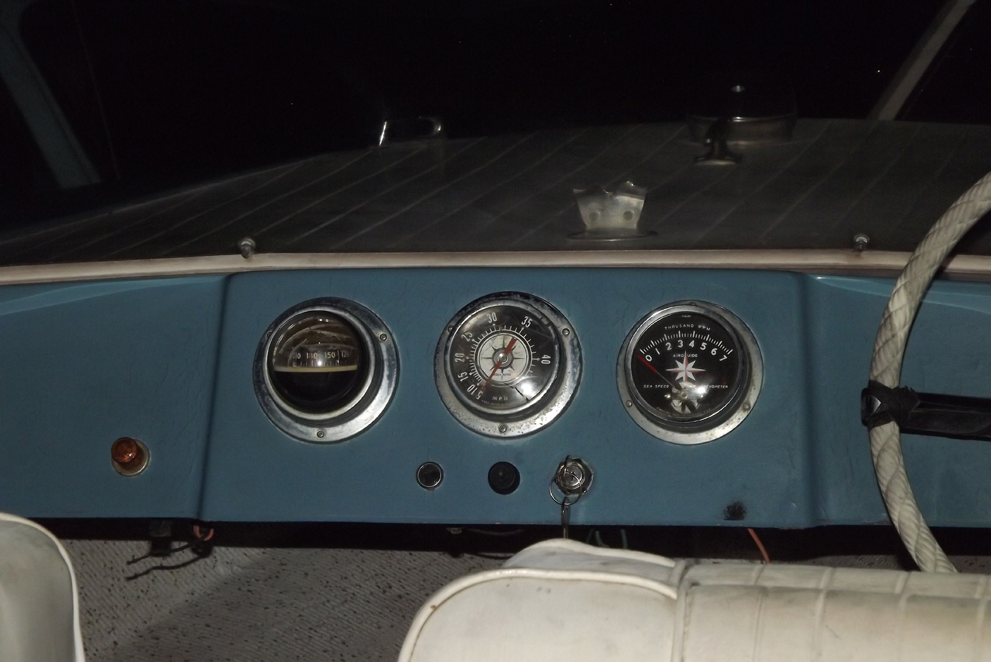

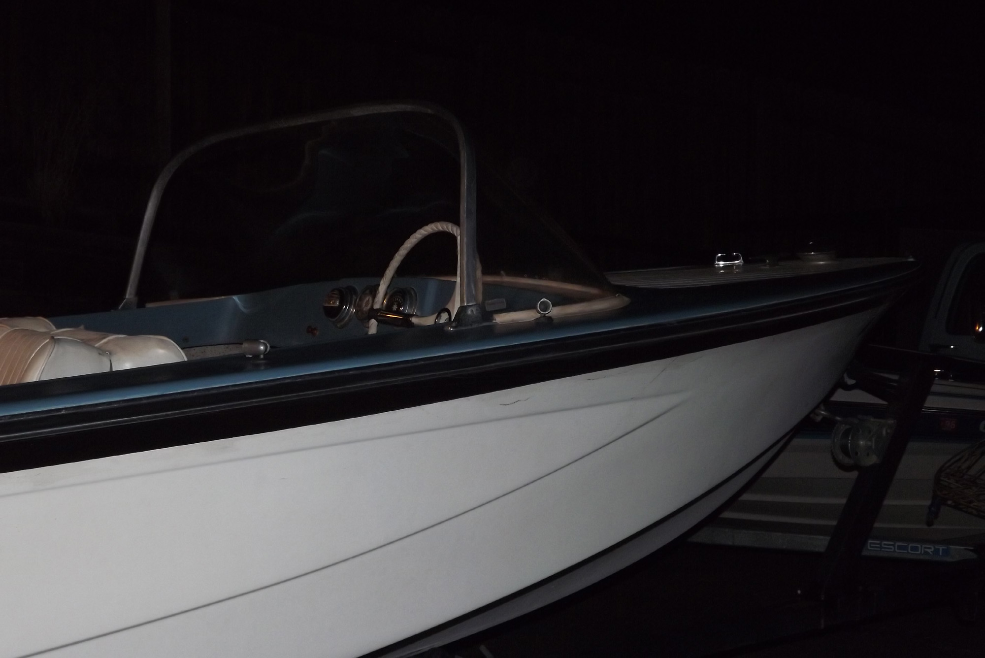

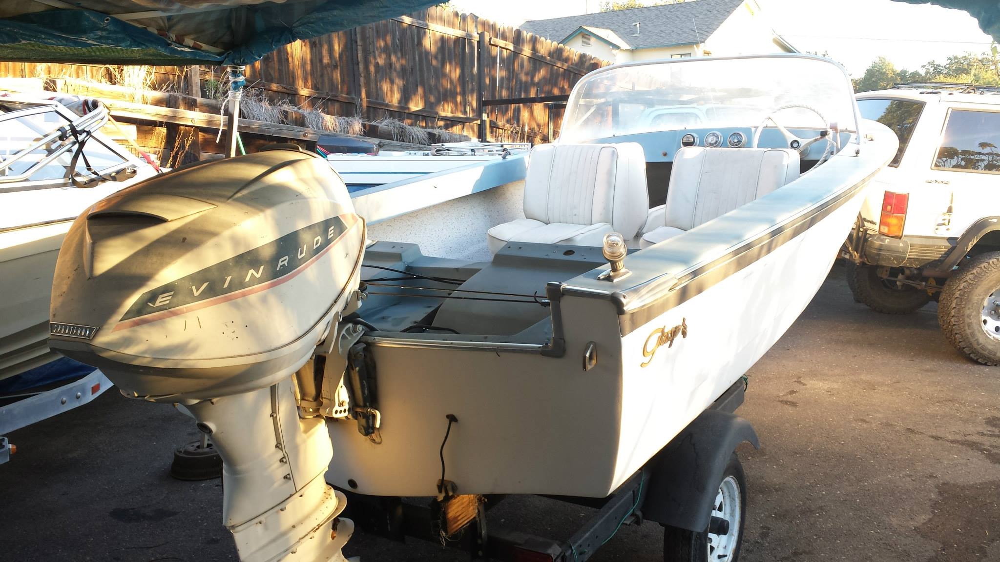

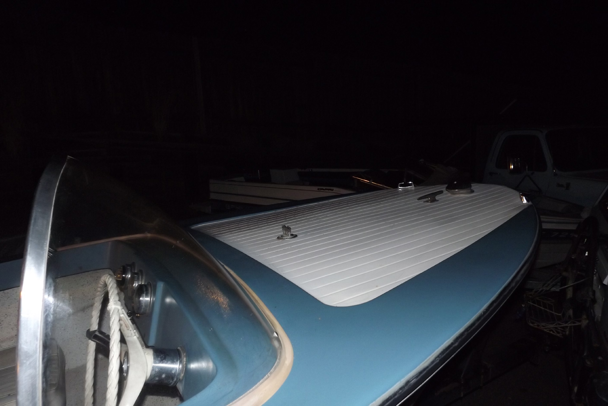

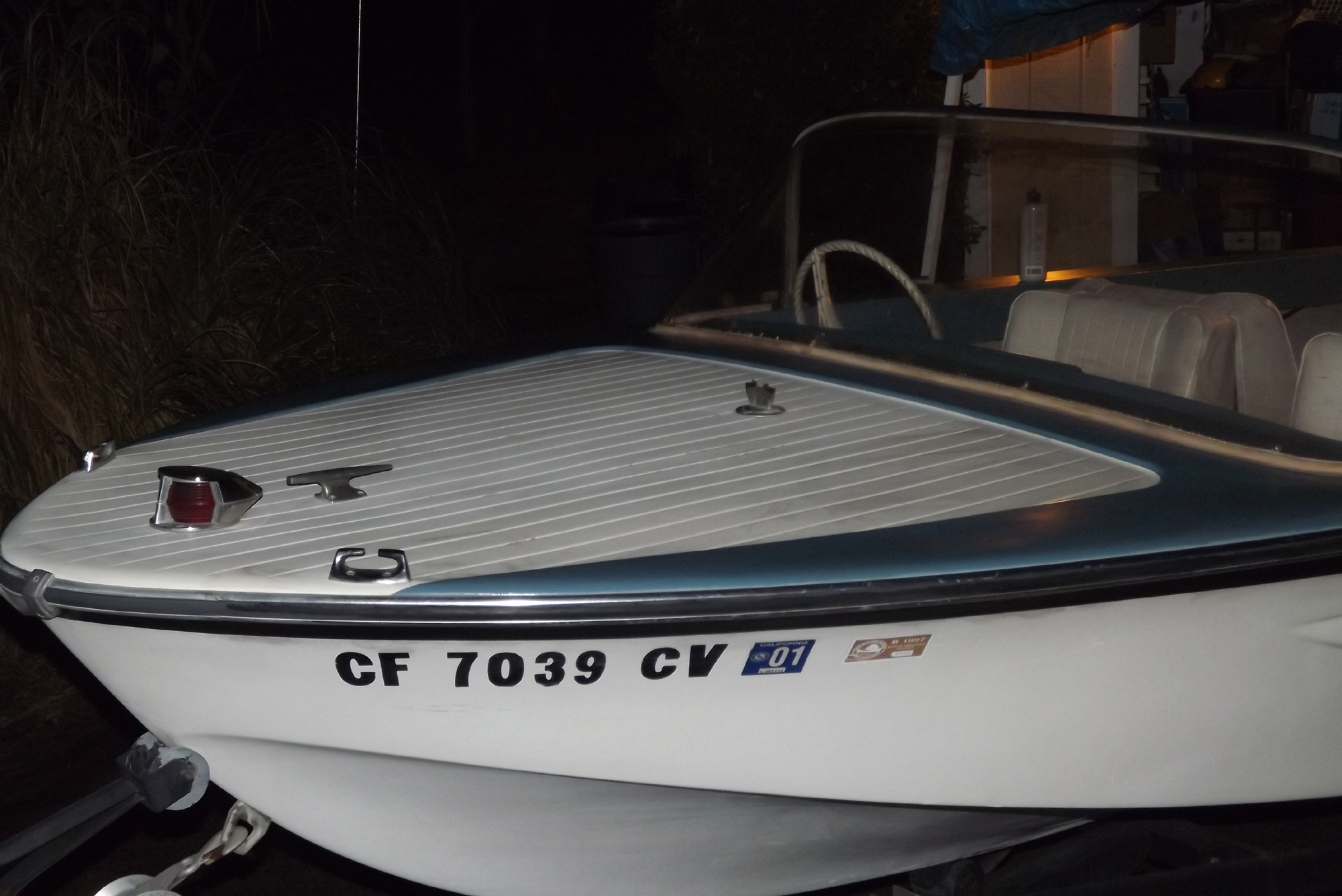

Pictures pictures pictures. Still have a long way to go but thought I'd see how it looked a little cleaned up.
Not sure if these gauges will ever work again but I'm sure gona try to use them.
Still got to mount the motor, transom seems to be in good shape, need to pick up some new nuts and bolts.
