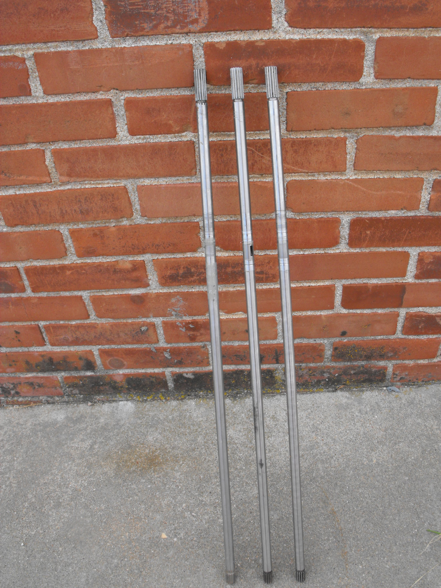

can these shafts be repaired or would they make better prybars???

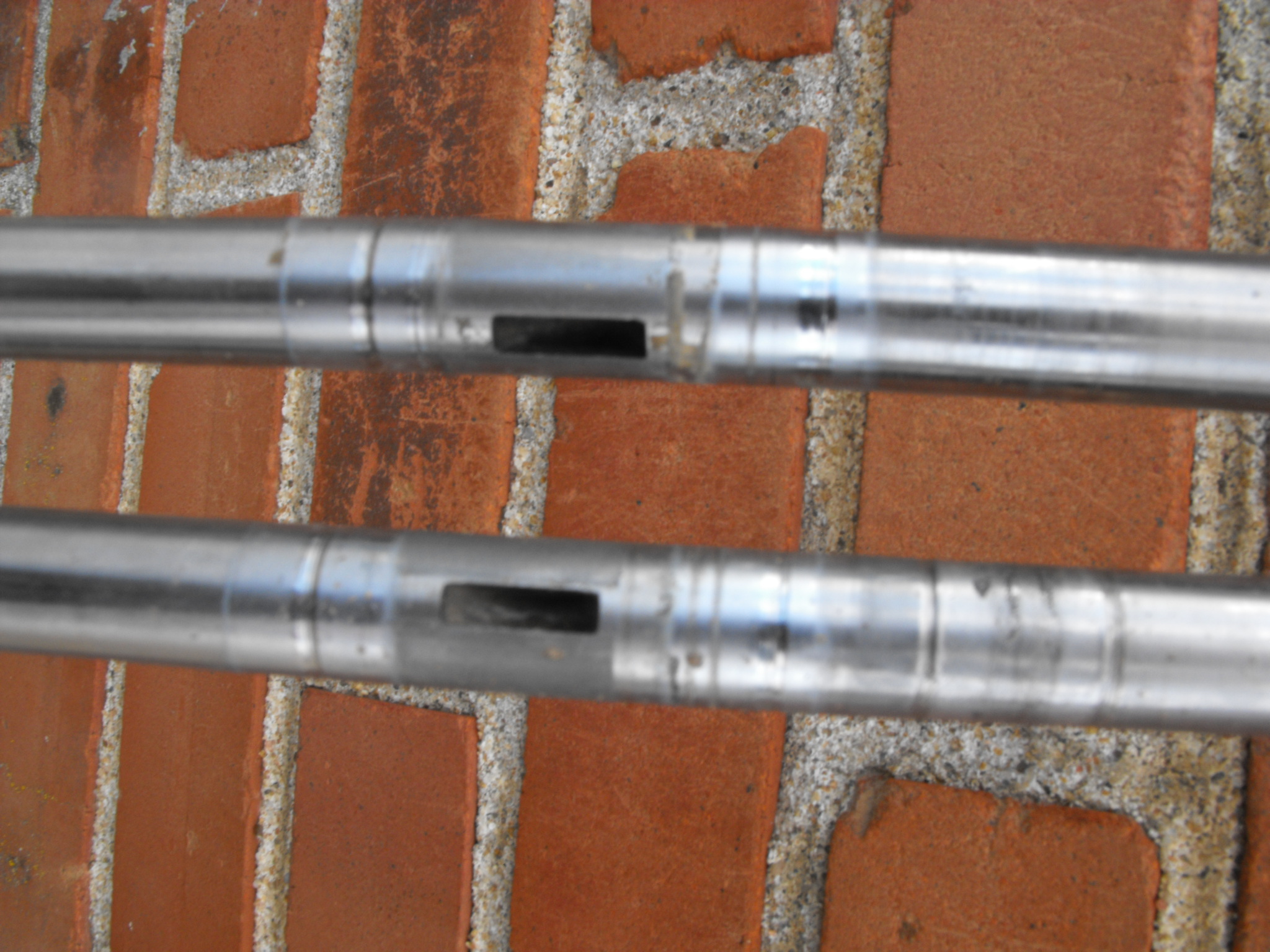

red, I think I would look for better shafts, looks like a lot of seal groove wear. what year of motor are they from. frog. aaaarrr
Re:evinrude 35/40 longshaft 12 years 1 month ago #101123
hi greg....one is from a 1960...don't know about the other 2....just cleaning up and reorganizing stuff if they can be repaired i'll keep em...if not i'll make beatin bars out of em....thanks john
Re:evinrude 35/40 longshaft 12 years 1 month ago #101129
I saw a YouTube video where someone put a speedi-sleeve on a worn shaft.
I ran into than at an Antique Outboard club meeting and asked how it had worked out, and they said fine....
Here it is:
Re:evinrude 35/40 longshaft 12 years 1 month ago #101144
cool...thanks....guess they'll go back on the shelf...thanks john
