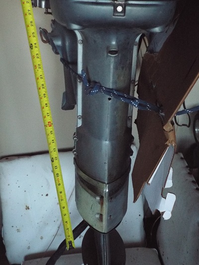

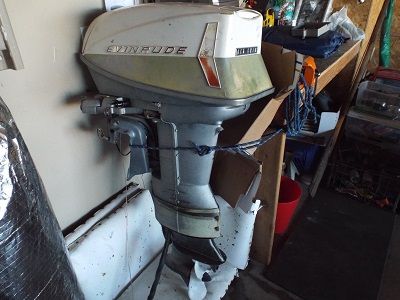

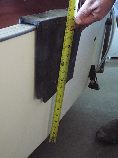

I own a 14 ft 1962 SeaSwirl P-14. It has a 17 inch transom. the boat motor from where it mounts to the boat down to the skig right before the propeller is where I believe I get my measurement from and it seems to me that it's too long and it needs that 5 inch spacer to be removed. Curious how that's done and what parts I need. The Boat motor is an Evinrude Big Twin. I was told it's a 40 horse. Cannot find the serial number to confirm that. So by looking at the pictures, can anyone tell me about what year it is and possibly what I have? Thank you!
Update: now know what motor I have, has anyone done this conversion or what parts to start pulling off to get it ready for instance drive shaft water pump I don't know what to pull off to get at those parts
Re: Evinrude Big Twin long to short shaft conversion 12 years 1 month ago #100848
hi Jason...looks like you are measuring correctly...you should find a "freeze" plug on the top of your power head that has the nombers stamped in it....will let you look up the year and hp....you will need a drive shaft and a short shift connector (brass thing inside the exhaust housing)...water tubes may have an extention that comes off or you could cut them....good time to change the waterpump impellor....good luck john

Thanks John I found the numbers on the freeze plug and on the top bracket that attaches to the transom 1963 Big Twin 40 Horse so now its a parts hunt.

sorry....forgot, there's a long bolt at the rear (holds lower unit on) that will need to be 5" shorter also...be sure to check new drive shaft as they get tore up a lot where the waterpump/bearing go....think I'm trading for a not running 40....if I do and you are not in a hurry, might have the parts, john
