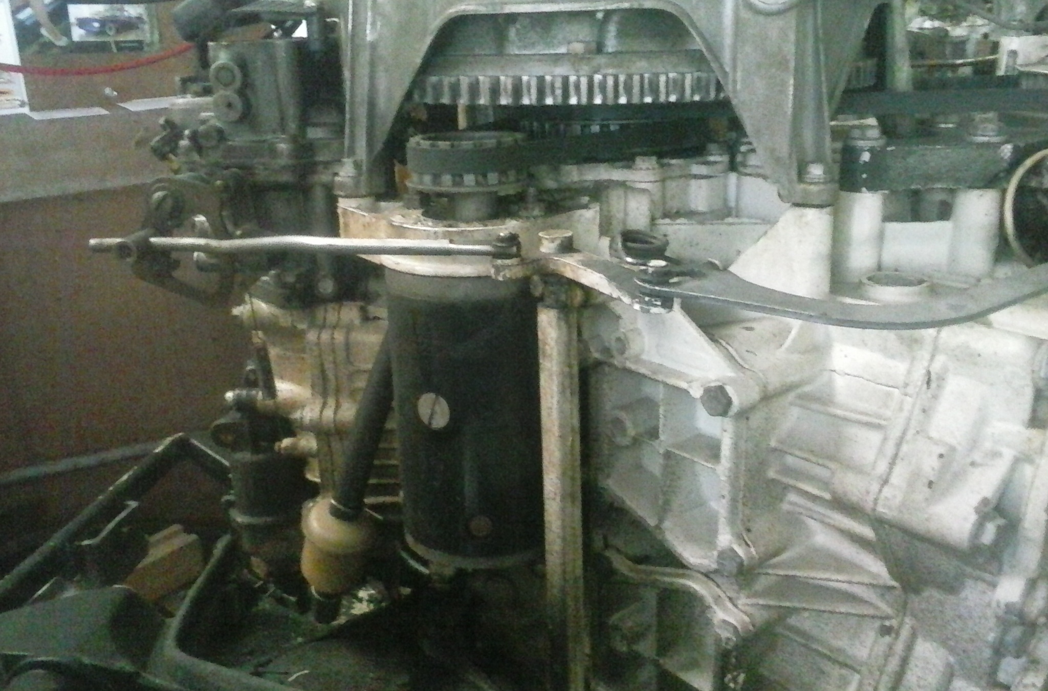

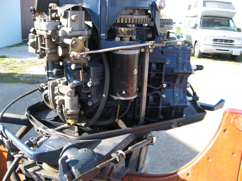

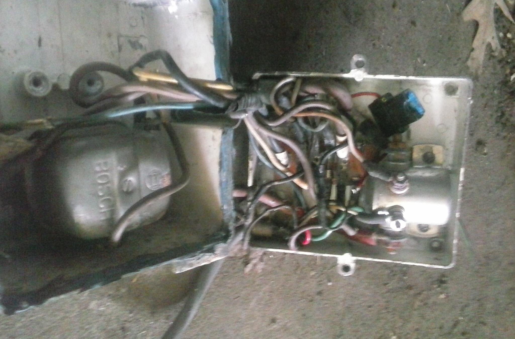

Here's how the generator mounts on the Fat Fifty. This is a '58.

Ah ha. I figured it would be something like that. To get one installed on my 75, I would have to add that pully under the fly wheel.

Re:59 Johnson 75 hp Super Seahorse questions 12 years 3 weeks ago #101484
Hey Guy, thanks for posting that pic. I always wonder why Johnson's had that extra bracket, I thought it was a different starter option or for duel starters. Matt

The Generator was a very expensive option on these motors, and it's output was feeble: maybe 6 amps. The distributor belt pulley under the flywheel is designed to accommodate a 2nd "piggyback" pulley for the generator drive. The generator drive pulley is held fastened to the timing pulley with 3 special pan-head screws.
Most people don't realize it, but these are DC Generators with field coils. In order for the generator to work, it must be connected to a special regulator box that controls the field coil windings. The regulator was built into a special "tall" cover the for the engine relay or switch box. These can be very difficult to find in working condition. Also, be prepartd to pay a Kings Ransom for the drive belt - which is different that the distributor belt (if memory serves me correctly)
On the cylinder that seems to be cold - pull the spark plug and look at it. Is it firing at all? Is it wet with fuel? If the plug appears dry - the reeds are likely stuck closed - glued to the reed block by old gummy fuel deposits. Swap out the sparkplug with one from another cylinder and see if the "dead " cylinder moves with the plug. Also - do a compression check on all 4 cylinders. New, these engines pushed between 90-105 PSI compression cranking pressure. Worn engines may have 70-80 pounds compression (which is pretty average for these) Contrary to what you might read or hear - these engines will run fine on 70PSI compression. They won't be race engines, but the pistons are so huge, and it burns so much fuel that the engine will still have most of it's original horsepower.

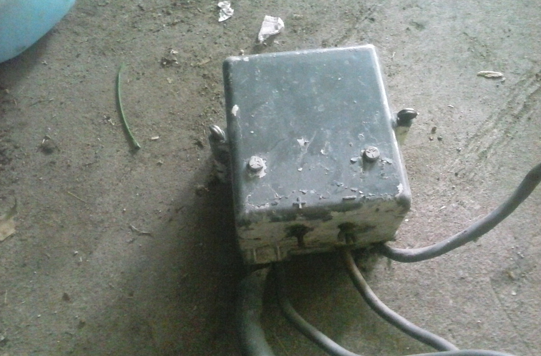

In the lower corner of this photo you can see the original voltage regulator box. That's what it looks like. I guess they're hard to find. Sorry it's not a better picture.
Verne
I also looked up the specs on the optional generator. It says it can provide up to 10 amps.

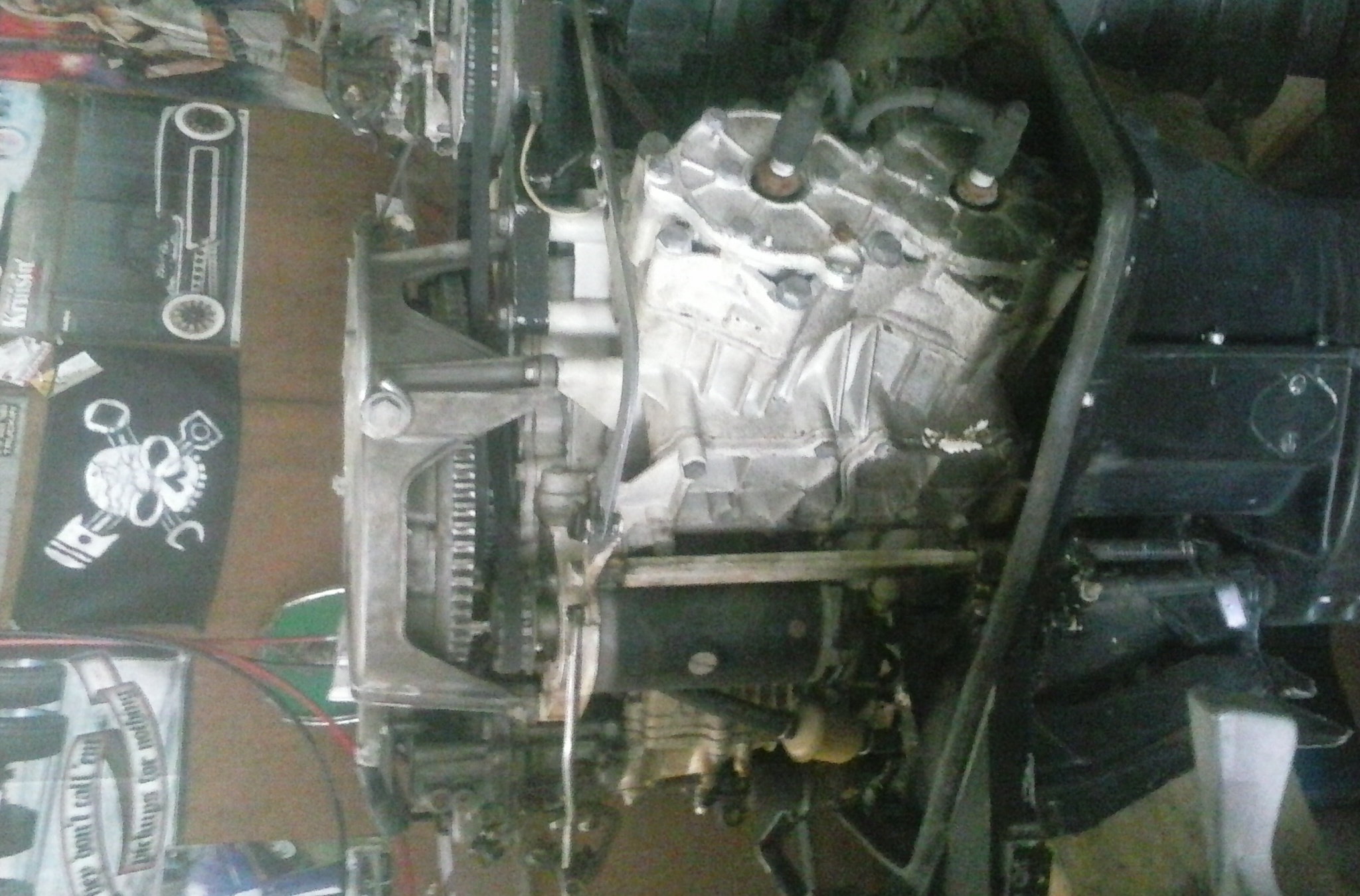

I just picked up a 1961 gale 60 hp, got her a few weeks ago. I don't see anything diffrent in the voltage regulatur box.
Im pretty sure a later model flywheel and stator would bolt right on. Say like a 66,67 the regulatur is mounted under the hood as well. Nope nevermind, you'd have to change the destributor as well(not worth messing with) but those later motors will charge your battery!

I don't know why my photo went away. I always have trouble with photos on this site. Trying again.
