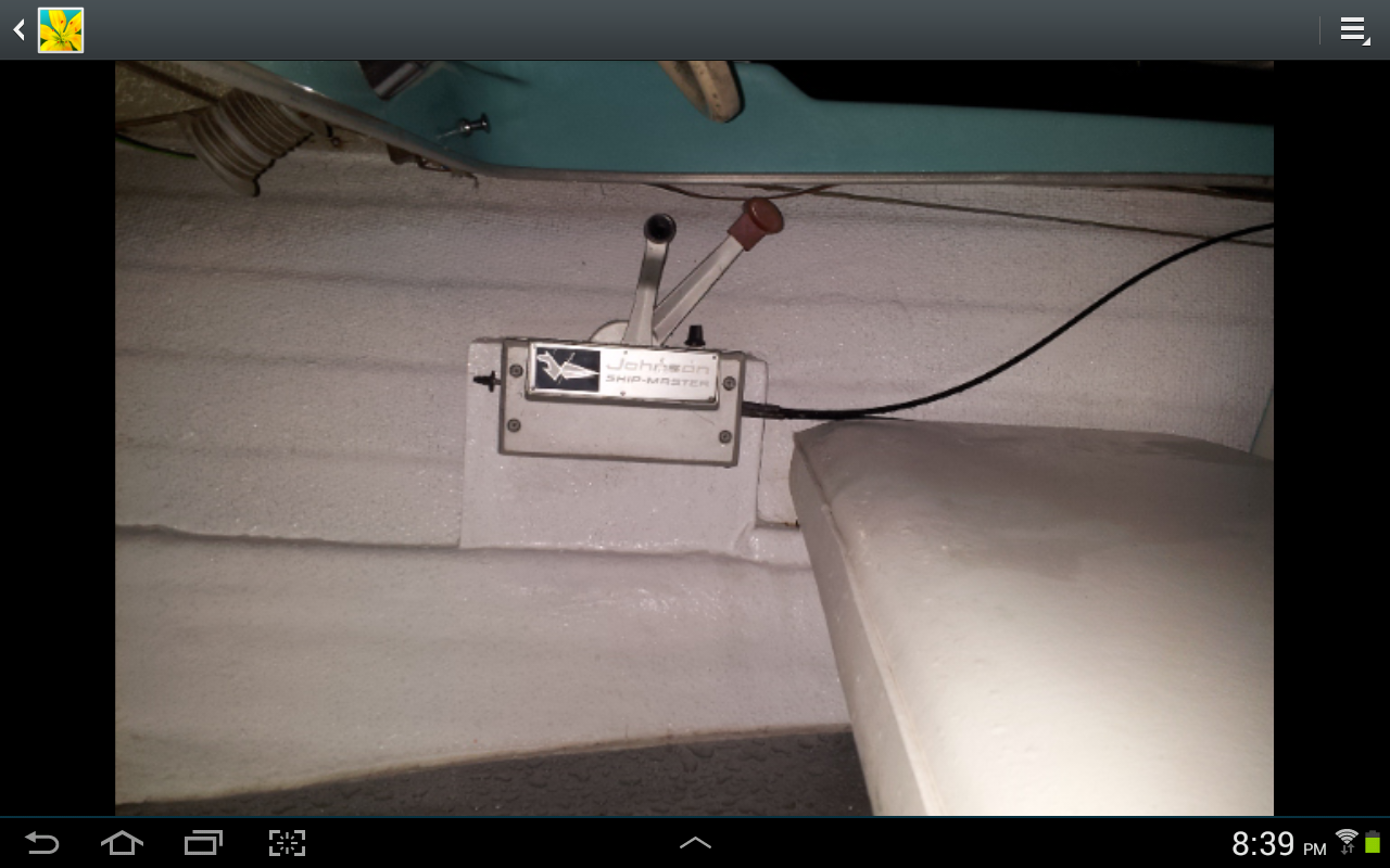

What position are the levers supposed to be in when starting the motor?
First time trying to start it and the starter motor is turning but not engaging. Wondering if I have a safety that is not right or something simple I need to do. I have a full shop manual on the way for the motor but its not here yet. Motor is 75hp sea king magneto. Sorry for the stupid question...Thank you
Re:Johnson Ship Master controls 12 years 1 month ago #100363
Stupid question? Not at all. The only stupid question is the one not asked. I believe the F/R (black) lever should be straight up in neutral. The throttle should be moved forward to its highest allowable position somewhere between 1/3 and 1/2 throttle.
