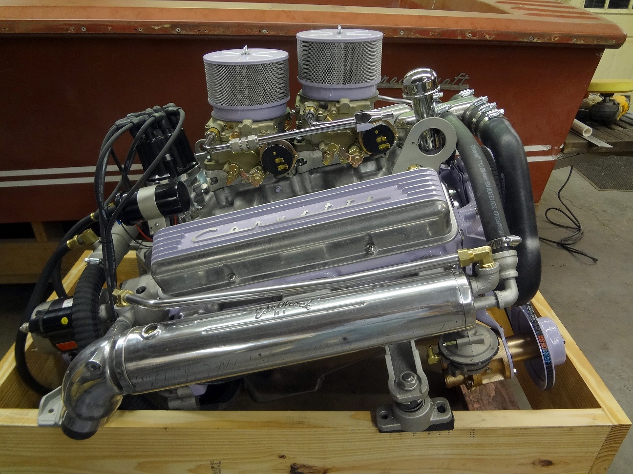

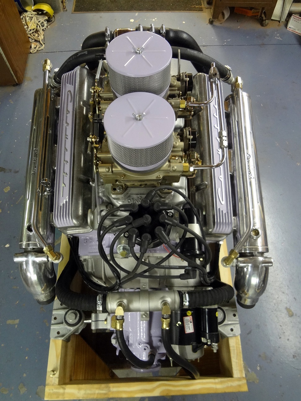

You may have seen this before but if so, you're seeing it again! We're doing another over-restore-resto-mod on a 1966 Correct Craft Barracuda. Inboard engines have many advantages over a stern drive configuration, not the least of which is accessibility. Here's my latest creation: (click photo to enlarge)
I started with a 1985 vintage Chevrolet 300HP reverse rotation marine long block with performance cam (painted 1955 Lincoln Wisteria), vintage Edelbrock dual quad intake, twin Edelbrock #1409 600 CFM carbs on 12-degree wedges, Velvet Drive 1:1 transmission, vintage Edelbrock M1 marine exhaust logs, Pertronix Flamethrower marine distributor and coil, Mercruiser 7.4L raw water pump, chrome 125 amp marine alternator, vintage Corvette valve covers and a lot of other little goodies. It ought to crank out about 340-350 HP with these mods. I predict this Barracuda is going to leave every modern Correct Craft on the lake in it's wake.
