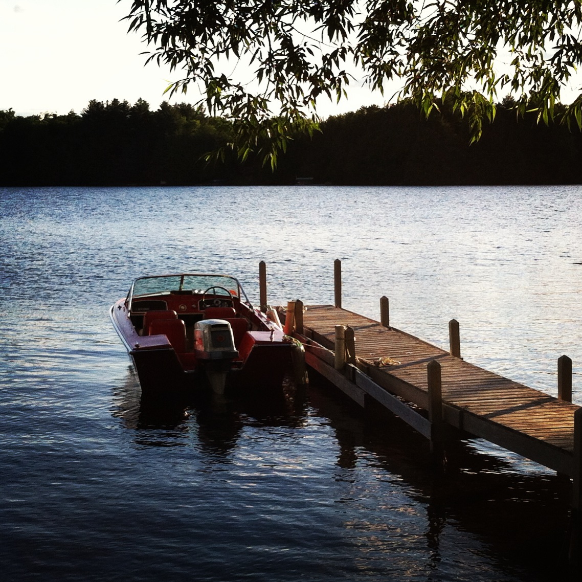

Hey Guys,
I have been working and restoring my 1967 Chrysler Charger 151 I purchased 3 years ago with a barn stored 1966 Homelite 55 HP outboard.
I have worked with Bill over the last 3 years and upgraded many parts including:
-Switching out with new mechanical fuel pump (from Bill)
-New blue water pump impeller - Water cooling motor great
-Rebuilt carburetors with new kits from bill
-red-did some of the wiring
-New in-line fuel filter and bypassed/removed glass bowl contraption
-New shift and steering cables
-Replaced all fuel lines and new water outlet line
I finally got the motor out on the lake last weekend at my family's cabin in the Adirondacks in Upstate NY, and I got all the way across the lake with the motor working great and all of a sudden "Thud". The motor would then not engage into forward or reverse. Motor would continue to turn on/off, run fine, continue cooling at tell tale, and even shift into gear and rev higher exiting exhaust but no drive.
I am thinking something snapped in the lower unit with the shift engage rod. Has anyone experienced in the past?
I am lucky enough that i recently acquired a motor with 2 lower units that seem in rebuilt or working condition. These seem to be from a slightly newer Homelite unit that has 1 water tube, where the water pump housing has 1 of the holes blocked with a stopper. I was curious if this would be interchangeable and if you think that is the cause of my motor to stop engaging into gear.
Any help is appreciated as I really don't want to give up on this motor. I am in the process of acquiring a rebuilt 85 Johnson 60 HP for the boat, and am thinking I may remove my Homelite and put on a stand until it is fully trustworthy. What do you guys think?
