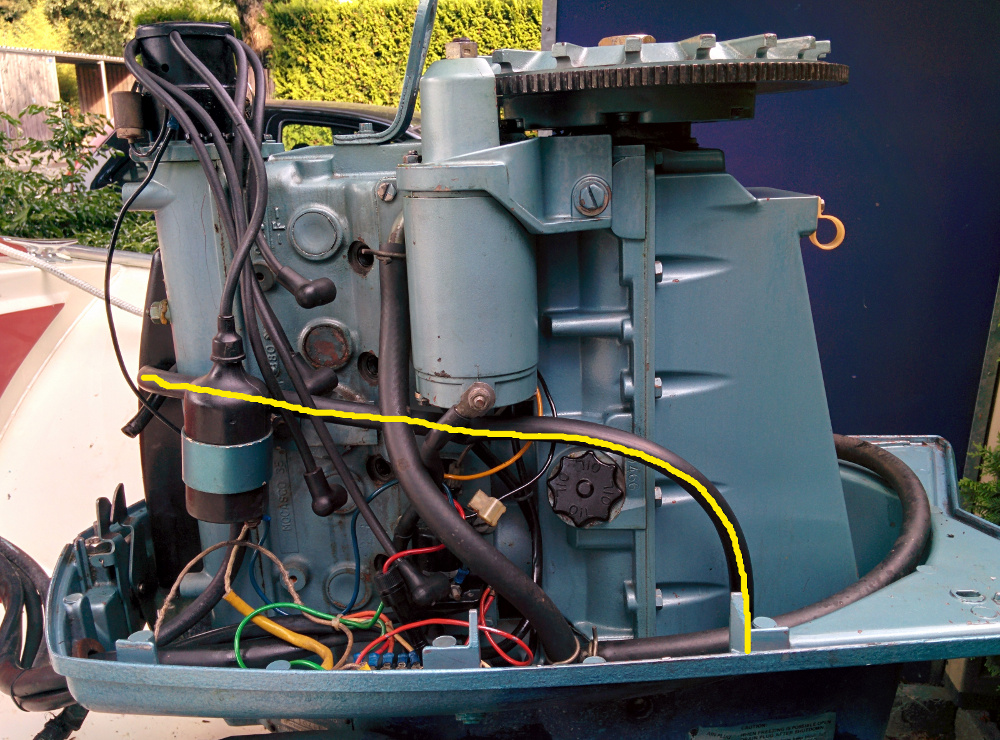

One more question: Can anyone explain to me what the hose which ist attached to the intake-silencer is for and to where it is running (picture attached)? Anyone else running with the silencer?

What is that weird hose for from which I posted a picture above for? I really have no clue and I have not seen it on any other pictures of bearcat engines.

pdomenig wrote:
Where I really need your knowledge and I'd really be grateful for a reply:
The hose is the crankcase breather, it should run up through the white plastic loop on the oil pan then back down to the hood pan, through a hole by the "V".

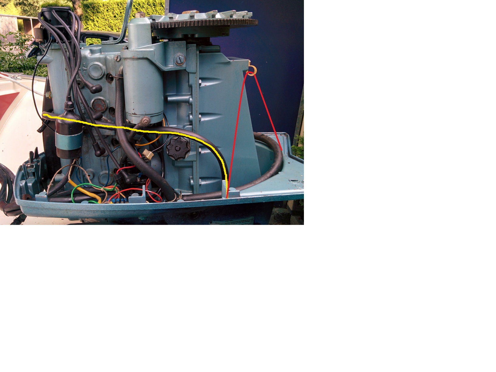

Re the breather hose Dick is spot on. That hose needs to be looped up through the white hose clamp and passed down to the hole near center of the V on the lower pan.
Will post a pic. Make sure the hose is clear, blow through it to check. It vents the crankcase via the oil sump to atmosphere and prevents oil puking out via the long run up to the clamp (gravity at work.

I wonder who had the idea of connecting th crankcase breather to the intake silencer. :ohmy:

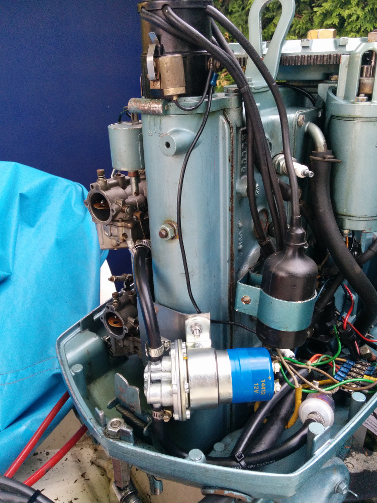

New fuel pump (Hardi 14412) is mounted:

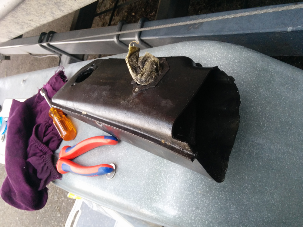

I think I just found the real reason for the sudden power-drop I experienced while driving at full throttle. The problem with the fuel pump and the fuel in the engine propably wasnt the reason for this (but still it is a problem):
I had put some oil/fuel absorbing towels in the engine in order to prevent anything from going into the water. Looks like one of these towels has been sucked in through the intake silencer and fully closed the lower carburetor.

I put the boat back into the water and the bearcat is running nicer then ever before!
I can really recommend the fuel pump. It is self regulating, meaning it turns off when the pressure is high enough. So when the ignition is turned on it clicks about five times and then stops. While the engine is running one can not hear the pump.

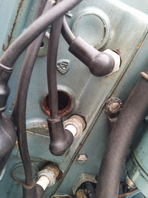

And here is my newest problem. Could anyone tell me what these openings are for? I was not able to find any information on that.
The did not happen while the engine was running. I just returned to the boat after a month of not using it and I saw this. I was thinking about freezing (even though we almost had no low temperatures), but there should be no water behind there, right?
Re:Fuel in Oil and low RPM with 1972 Bearcat 11 years 9 months ago #104510
Hi, that is a missing freeze / core plug and is in the water cooling jacket. Plug should still be in the bottom of cowl, may have frozen or just popped out. The large opening will dump all cooling water right there. Need to get it back in or get a new one if it wont stay in there.

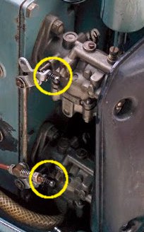

Idle RPM varies greatly depending on engine temperature.
Did you adjust your throttle link rod such that when both throttles are closed the link rod closes both of them? Then, did you open the throttle equally for a idle rpm of 750 or so, then optimize idle speed by adjusting the mixture screws? This will help stabilize idle, but yes there is some idle speed difference at 0 degrees C versus 25 degrees C outside temperature.

SPucky is right about the freeze plug, 1 1/8".

Thanks for the quick explenation of the "hole" or rather freeze plug in the engine. I have found the missing part just where you said it would be. I cleaned everything from oxidation. Then I reinserted the missing part with a simple hammer. On the first run this was no completly sealed and some water was leaking out. On the second run a few days later everything stayed dry. So I guess chalk or dirt sealed it again.

Throttle link rod adjusted? => Yes, they work in parallel and do fully close an open equally. I think the problem is that my mixture screw keep moving due to the vibration. The problem is not minor. I can set the idle rpm to 800, then go full throttle for 5 Minutes, this can (but will not always) result in an idle rpm of over 2000. Small changes have to be expected due to temperatures and so on, but I think this is a lot. Am I maybe using the wrong screws? Image attached.

Well I have just realized that maybe I have been adjusting the idle rpm wrong. There are "idle stop screws" and "idle mixture screws".
So far I have always been using the stop screws. I guess that is wrong. Is the procedure how to adjust these screw outlines somewhere? Do you first adjust the mixture screws and then the stop screws?
My problem seem to be the stop scews which don't stays where the are supposed to stay.
