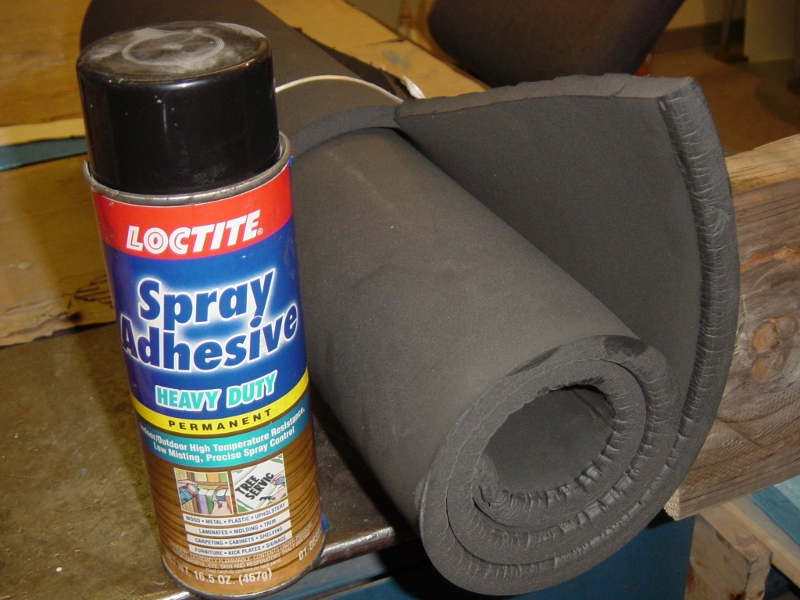

Tom: I found a sound deadening material at Foam Factory, Clinton, MI. www.foambymail.com/sound-barriers.html It is a 1/2" Neoprene Foam. It can be cut and shaped quite easily. Will not make a 90 degree corner, that has to be cut and shaped. I installed the material in a Bearcat wherever it could be easily placed. That is to say it doesn't cover 100%, more like 70% of the interior. It cut down on the noise by 20%. (That is a "by the ear" estimate only). Glued in with a Locktite spray glue. After two years it is still in place. Also fairly cheap at $32 for a 80" X 24" plus shipping.

They used foam, and sometimes on the latest models you would see foam/lead sheet/foam.
It was a joke in overall effectiveness. Look at an E model, with the sound deadening coating on the cam over/crank cover/pan. There's a service bulletin from Bearcat stating the E model sound deadening with the muffler caused more problems than it was worth.
Greg is right, use foam or the vinyl-backed foam which is what I use with either the spray adhesive or contact cement. I have used the vinyl-backed foam, glued the foam to the hood with the black vinyl facing the motor, has worked well.
I think the sound reduction is dramatic, in my experience.
