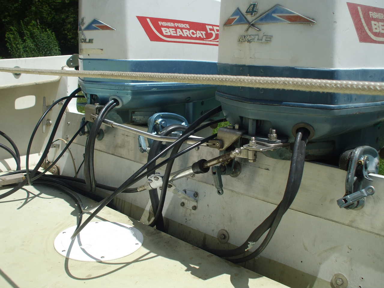

The '68 twins are mounted on a 19.6 Aquasport CC. I filled in the low spot in the center of the transom and raised the whole transom another 1", which put my cavitaion plates even with the bottom of the boat (on the inside edges of the cav plates). I bought a new old stock (I think) motor coupler from Bill R. which put the motors about 20" appart; had to make up a few stainless plates for each end of the coupler and one for the end of the teleflex cable - that stuff was all easy.
The hard part was trying to figure out why my port motor wouldnt pump water. I tried everything! Had the lower unit on and off 4 times, opened up the block panels to flush out the rust, took out the thermostat, flushed and checked everything with no results. Then in a conversation about it with Bill Roberts, he suggested I drill some holes in the shift linkage plate on the exhaust housing. I was reluctant to bother because I ran the motor in a barrel with the plate completely removed and it still didnt pump. Well, I drilled 8 1/8" holes in the plate and brought the boat down to the local pond. Didnt pump. Frustrated to the point of "Dont give a damn if I burn it up at this point", I ran the boat down the lake. A few minutes later, I looked back and the teltale looked like a firehose - and has pumped like crazy ever since. Why one motor needed that mod and the other didnt, I have no idea, and I dont care because they sound so cool! With 5 people in the boat, it'll run about 24 mph. I probably wont get 2 tachs intalled for this season but I'd like to get the boat up closer to 30, maybe with different props and a little fine tuning I'll get there, but either way, it's a lot of fun, and if I hadn't intalled a new sending unit and fuel gauge with the new tank I'd think that the gauge wasn't working - stuck on full. Thanks again to Bill for all the help.

There are probably 6 or 8 service bulletins on cooling.
I've seen Pauls case where needed relief holes in shift cover plate, have seen Dick's case where not required.
The basics are:
1. Clean out block yourself so you know it's clear, there is a big passage under the bottom cylinder above bottom of block, that MUST be totally clear.
2. New impeller
3. Restrictor in telltale hose (E model with Y telltale routing AND recirculating thermostat a special case here)
4. Water up to spray plate at minimum at rest not underway.
5. you should be able to blow back through telltale and see bubbles at water inlet plate above prop.
6. Ram tube at front of lower unit clear, if plugged you can have cavitation and also suck exhaust gasses into water pump inlet. (Melts impeller, I once did this while tuning an 85 in a barrel, sucked the exhaust gas right into impeller and roasted it in short order.)
All those items true, you should be good for idle cooling flow, and good flow at all speeds above.
Over winter I hope to scan the bulletins and get them to Andy for upload to Fiberglassics, along with a bunch of other items you will all enjoy.
PS: posted this in haste between jobs, there are other subtleties etc but the above should be a good start, see bulletin attached

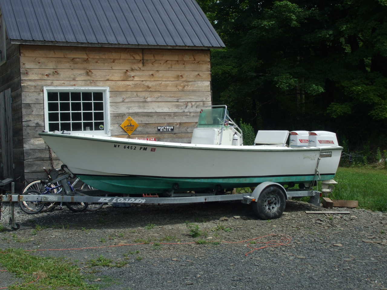

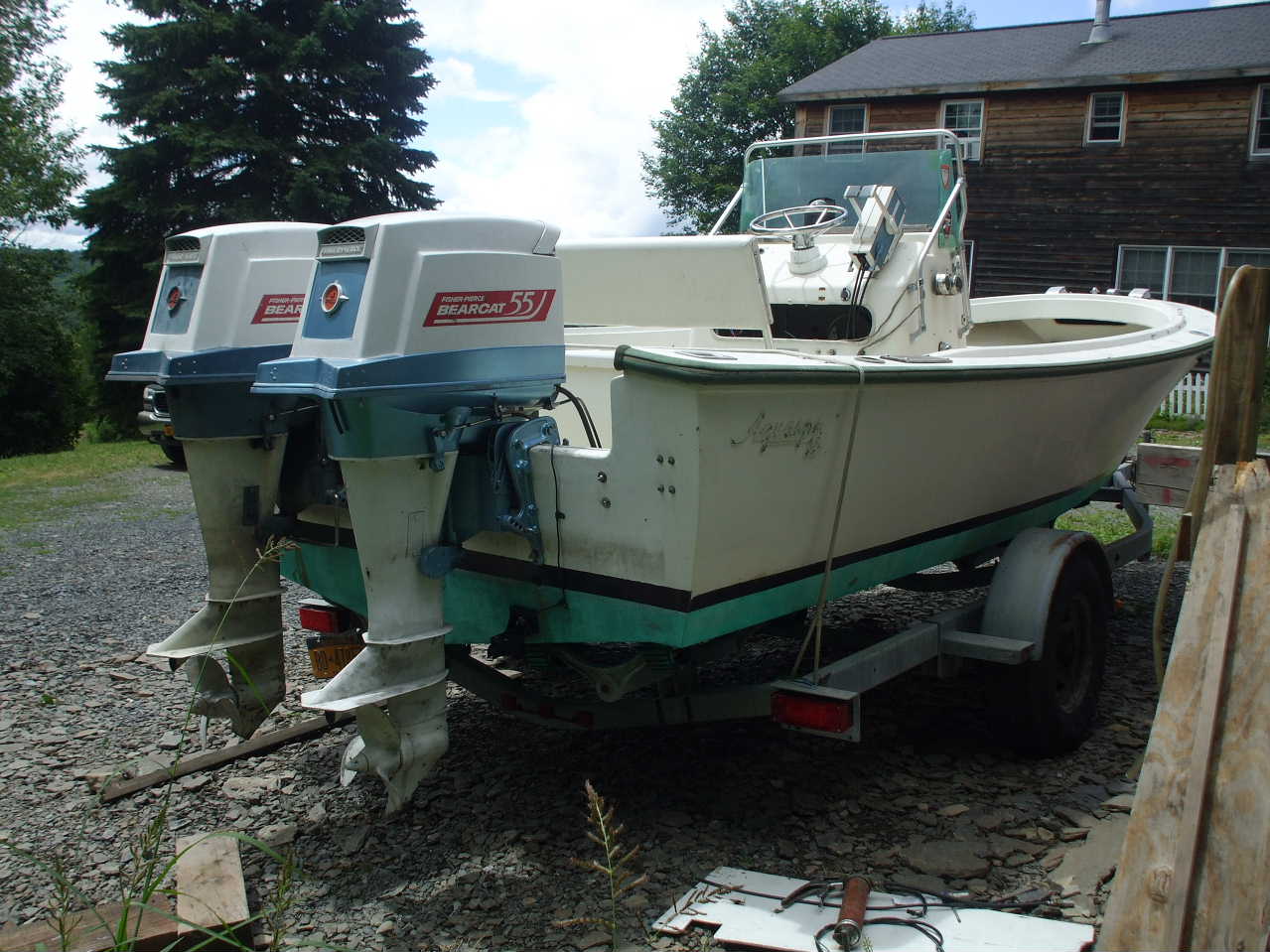

Re:Video twin Bearcat 55 outboards, Lake Ontario 13 years 1 month ago #83221
Here's a shot of the whole boat.
Re:Video twin Bearcat 55 outboards, Lake Ontario 13 years 1 month ago #83274
  • billr
  • billr's Avatar Topic Author
  • Posts: 623
  • Karma: 51
Paul is new, had some trouble with pics so I posted the pics he sent in his post above.
Nice looking classic Aquasport! Shallower deadrise aft than I expected. Looks like a useful boat with lots of space. Space not taken by a zillion gallons of fuel to make it back to the dock :)
