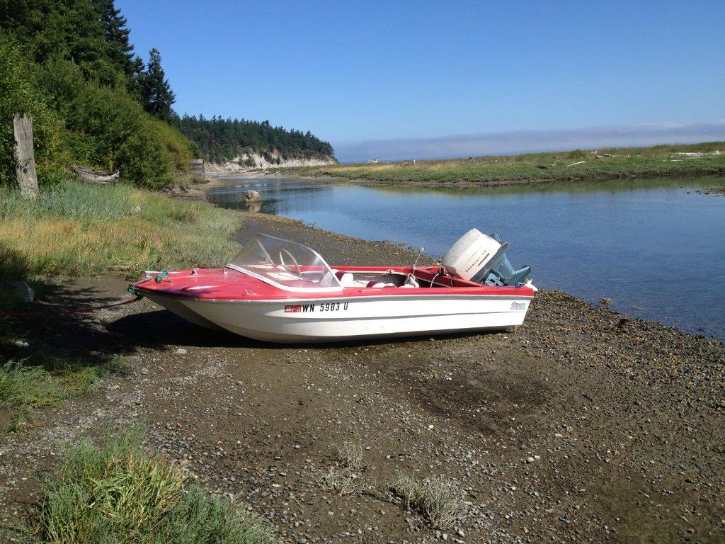

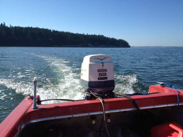

Finally got some time to play.
I launched my 1961 Power Cat 14T with short shaft Bearcat 55 yesterday.
She ran fine, I put a new 14 pitch prop on her and haven't yet done a wide open throttle run to see if pitched correctly.
Was pleased that the little hull floats the portly 55 just fine on the 15" transom. This is the $200.00 Power Cat/trailer that I bought in 2009, sold it, bought it back for $200.00. Donated the DR Merc 800 to Doc Frankenmerc and installed the B55.
Ran her around on a single 6 gallon tank for a couple hours, still have half a tank left. Of course! Even took good ol' mom for a ride, she liked not seeing or smelling any smoke. Probably the biggest surprise was the noise, it wasn't as bad as I thought. I don't have any sound insulation in the hood yet, that's coming.

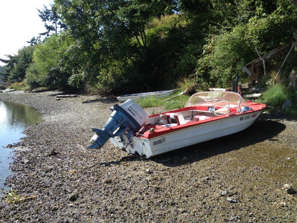

It's nice running a boat that turns almost flat, hardly any banking in a turn. I have her across the street from me in the water, well on the gravel at low tide. Will be taking her out whenever tide allows to get some time on her and will report back.

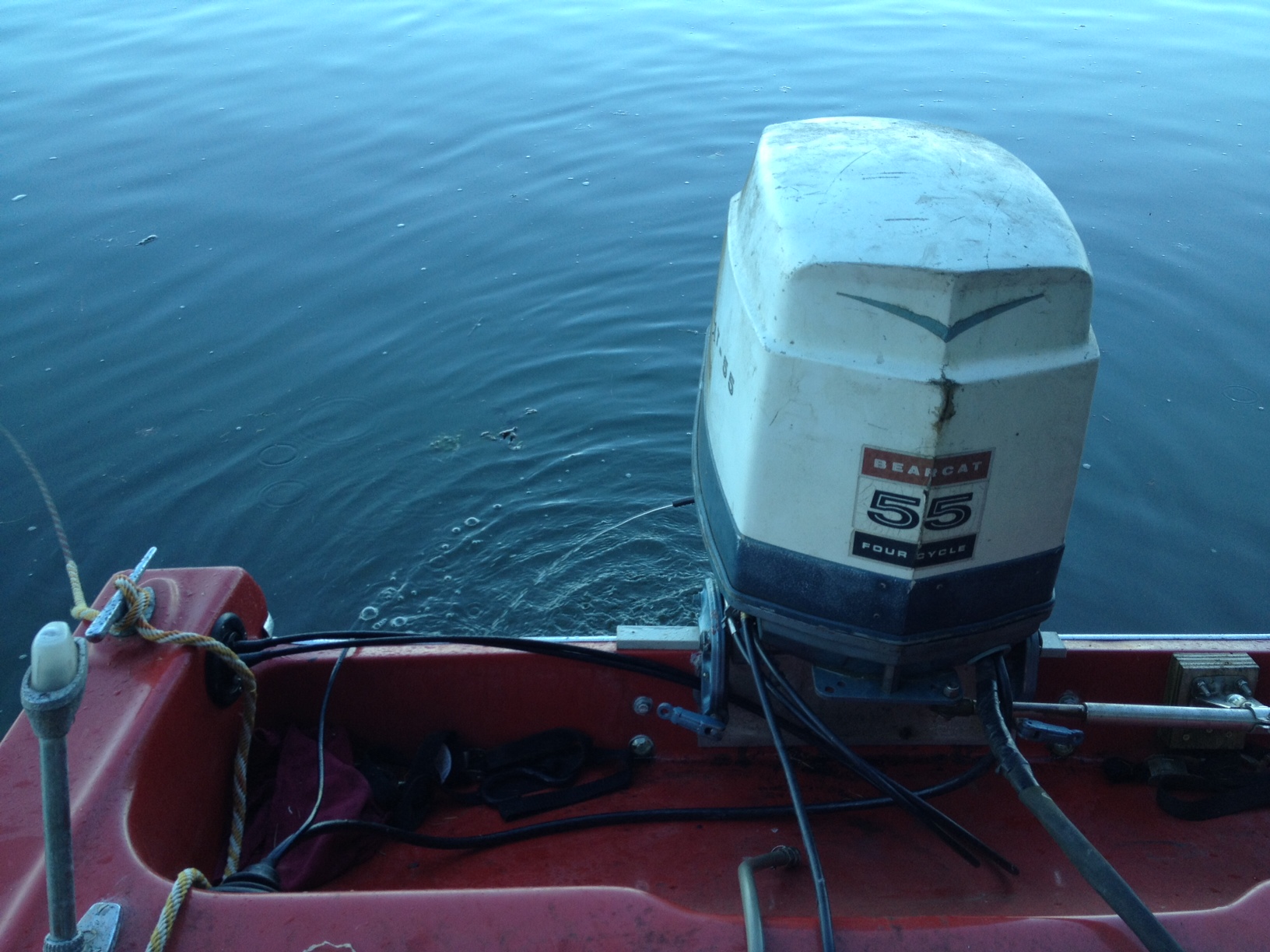

The site is having an issue so later will post a pic of a telltale stream at idle using one of my impellers and having cleaned out the block water jackets. I'm getting several calls a week re low water flow, overheating etc. Hopefully this pic show's the target we should all shoot for telltale-wise.
