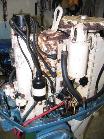

Hi, I am a newbie to this site and an AOMCI member who has recently acquired a Bearcat 55. It had been sitting quite a while and was a huge mouse nest under the cowl that caused rust on the upper block and flywheel. The serial makes it a 69, but is has an "A" block (don't know if that is original?). It was slightly stuck (couldn't hand turn flywheel) but freed up easily. Put oil in cylinders, cleaned up the points, changed the oil and hand cranked oil up to the sender, filled the block with water, removed the carbs and cleaned them up. Started it on 24 to 1 mix from a pressure tank i use on old OMC;s. Think the impeller is gone as water I pour down the line to keep it wet runs out of the lower immediately. Seems to run very well, on a stand anyway. Did a compression test after a few min of off and on running, got 190 psi on all 4? It has 40 lb of oil pressure at idle, and is fairly loud mechanically. More noise at the crankcase than the cam cover. I cant feel any mechanical slop in the rotating assembly by rocking the flywheel. The upper shift link is off at the upper end so the leg / power head has to come apart. The lower had about a table spoon of water then a cup of oil in it, feels OK.
It will need:
impeller for sure
Starter drive as it only catches 1 out of four tries.
Gaskets and seals to remove power head.
Seal kit for lower.
Question is, are these available?
Is the crankcase sound typical for these?
Does anyone know what a Colombian S7V prop is?

Hi Spuckey,
Welcome to the world of Bearcat/Homelite's. BillR has the parts you'll need and I'm sure he will jump in here. I listened to your video, engine sounds great. Not quite sure what you're doing to get water to the pump, you should be running it with a flush attachment or running it in a barrel. Greg Anderson shows a simple flush attachment in this thread near the bottom: www.fiberglassics.com/fiberglassics-forums/home/homelite-bearcat-4-cycle-outboards/bottom-end-is-together#59797
You bring up an interesting point about the starter drive. All of mine do that. Seems when properly tuned they work fine but they will give me some trouble on occasion. More of an annoyance than anything.
