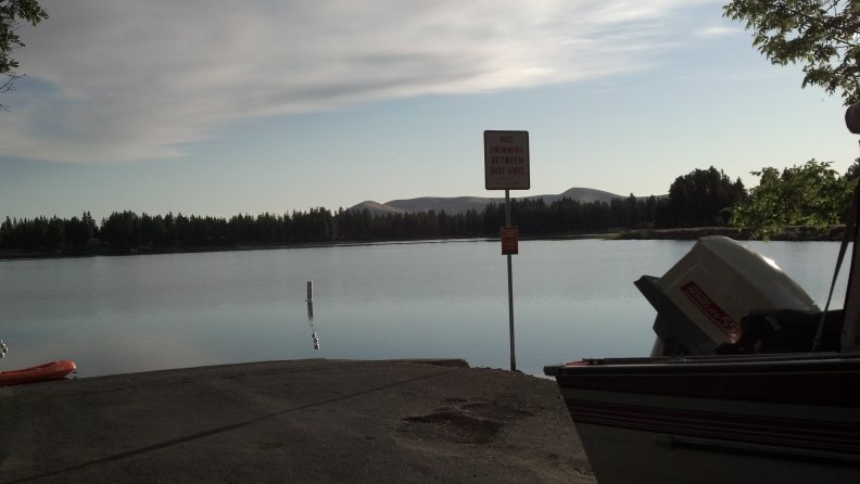

After what seemed like nothing but problems with the engines so far this year I now have a winner. We took it out yesterday to a lake on Mt Hood that I had never fished before, my now retired co-worker had been telling me the trout fishing was great and there never more that 4 other boats fishing. We arrived at 7:00am, fired off the Homelite, put it in gear and trolled for 7hrs at 500rpm, 1.5 to 1.75 mph. I did not touch the throttle once and it ran better than it had ever run, perfect to be exact, not one hicup. Pee'd water from the tell tale the whole time at this speed which it hadn't done in the past. Paul my co-worker was totally impressed that you could have an engine that size and not need a kicker. Fishing was slow till we figured out the depth and got our limit.
Last week after going then coming right back from fishing, unable to use the boat because of the overheat problem my wife suggested buying a new engine. I said no there is no reason for that, just some bugs to work out and this one will be fine. I couldn't be happier with how it runs now!! :)
