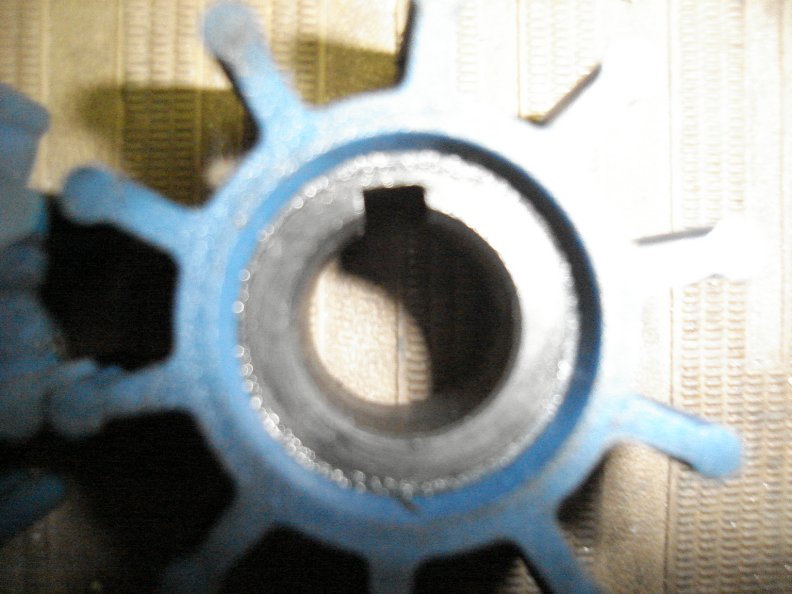

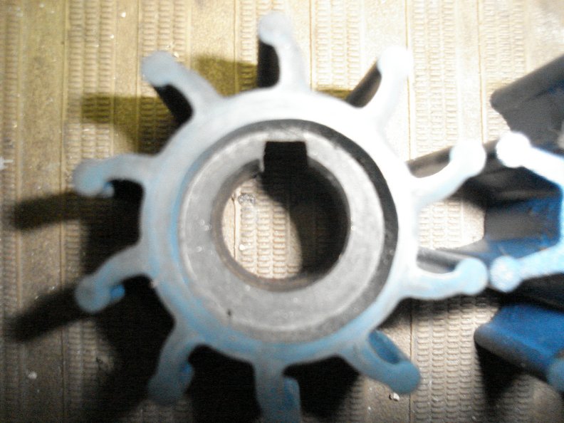

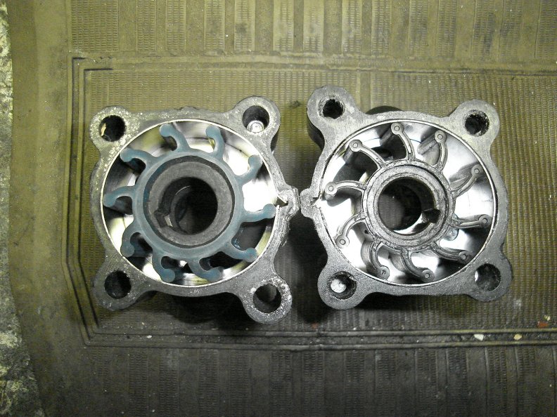

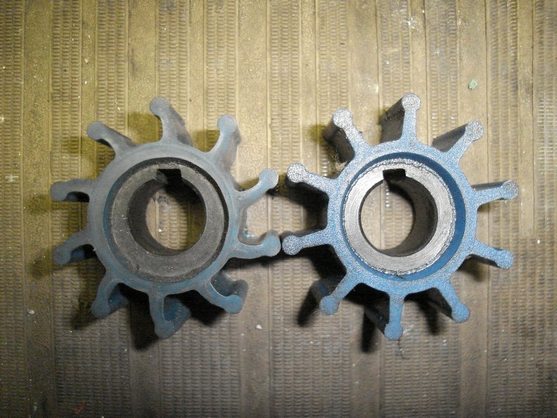

Well I took mine out this morning, got on the lake about 6:00am and was planning to be off around 10:00am. No deal still not pumping! :angry: Brought is back home and removed water pump again. Everything looked fine except I'm not impressed with those Globe blue impellers, they are a tad bit bigger, looks like less spsce for water in the housing. Took the damn thing out and put in an original black one, bought me a barrel and cut it down to fit under the leg. Fired it off, hell it pumps better than it ever has. Never had a pee stream at idle (500rpm) with this engine and that duel pipe water pump before, it does now. Maybe next weekend????? :P

The new impeller I put in was blue. Got 3/4 around the lake when the horn went off. Pulled lower. Impeller was destroying itself.
Did I install it wrong? So I robbed the impeller and housing from the old Homelite. Key to skinny. Found a better one so now we are pumping. So far so good. I have an infrared thermometer I shot it at the power head and she read 120 to 130 degrees

Well since two of us are having the same problem I don't think you are doing anything wrong and we both resolved the problem the same way. Notice how much thicker the blue one is compared to the OEM black. Seems like it's taking up water space and the volume it delivers is less. Am I wrong? Notice the two blue ones I have together, the driveshaft hole in the one I was using isn't even centered. The other one is new just out of the package and it seems to be centered. Quality control problem? Your temp readings are what I am getting too and yes the tell tale is most likely plugging up with scale. I had a wire in the boat with me and when I noticed the lack of flow I cleaned out the tell tale and it would pee fine. I'm too becoming an expert at putting the two tube water pump lower unit on! :S

I'm lucky. My 1970 Bearcat has the single water tube.
I have a hard enough time with that and the drive shaft let alone another water tube!
Mine was wearing on one side. Maybe I got one of those out of round center impellers too! :(
My other two are the single tube, yes much easier. I can stab the driveline into the engine damn near first time in.
Check that impeller, see if the hole is centered and let me know.
