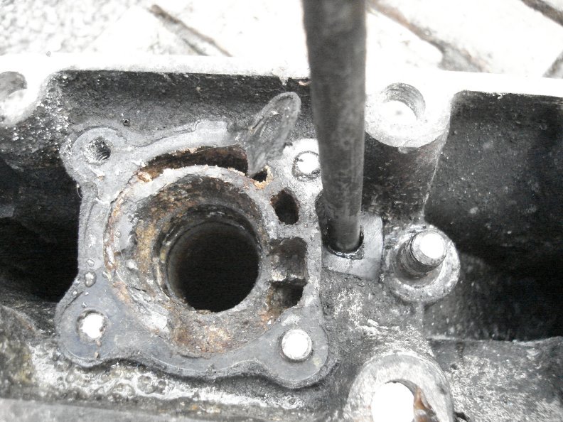

Had to take the lower unit of and change the gear head on a long leg the shift rod has a bunch of bends in it. So had to unscrew it and let it stay in the uper part. Get it all togather and its so tight I can move it by hand. So what did I do wrong?

The same thing happened to me when I dropped the lower unit to paint it. There could be two things wrong. The shifter passes thru a rubber holder. That could be binding it or the shifter could not be positioned properly. Also there is an o-ring seal from the gear case to the impellor housing and if it's not seated properly, it will bind. A good place to start is when you have the lower unit completely out. Move the shifter up and down and see how that works. I bolted the impellor housing on the lower unit first, the to the leg. Try that. Doesn't sound like a real problem. Yes the shifter should move very freely.

Pathfinderz, correction. The impellor housing is held on to the gear housing by two nuts. The six allen head bolts are for the impellor housing to the leg. Anyway, you get the idea. If you have a soft jawed vice, you can clamp the fin in the vice and slip the housing and actually see what's going on. Then turn the drive shaft and shifter while in the vice. Move the shifter up and down and see what's up. If it's OK, it may be the sfifting rod in the motor pan.

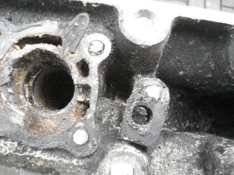

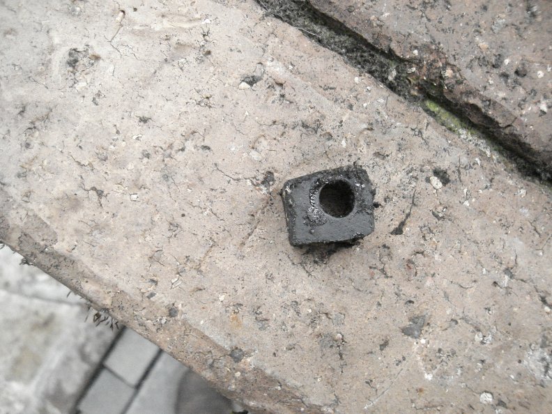

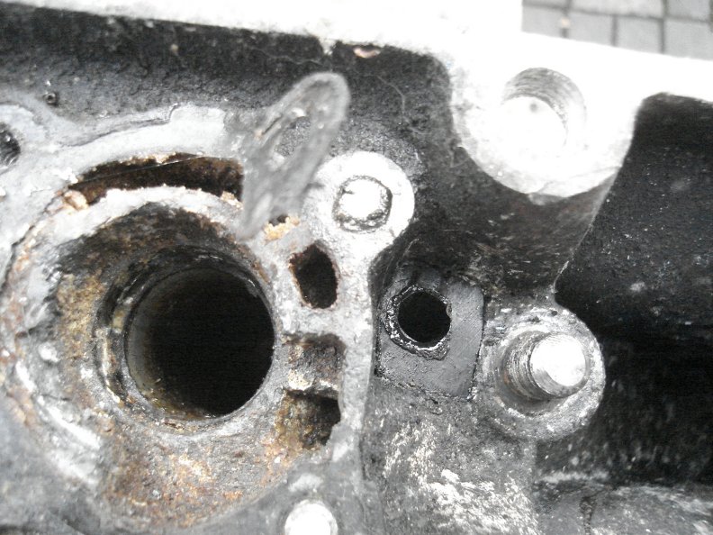

So the only problem you now have is the shift rod, as you threaded it into the connector (which you could see because you pulled the output bearing housing which is behind the prop) it screwed in tight. You screwed it in while the shift rod was still in the upper housing, sounds like it's cross threaded. I've always been able to remove the rod through the upper housing while it's still attached to the gearcase, long or shortshaft. There may be a rubber plug with a hole the rod passes through that needs to be removed from the upper housing.

Ok I took it all apart and checked the rod and seal could not find anything wrong so put it back togather and it works. Put it back on the motor and it shifts and punps thata all that counts.
