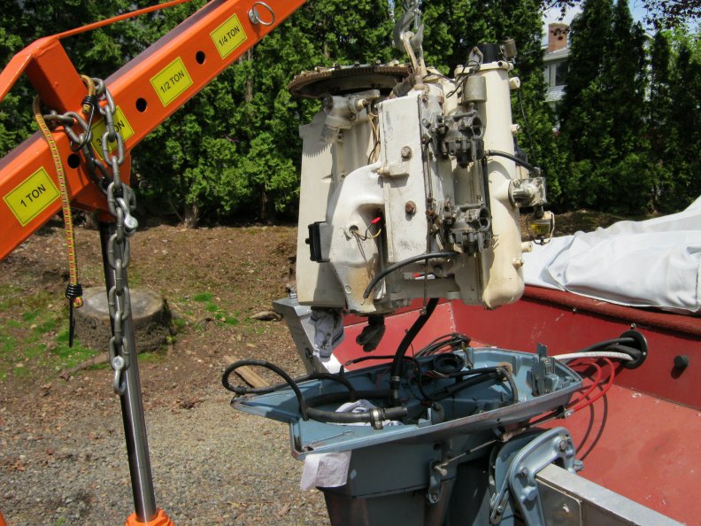

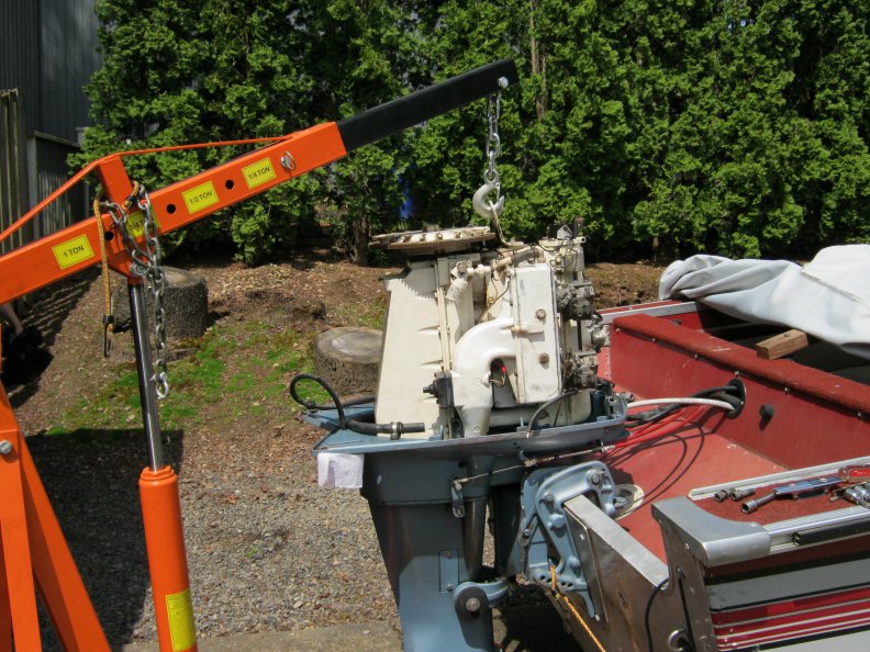

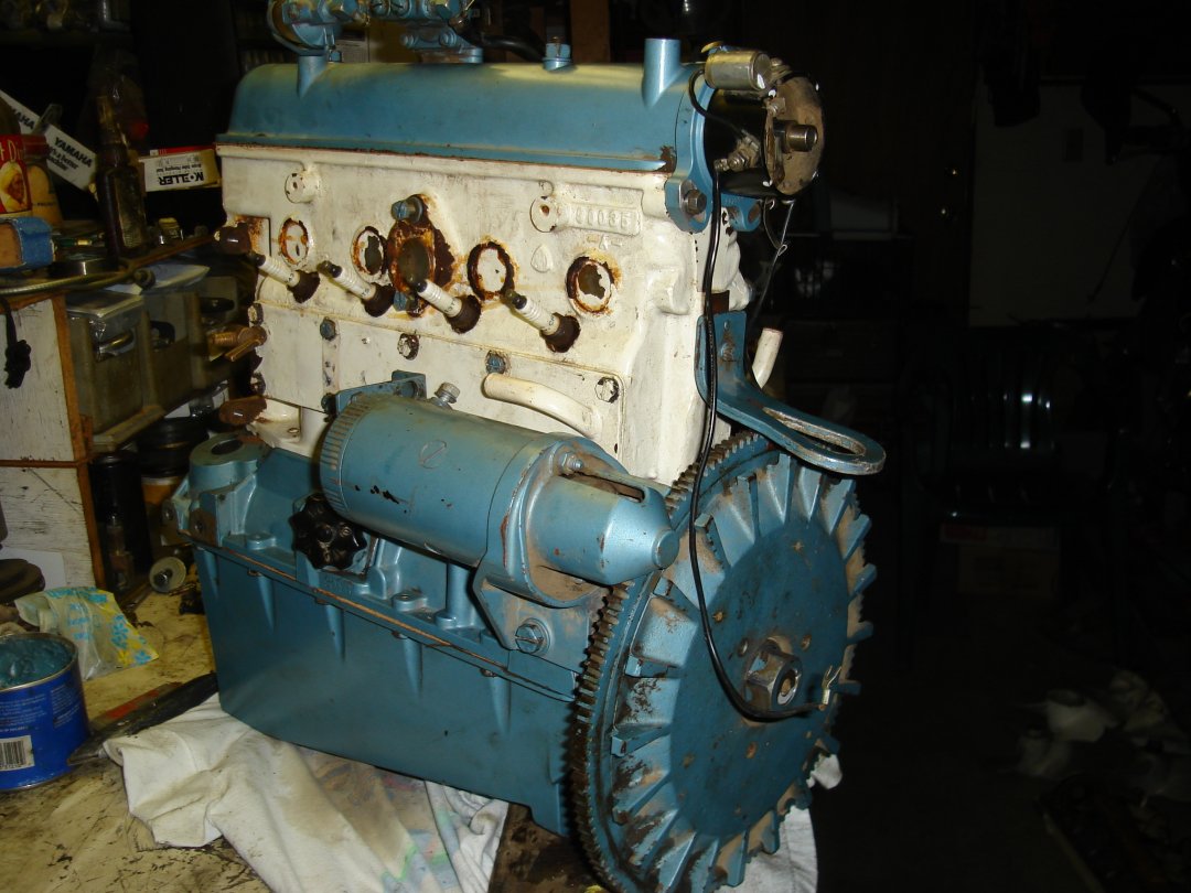

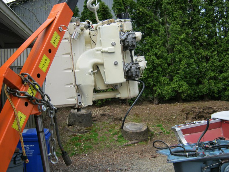

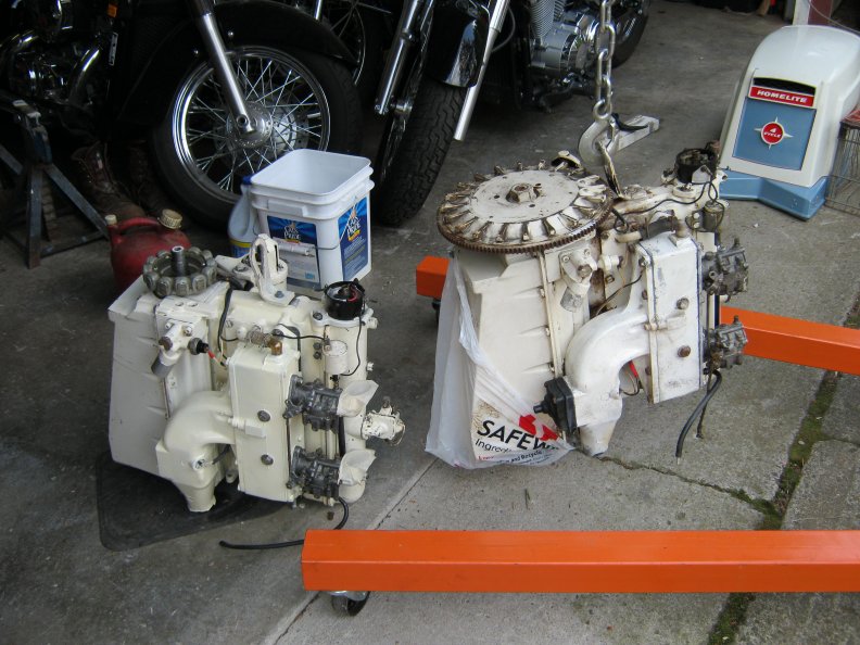

I pulled the existing good running powerhead today and replaced it with the newly freshened one. It runs great, good oil pressure and it's no longer a mixture of blue and white engines.
This is what it looked like on the first go around
Removal of the existing powerhead
It's out!
Replacement is on the left and is now all one color.
Up in the air ready to drop in place.
Here it is idling at 600 rpm and holding 35psi of oil pressure.

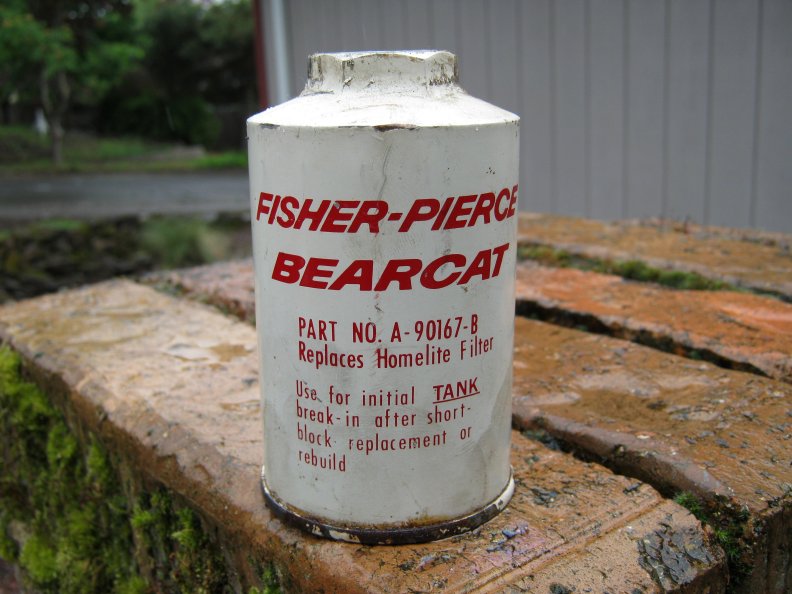

I forgot to ask you, it looks like you don't have an oil filter, either. Isn't it necessary?
Re:It's alive again 14 years 5 months ago #61627
  • 4stroke
  • 4stroke's Avatar Topic Author
  • Posts: 291
  • Karma: 16
Depends on what you read and believe about these. Homelite had them, when Dick Fisher bought them he deleted them saying there is "no dust on the water". I personally would run one and there is one on it now.

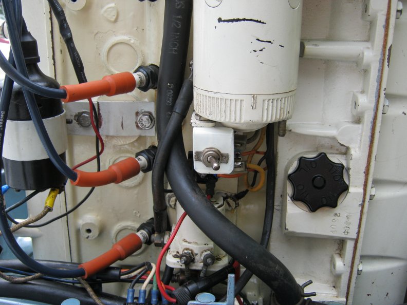

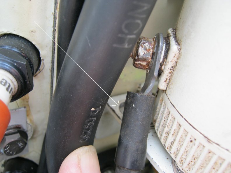

One of the last modifications to do was to move the Hi/Lo alternator switch to a more accessible location. Kind of a pain to get to in what I'm assuming is the original location. Since I do a lot of trolling with this with the fishfinder/GPS and radio on I want to make sure the battery stays charged. Have had to rope start it couple times and to my amazement they start very easy with a rope! Just remember to wrap the rope to turn in the CCW direction. With this in the "Hi" position you can really hear it working.
The arrow is pointing to the original location.
This is the new bracket and location, much easier to access now.
