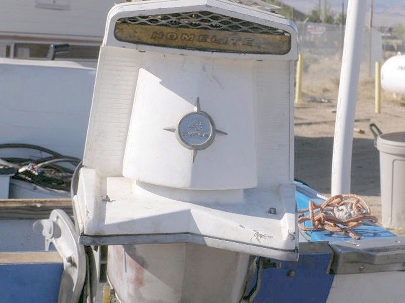

Here is what I have. The last image is when I first brought my Homelite home. I took off that red bracket and added the mesh screen that was missing.
Re:Need pix of homelite hoods 14 years 5 months ago #60045
From what I can see Im missing the Homelite emblems on the sides. The screen on my front has a gold emblem saying Homelite.
Mike aka the pirate

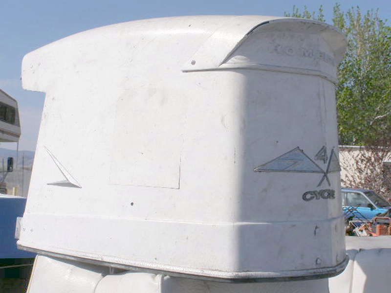

Ok here are some pix of my hood. Doesn't look like it in to bad of shape I can see I'm missing emblems saying homelite on the sides and if anybody can tell if I'm mising anything else let me know
Mike aka the pirate
Re:Need pix of homelite hoods 14 years 5 months ago #60139
Is the top lip chrome under the white paint?
Re:Need pix of homelite hoods 14 years 5 months ago #60173
No it plastic.

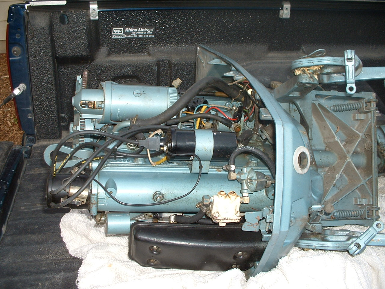

I'm glad you have a photo of the engine. I've been wanting to ask this question for months. My '66 Bearcat does not have the carb air cleaner. It just has the little ram air duct, like the manual shows. Is it really better to have an air cleaner?
Re:Need pix of homelite hoods 14 years 5 months ago #60197
CraigLam,
That black piece has no filter in it. I think it is some sort of silencer for the carbs. Plus helps keeps any debris from getting into the carb throats. My 62 has those like you have on your 66. This is a photo of my 62 when I first picked it up. My 70 was much cleaner when I picked it up.

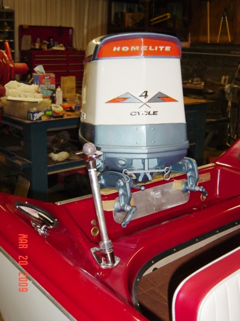

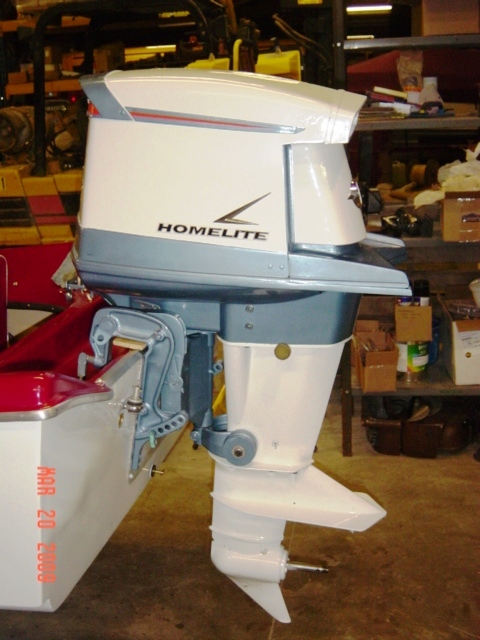

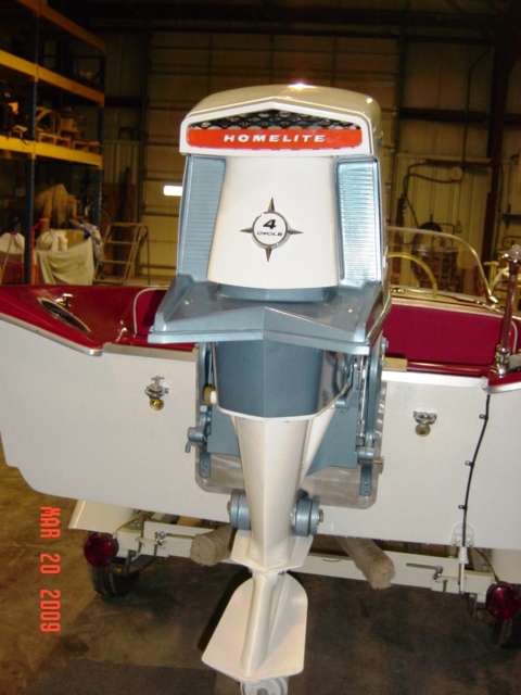

Here are a few pictures of Mr. George Jetson.
The only liberties taken from original are the the 3" wide "cap" that goes over the front top orange with white lettered Homelite emblem should be white or chrome, not the Homelite blue. Otherwise the colurs should be fairly close.
